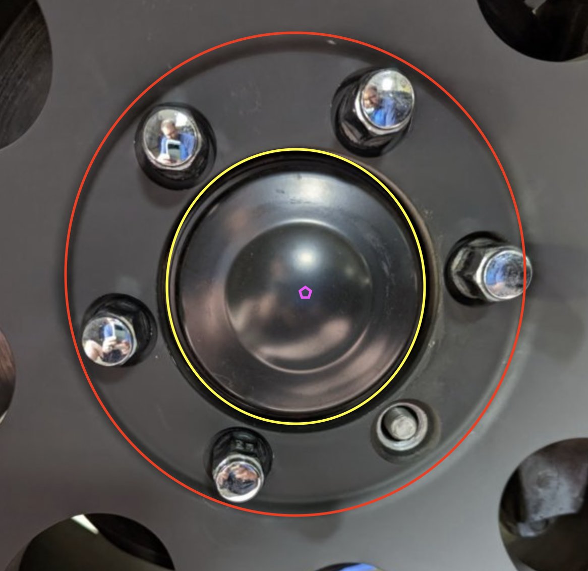

    I would assume that on a non-defective wheel, the circle formed by the bolt pattern and the circle formed by the hub should have the exact center point.
    using your image, the purple start should be the center for both yellow circle and red circle.
    If not, the wheel shouldn't even be able to balanced at all.

    Could that be skewed by camera angle?

    yeah, it looks not centered due to angle in the image, but I was just drawing for illustrating purpose

    Correct...here's a link to that thread.
    https://www.tacomaworld.com/threads...-issue-trouble-shooting.771762/#post-27576278
    See post #17 for what happens when the centers do not coincide and you have a lugcentric wheel with a fitted bore.
