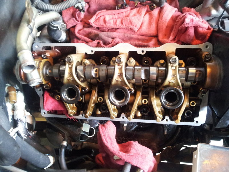

    '95 Isuzu Rodeo 3.2 cyl head - 300,000 miles - OCI - 3K for about first 200K; then 4K-5K OCI for the last 100K. Conventional oil 5W-30 - mostly Castrol for the first 200K; then whatever, including cheapo Walmart SuperTech. Oil filters...dealer for the first 150K; then a mixed bag for the last 150K and yes...the dreaded Fram used a number of times in the last 100K.
    I could be wrong, but my money is on a really outrageous OCI - maybe way worse than any OCI interval suggested so far.Rodeo Passenger Side.jpg

    I've also had success with adding a quart of atf and running it for a few hundred miles and changing it out. Also that Isuzu engine looks good! Nice job. I would think brake cleaner and a brush to clean those valve covers up.

    I did that to the inside of the valve cover before reassembly and did as much as I could inside the cyl. head area with brake cleaner and rag. On that engine, the whole top has to come off to get the passenger side valve cover off. Great design.
