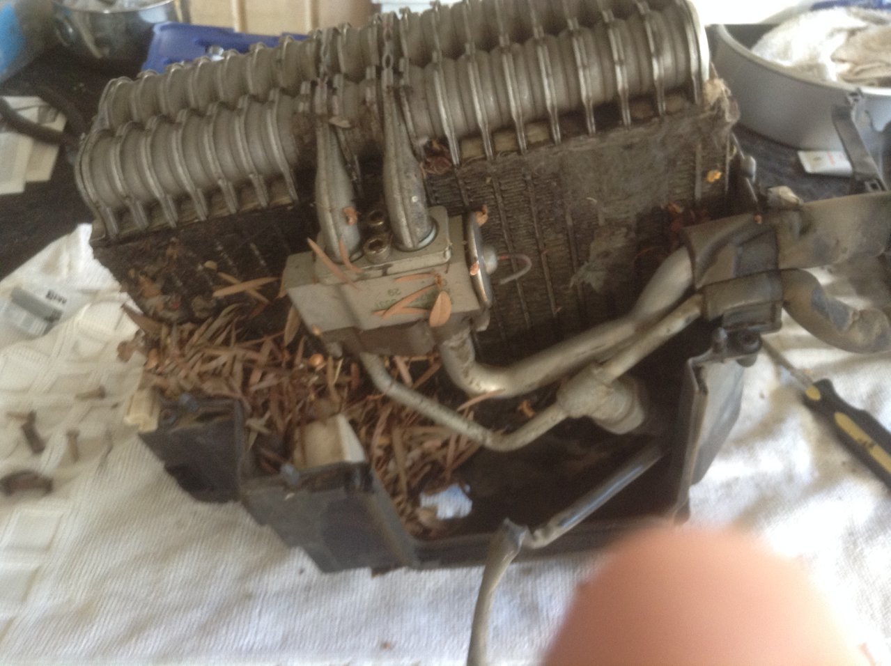

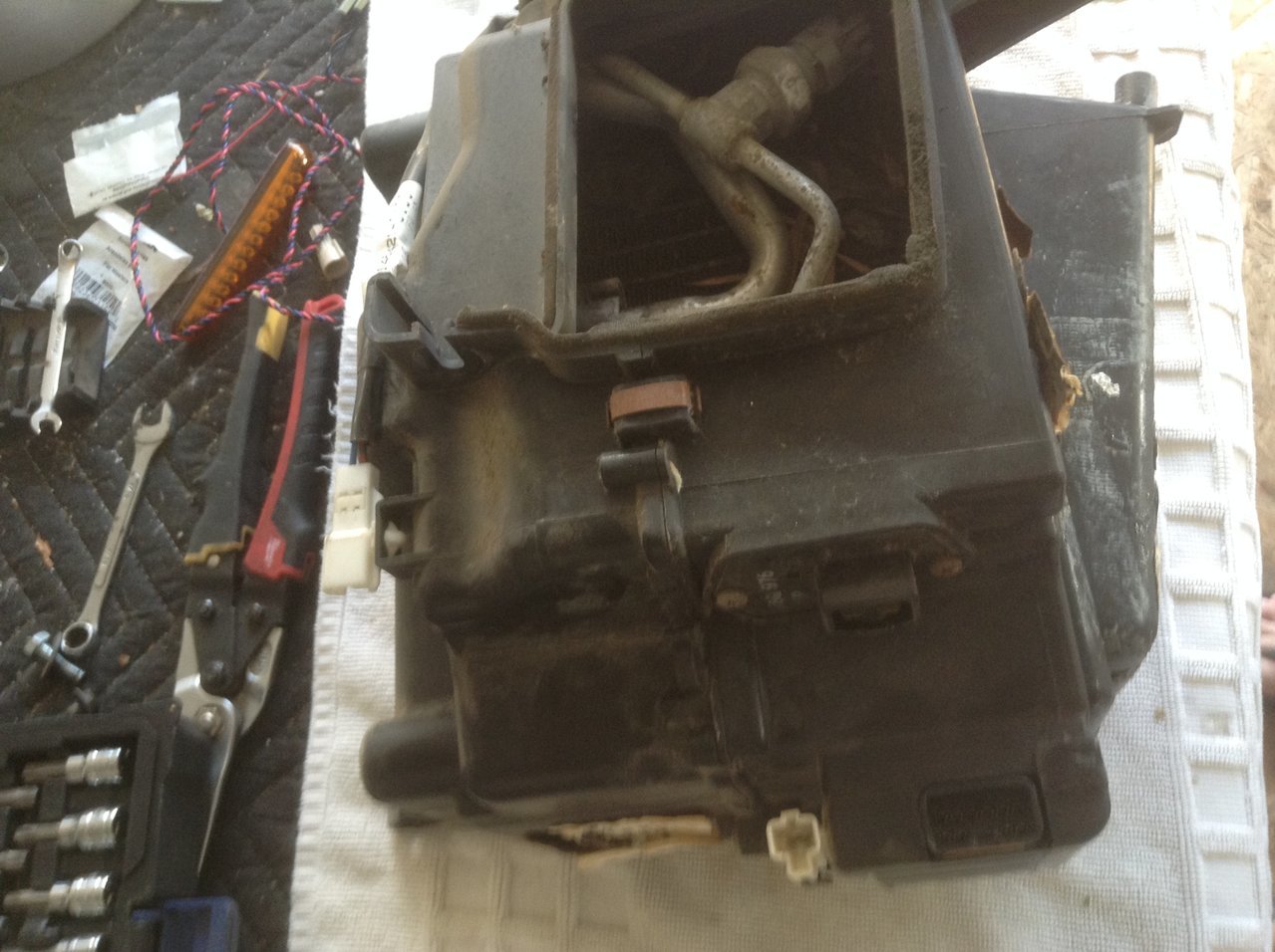

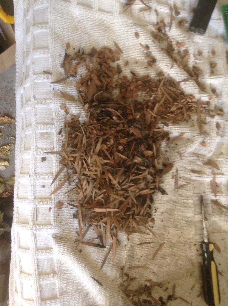

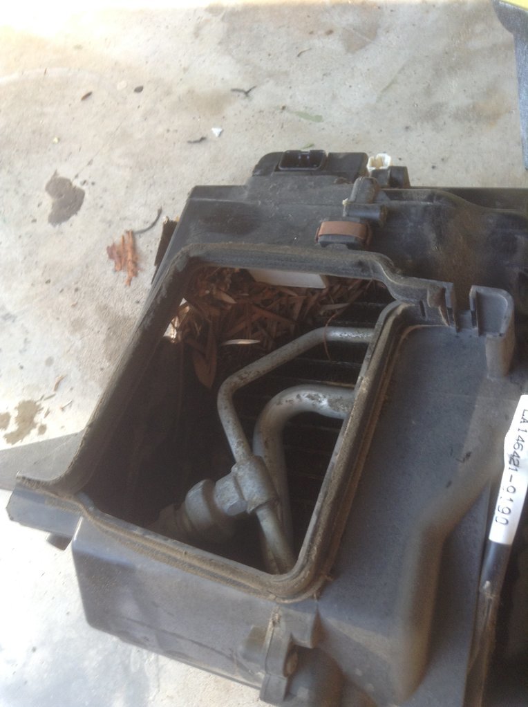

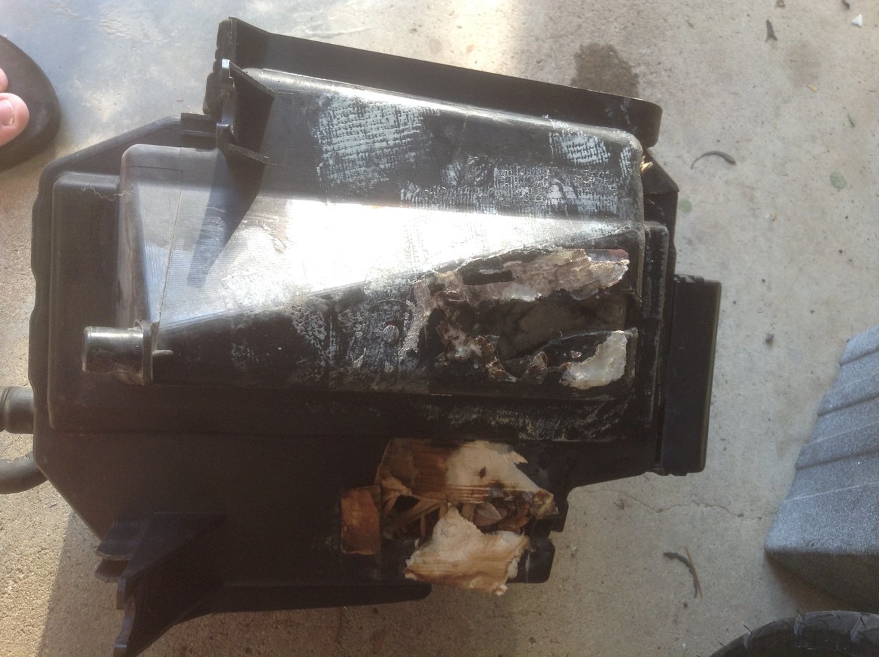

    evap drain was continually being blocked...

    nope. The previous owner obviously parked under a willow tree and all of the little leaves that fell into the grill in front of the windshield got blown into the evap case every time the recirc door was cycled when the AC was turned on.
    It was a very easy job.
