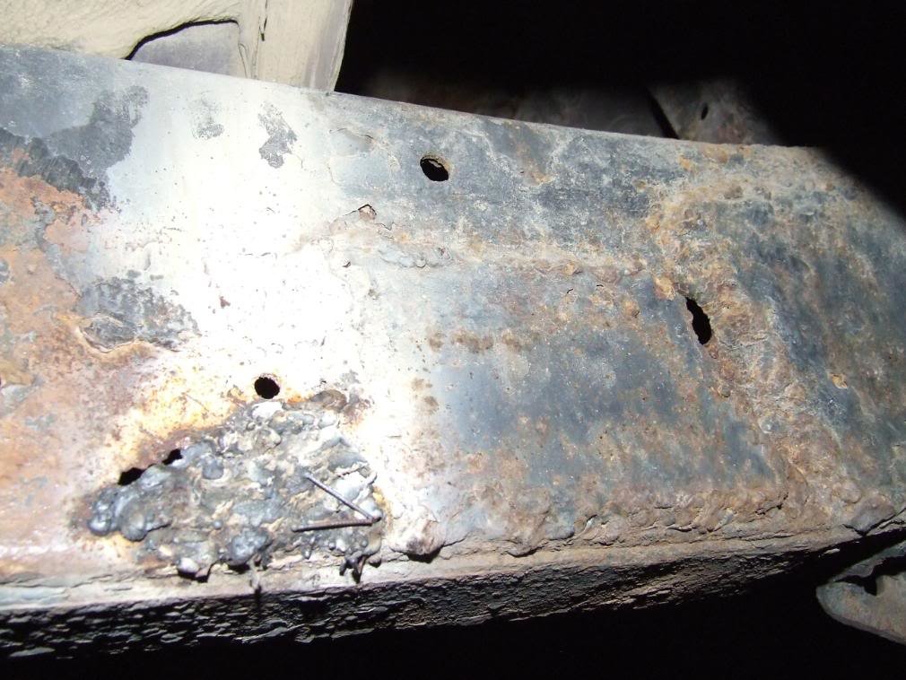

    No, the frame gets thin real quick. It attacks it from the inside and you can't get in there effectively to do anything about it. I had to patch my frame three years in a row to pass inspection. This last time was when they offered the buyback and I took it. My crossmember above the spare was starting to go.

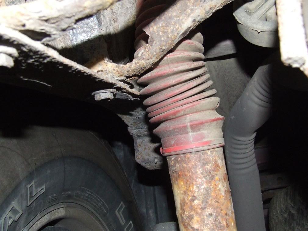

    This area is an entire plate welded over a hole

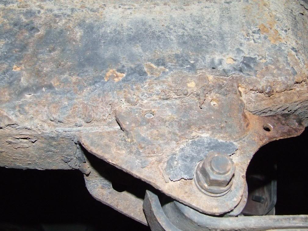

    The other side. Two plates there

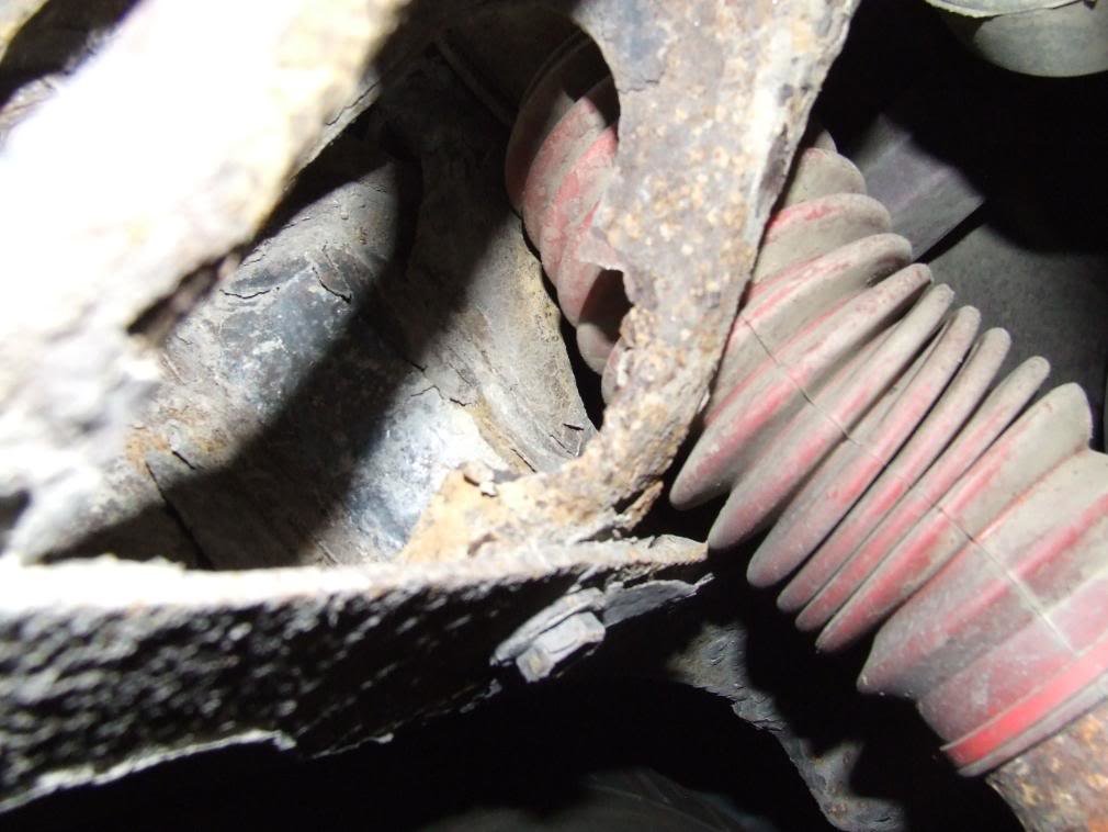

    Cross member

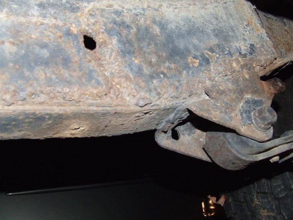

    More holes

    OMG, that looks horrible!!! I'd rather get a check for something like that and let Toyo part it out or whatever with it as long as the good parts are reused.

    That rust looks like a pic from the Titanic! That's pretty crazy. Anyhow, Toyota probably figures its cheaper to crush all of the defective trucks versus risk a possible lawsuit in case a "repaired" Taco got in a wreck.

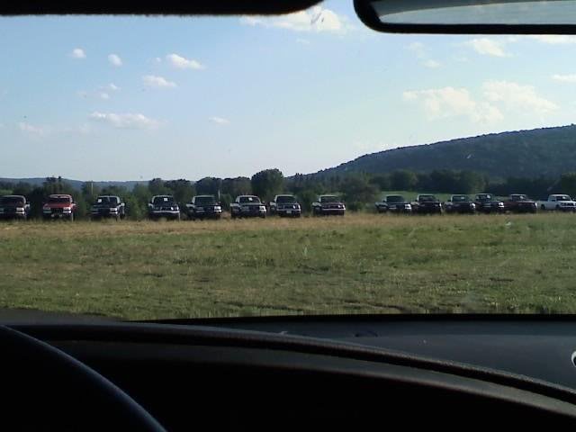

    Another fine point. Plus I believe they were taking the alloy rims off and recycling them.
    There were nineteen total trucks to be crushed when I turned mine in. One still had a nice bull bar on the front.

    god i hate to see those trucks go to waist

    That's a sad pic. Almost brought a tear to mine eye. I'd sure love to take some of those parts off their hands though.
