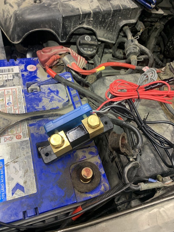

    Can the victron smartshunt act as a low voltage cutoff or is it purely a monitoring device?

    I’m traveling right now and can’t say for sure, so take with a grain of salt, but 99.9% positive the Smart Shunt won’t do LVD. I very well could be wrong though. Both chargers I’ve used (Victron and REDARC) charged it enough I’ve never found out in real life for my scenarios.

    Thanks for the info. Looking through Victrons manuals I think you are right. Do you see any issue with installing the smartshunt directly to the starting battery(with proper terminals and everything)?
    With a group 27 agm I have plenty of power for my needs but I would also like to monitor it.
