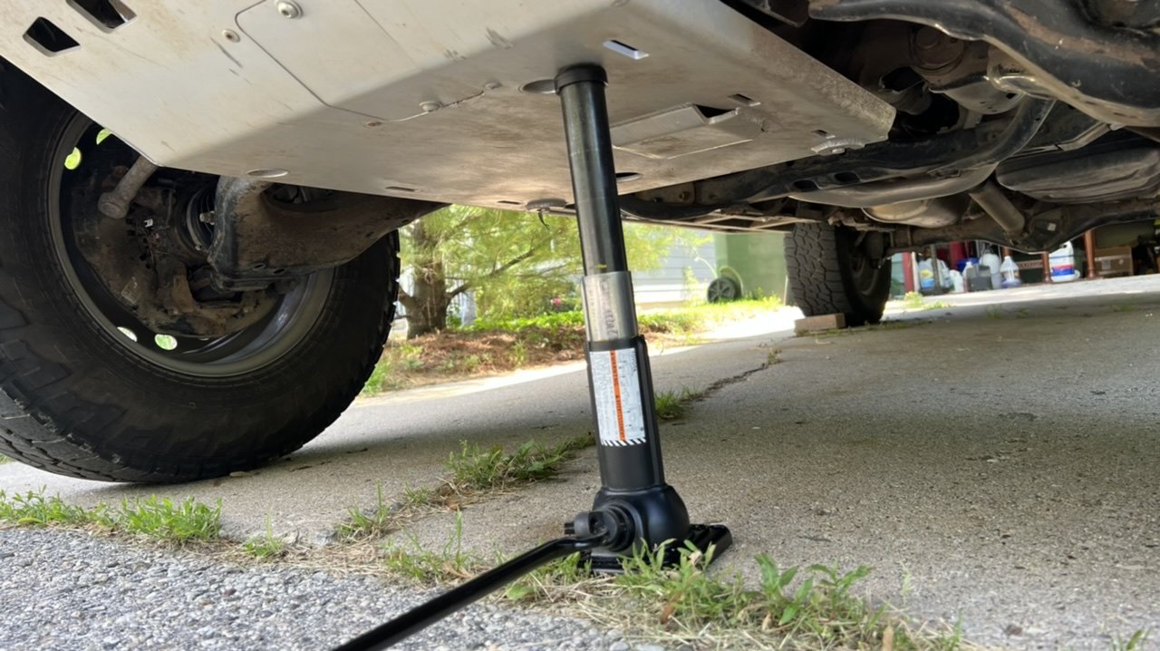

    Last small task is modifying an OEM 4Runner jack (09111-35150) to work with Safe Jack aftermarket accessories (not my original idea, see here and here for more). Pretty simple really, just need to drill out the spot welds on the top pad...
    I drilled more than necessary but couldn't tell until I had it off. Took some prying and convincing but popped off without much trouble.
    Safe Jack 3 piece starter set fits perfectly. I was trying to avoid buying these and wanted to fab my own but ran into time constraints. Definitely good quality pieces and should be able to lift the truck now that I have it lifted with more travel.

    You know the OEM jack has a screw top like the old bottle jacks and that those safe jacks things should slide rite over the screw top,
    mind you not the safest but it works in a pinch.

    OEM Tacoma jack has a larger bore that doesn't fit the Safe Jack parts. 4Runner jack is smaller and has higher weight capacity (slightly) and fits Safe Jack bore perfectly.

    Ok, just the last time I had mine out the screw top looked real small.

    Thanks man appreciate it! Trust me if I could have got the OE jack to work I wouldn't have wasted money buying a 4Runner one. They are close but no cigar. Surprisingly Toyota makes an astonishingly large number of jack variants.

    Good points about the jack. I was wondering if the stock jack was still useable with the lift. I like the safe jack solution especially if needed off road.
    Being up one tire size the stock jack works fine on the axle. With the lift no way it will lift the front from the frame. The RCI skid can handle the weight. I lifted next to one of the mounting points.

    Thats got to be the best way Ive ever seen to get a true height measurement with the laser level :thumbsup:
    About to do a similar front end refresh on mine with weekend

    Ha thanks, necessity is the mother of invention. Took me longer than I'd like to admit to figure out using the laser even though it was almost jumping in my face from the workbench.
    Good luck with your upgrades!
