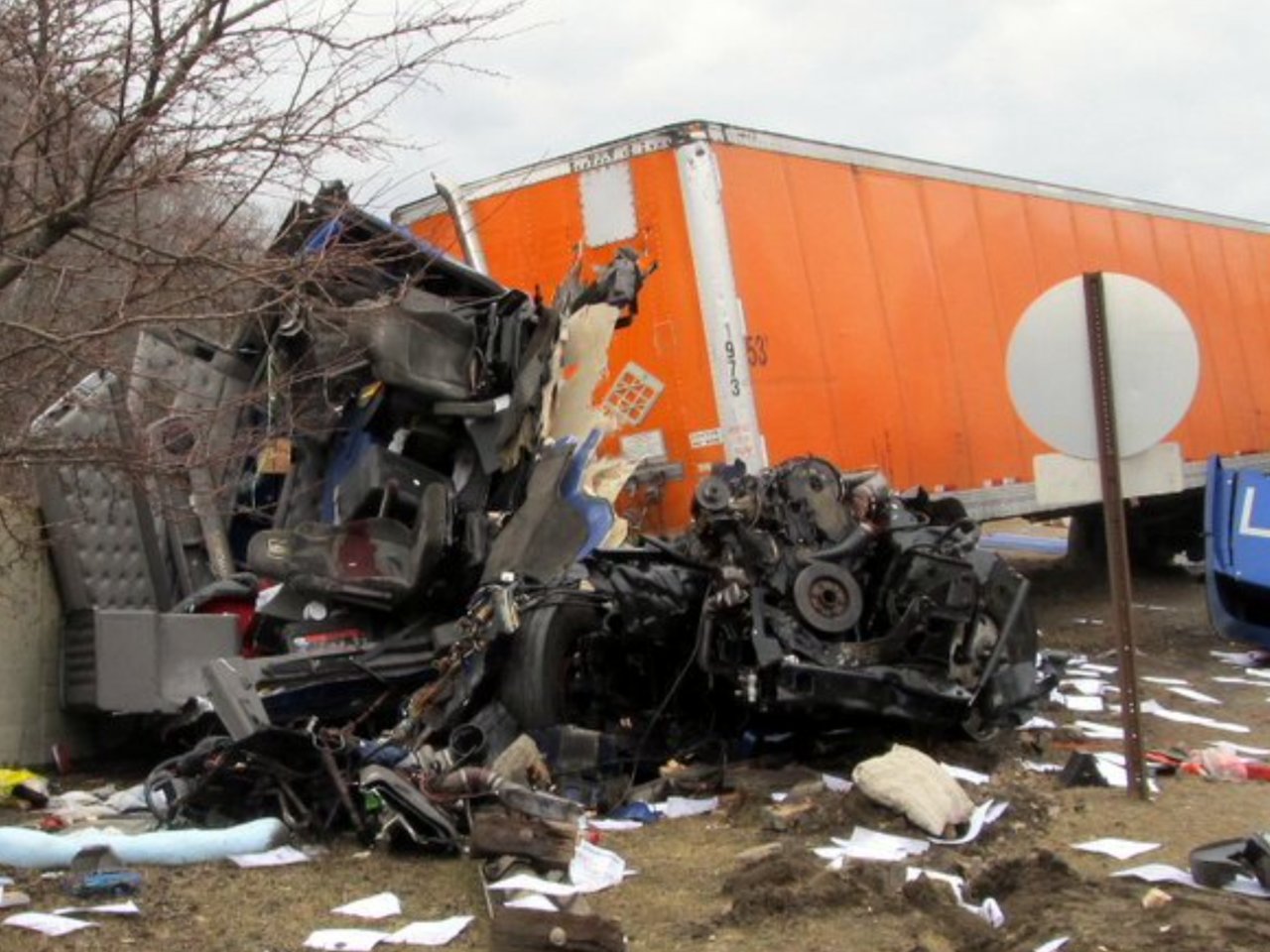

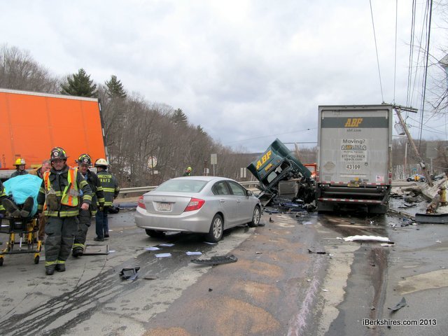

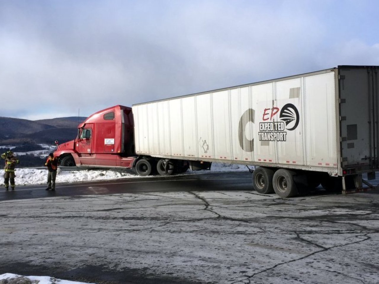

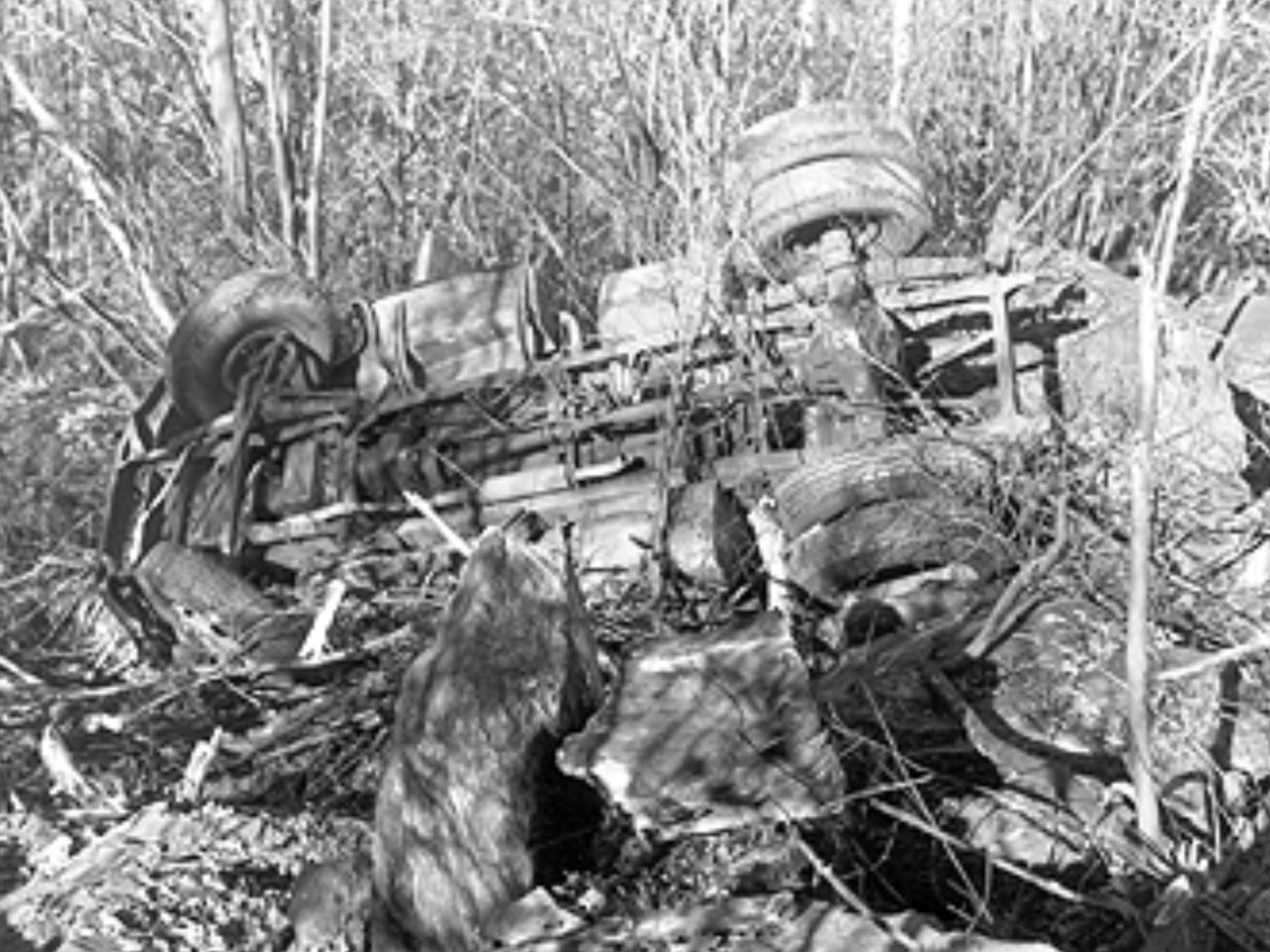

    It's a slow weekend, so I'll throw in where my desire for extra awesome brakes comes from. Tracing the origins is fairly easy, I live in a valley, and one of the major routes in here, is this.... absolutely beautiful and a real hoot to drive.
    Needless to say, this descent, along with the twisty fun on the opposite side of the ridge, has caused its fair share of carnage, usually when folks run out of talent, or brakes. On the valley floor, the smell of cooked brakes is a fairly common reminder. Here are a few examples of the fun, most within the last 5 years.
    This tour bus was lucky, the driver utilized the snow bank and brought the bus with failed brakes to a stop right on the hairpin. Bust a move!
    This guy was EXTRA lucky...
    Here's the bottom of that drop in the 1970's, and someone that was not lucky.
    This guy made it all the way down into town, and on the last corner, before the descent ends, his luck ran out. As he cut the corner, in order to stay on the road, he met another truck.
    Be safe! Give your loved ones a hug... and embrace the big brakes!

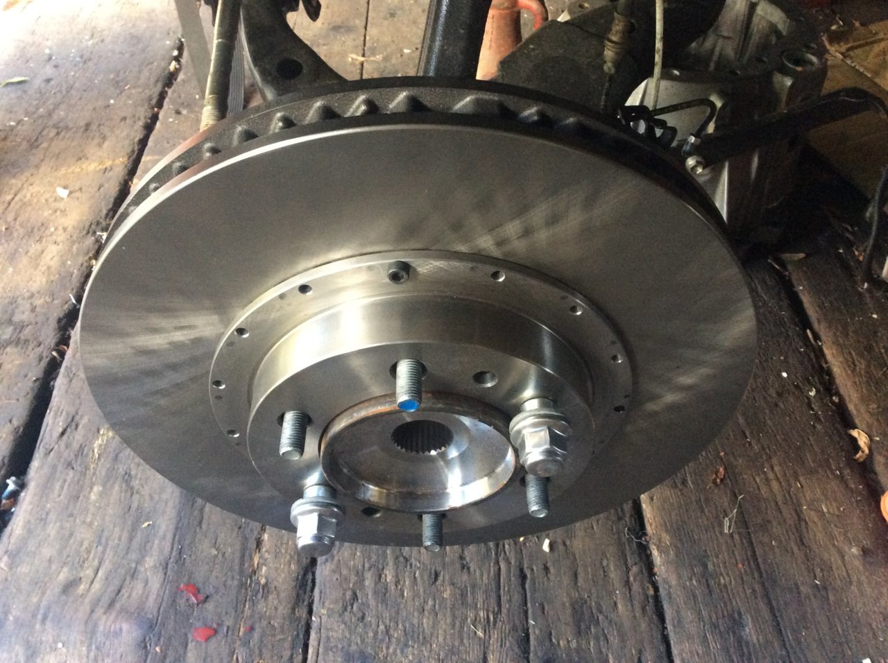

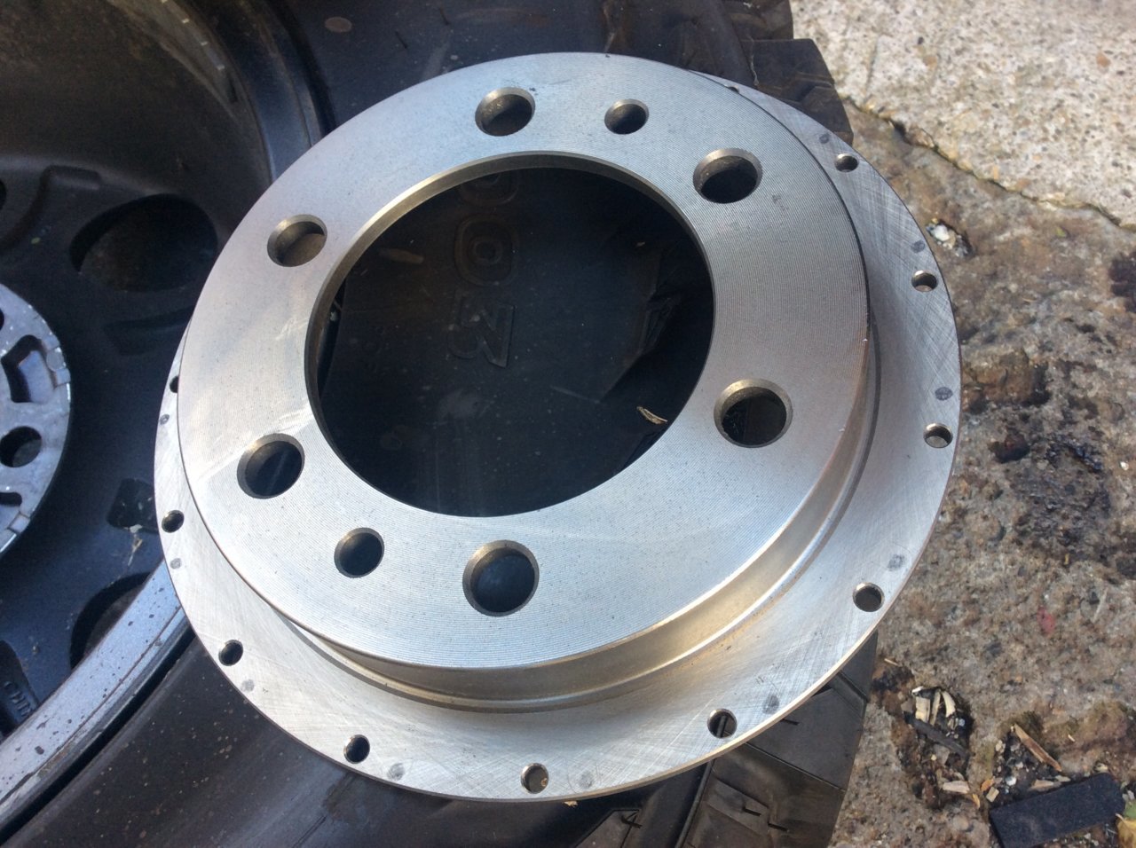

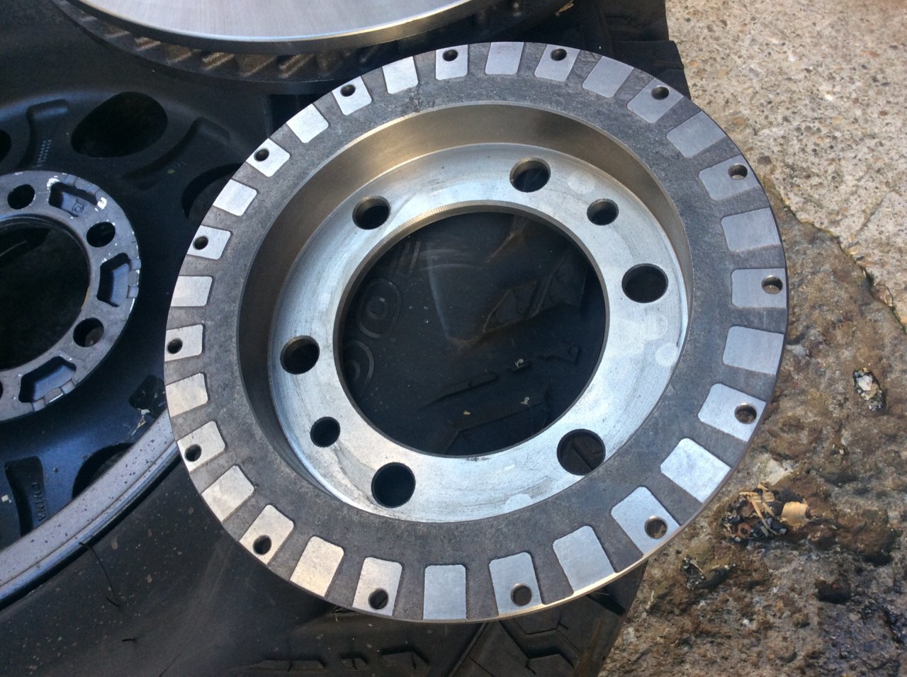

    Finally received the prototype rotor and hat, and it appears that we may be able to sneak this combo under regular 17" wheels.
    Here is the hat...
    Small vanes on the inside to cut heat transfer from the rotor into the hat.
    Oh yeah, it's gonna stop very well!
    Now on to the caliper adapter bracket.

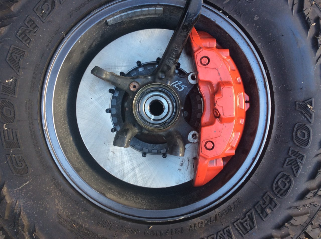

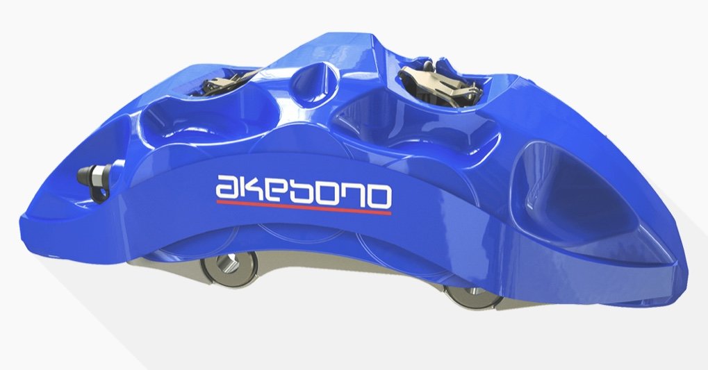

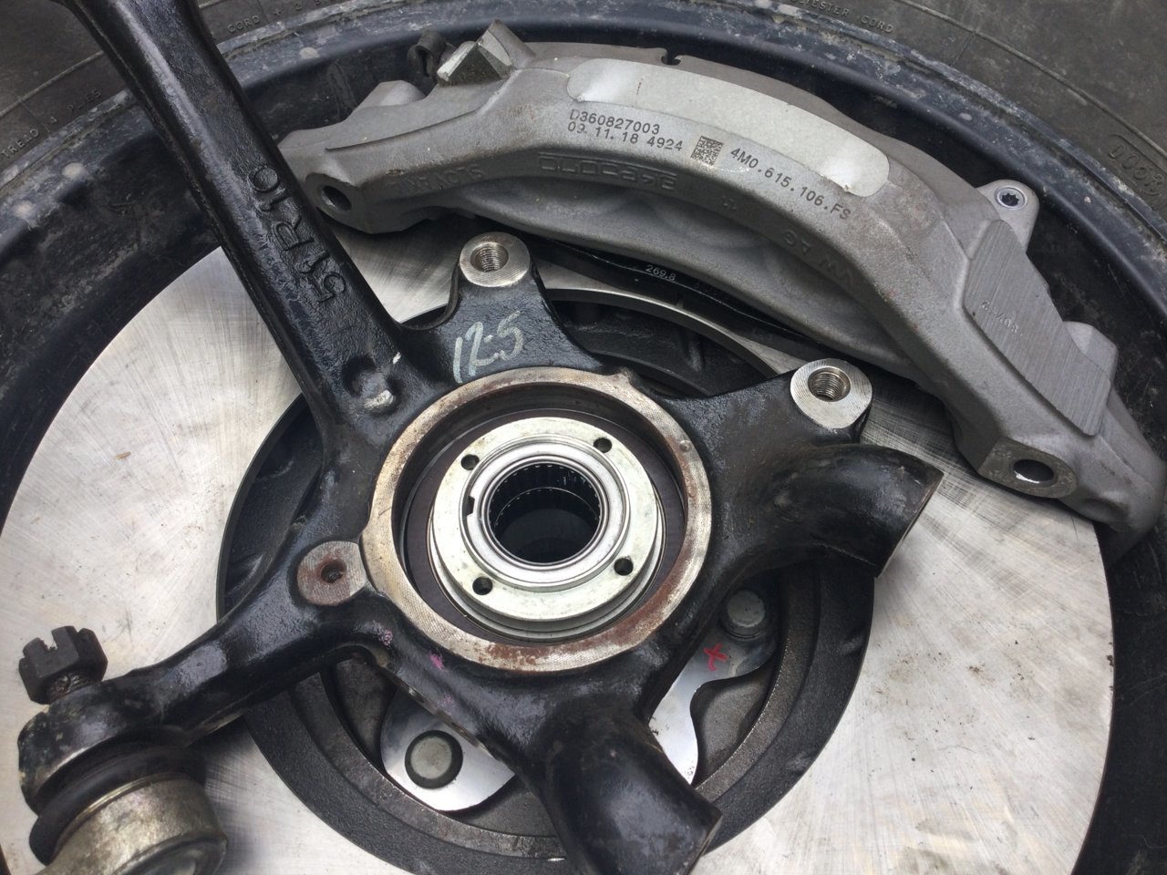

    Moving along again… caliper change to Akebono 6 piston. These are OEM late model calipers that are readily available new or used and decently priced. Roughly $1k + or - when purchased new for a pair, depends on model and color. Clean low mileage units are all over the place in price, while $400 - $600 is a good general range, a little luck will bring them home for less.
    Pretty picture from Akebono Japan.
    Bracket design time…. Radial mount makes it so easy.

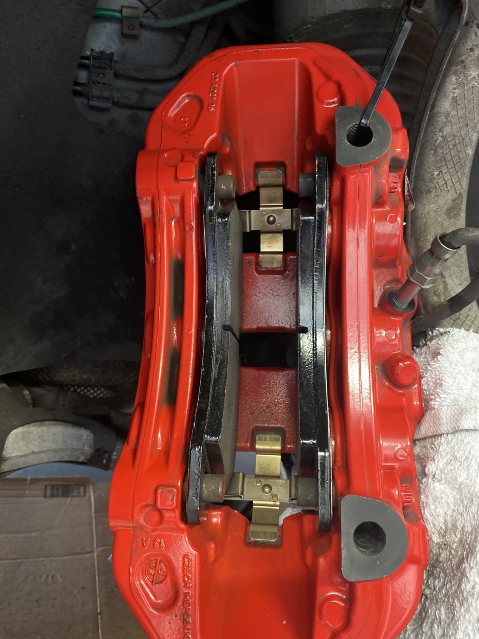

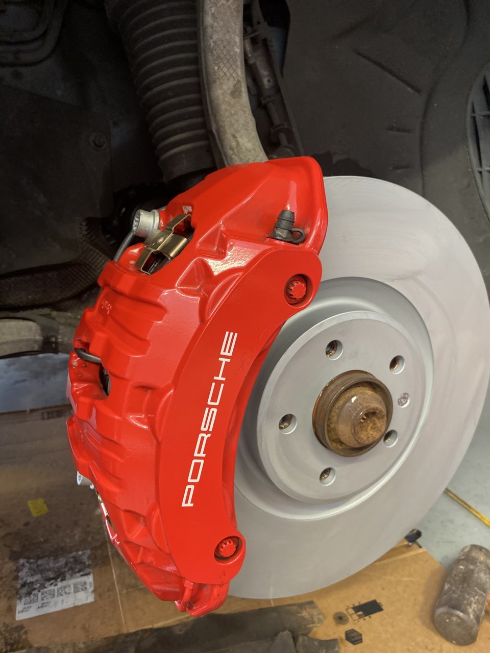

    quote from Porsche dealer for brakes on our Macan GTS was $4k (rotors, pads all around). I did it for about a grand including new sensors. I think the front pads were anywhere from $100-250 depending what you wanted.
    How are you going to mount the Porsche calipers?
    CE01F0F2-75F7-429D-B560-6C8BD6CC909A.jpg 752626DA-DEDB-4F44-AF24-3C5E815B4F47.jpg

    Custom brackets to adapt them are a fairly simple task.
