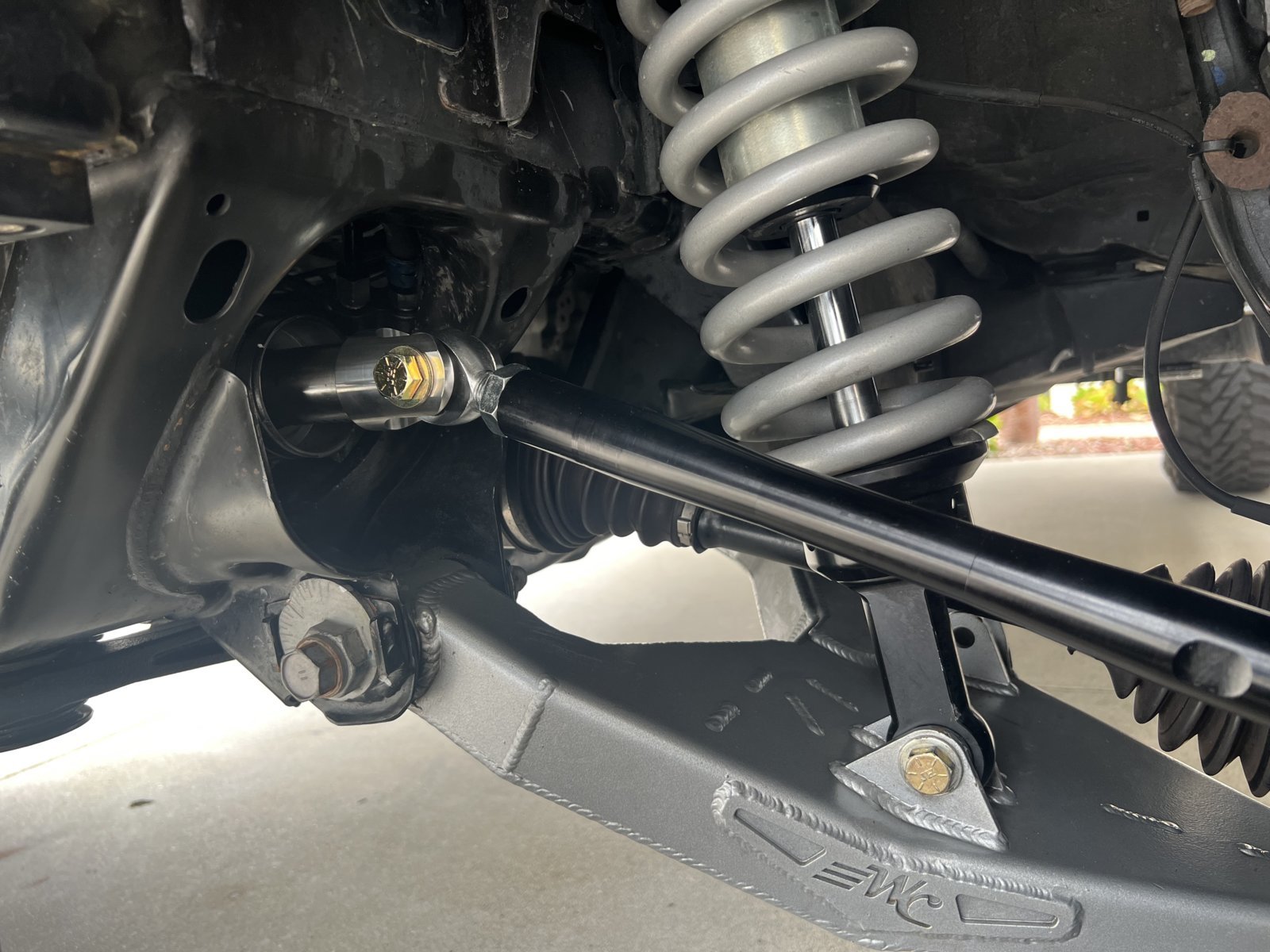

    Yeah I actually had this same issue with both LT kit and the heim steering kit. The LT kit I just fixed myself but when I picked up the heim steering kit I pointed it out and he switched all the adaptors for me.

    I’ll be doing this over the weekend.

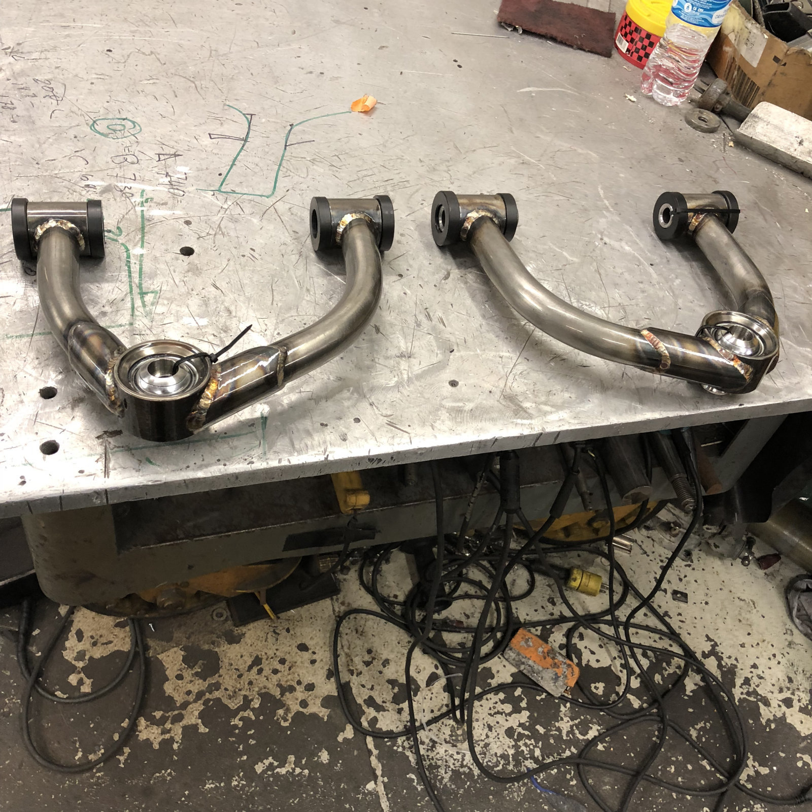

    you guys know that its not even powder coat lol its F***ng Steel it (or a different brand same pigmented metal coating) . Glad i left baja kits (aka BajaHits) right before their journey into other markets/locations. I think Mike is the owners name of WC i think at least from what i remember from an old friend saying it was his uncle. any who when ever i follow them on IG somehow i strangely have to re-follow them weeks later ,i found it odd and annoying so i moved on . I definitely will encourage all to dual shear UCA mounts /LCA mounts/parts of the frame / spindle if its OEM / shock tower would need a either the top mounting hat for the c/o to be 1/4 thick or have a 1/4 thick doubler welded on the top of the tower if you're only going to be single shocking it. ill leave a pic of the 1st pair of UCAs i made , fully jigged and Tig welded. I've always made my own stuff ,currently almost ready to install my own cad designed to (OEM chassis step file ) Cantilever kit along with +3.xx over LT kit . Ordering all LCA pieces in thinner gauge for R&D. wish i was closer to opening my own shop but one day hopefully sooner by the powerball gods then you guys wouldn't have to worry about all this extra hassle just to get the kit installed. 4FF59862-5763-4028-8D00-96FD669A04E2.jpg

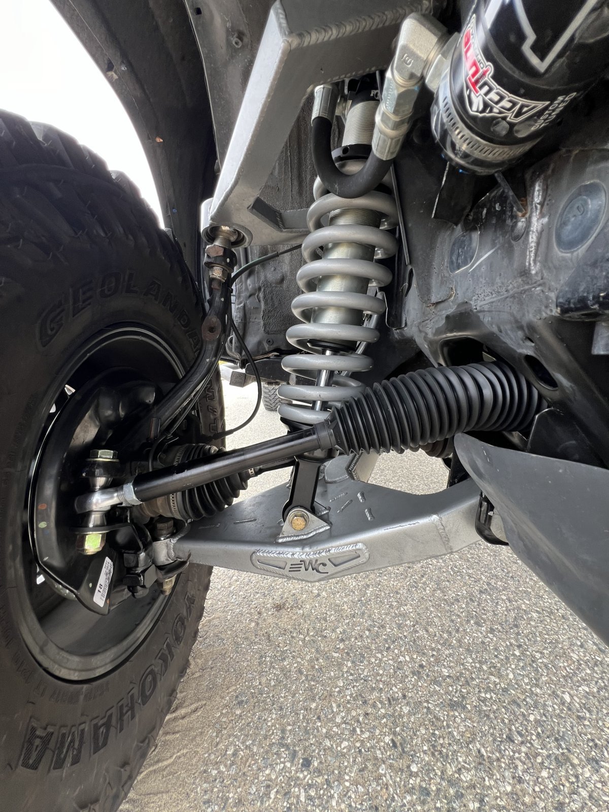

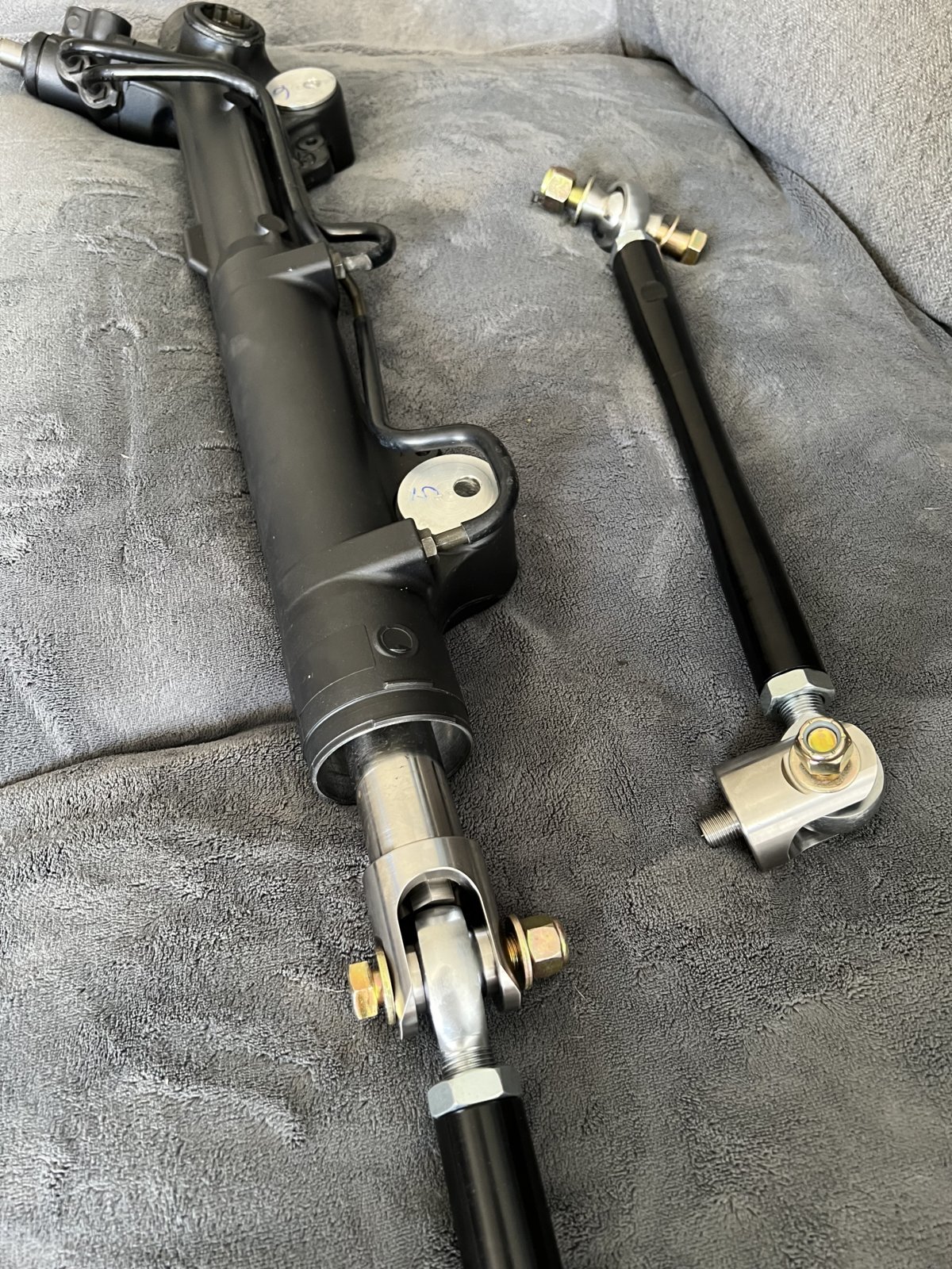

    Tundra steering rack, clevis and heim steering rods with double shears on the spindles. I didn’t even need to cut the original steering rack bolt.

    RC fab tie rods ?
