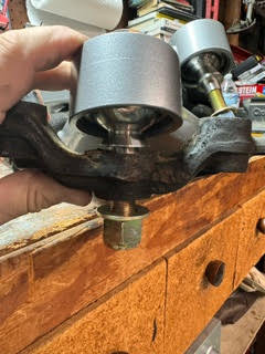

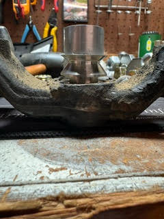

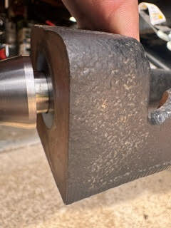

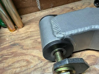

    nothing fits, I'm pretty sure I got the wrong kit maybe for a 4r or a gen2.5. All heimed alignment spacers don't fit. All bolts have slop within the sleeves. I'm doublesheer on UCA, so I'd physically have to bend the bolt in order to fit into the UCA. I'm going to try to return and just buy dirt king.

    That really sucks man, I'm sorry. I had the same fitment issue on the UCA. I feel like their templates for fabrication is off by a hair.

    you gen 3? are you double sheer? did you have slop in your sleeves? how about heim fitment?

    I have a 3rd gen. A little slop in the sleeves. I had a bushing, not a heim
