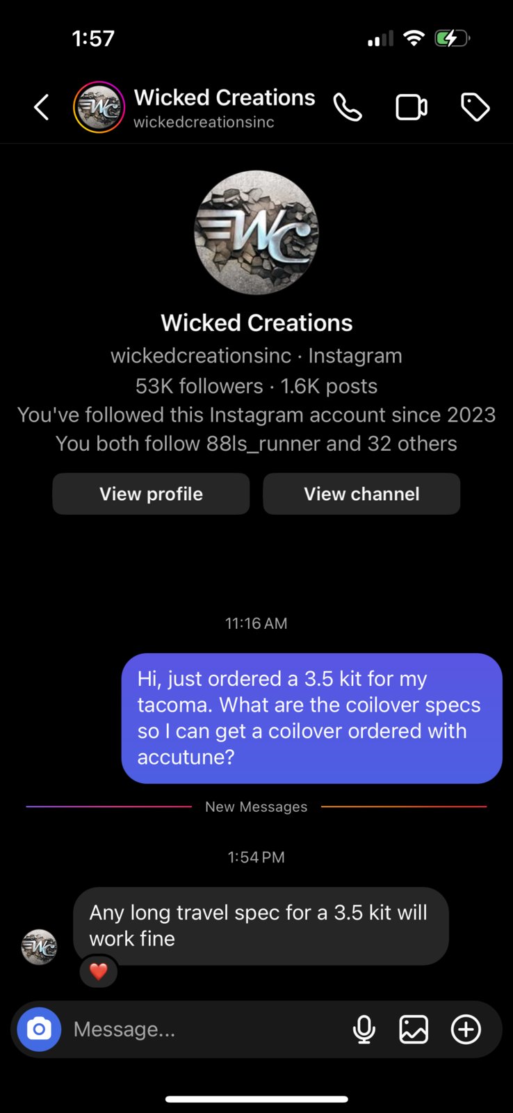

    Have you guys done any coilovers for this kit yet on a 3rd gen tacoma? Just bought their +3.5 kit and need to get some Coilovers ordered eventually

    I've reached out to wicked because Accutune needs specs. Wicked keeps ignoring me...

    Im picking mine up from their shop when its ready. Worst case I can get specs when im there

    Maybe just order it per dirt king specs? The kits seem similar enough

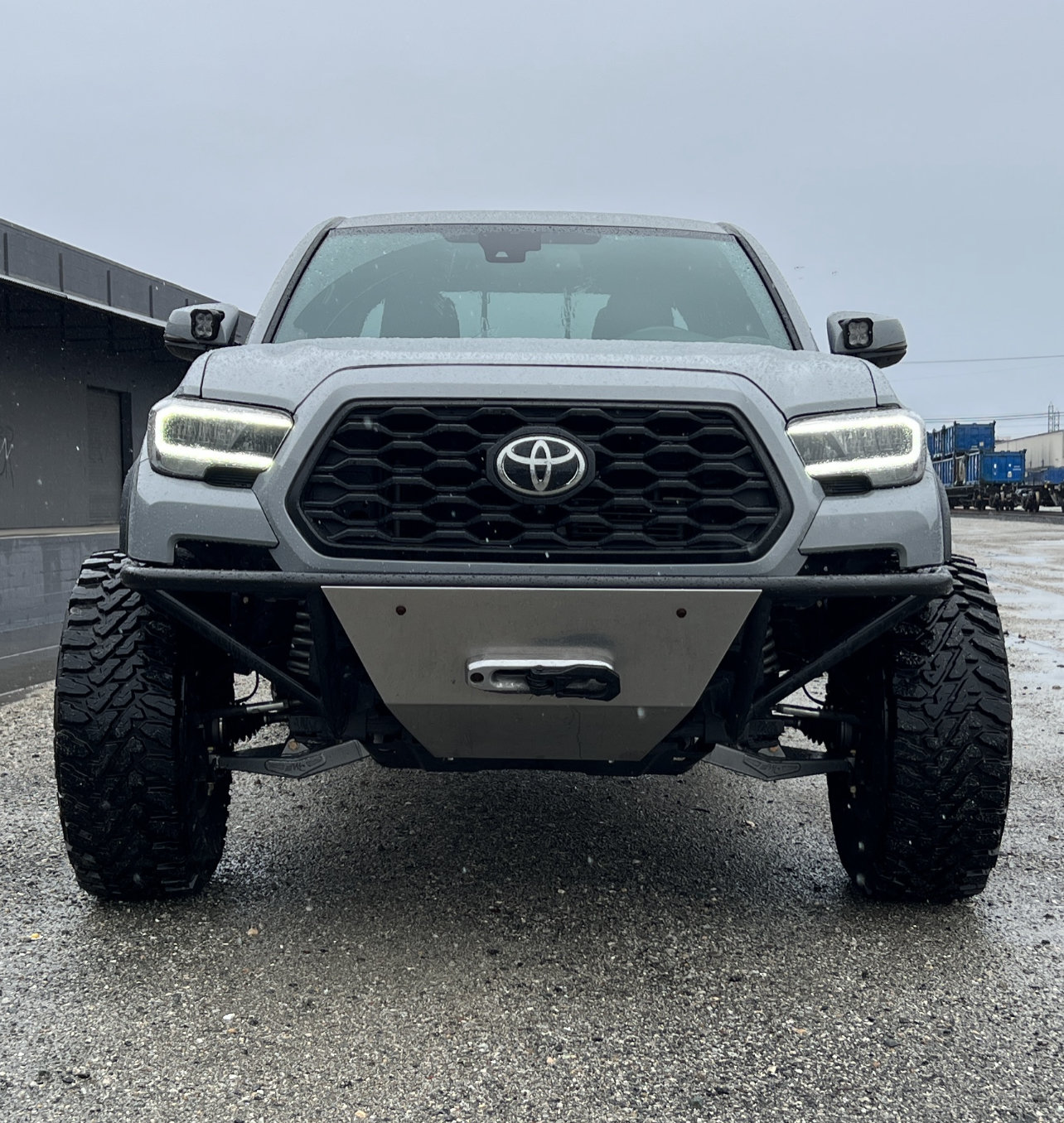

    wicked creations +3.5 long travel kit with double shear for the upper control arms. In this picture it’s sitting on the factory length fox coil overs I should be picking up the long travel coil overs from accutune Friday or Monday. After a long talk with Stephen at accutune and pulling all the measurements it was determined the total chaos spec’d coil over from fox 2.5 DSC was a near perfect fit( I was looking for fox 2.5 DSC to match the rear). The only difference being that eyelet spacers need to total 1.5” opposed to the total chaos 1.25”
