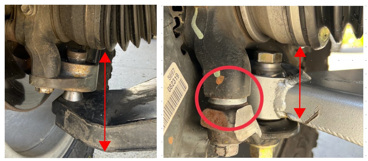

    I wouldn't consider the loss of ground clearance with that LBJ adapter configuration a " win", any kit that uses a LBJ adapter like that has about 2" + less ground clearance under the LCA ...

    And yet I have had 0 issues crawling , dragging the lcas over rocks or any other thing. At least since 2012. Not to mention the point your making in the pictures is so close to the tires/wheels it really makes little difference. Like the LCA ball assembly bolt/nut hanging under the joint.

    Pretty big difference. I personally wouldnt buy a kit that moves the lca down that low with an lbj adapter. Not just by the tire but the whole arm hangs lower

    A portion perhaps, but not the whole LCA.

    I bought the +5 kit back in October. I didn’t receive it for 12 weeks. When it came I noticed all the uniballs were hand loose. No real play but the uniballs were looser than any other one I’ve gotten new. I installed the kit initially with mid travel coilovers which only extend to about 22”. I then ordered some 8” coilovers from Accutune which extend to 24” which is the perfect extended length for this kit. After installing the shocks I Quickly realized the Cv shafts were rubbing so Mike from Accutune told me to get 2” rod ends. Finally it all went back together. After a few drives my CV boots ripped open. I noticed at full droop the boots were contacting the lca even with the LBJ Spacers. I measured Without coilovers and this kit cycles 15” of travel at full bump compression meaning that rubber bumps pancaked. You can only cycle about 12-13” strapped before the boots start rubbing. Last weekend I took the rig out to some pretty hefty whoops. My coil buckets decided to buckle on me. This was due to my Coilovers having a changed Extended/compressed length from adding in the 2” rod ends to allow room for the cv shafts to articulate. Since the shock length increased my bump stops no longer made contact at full compression so all the load was transferred directly to my upper coil bucket. I’m honestly not sure if king/fox make spec 8” coilovers with 2” rod extensions like y’all have found which only extend to 24” so lmk if that’s where I went wrong. My plan currently is to weld in new coil buckets that extend 2” higher to get back the lost up travel. I’m also installing 2.5” air bumps to mitigate any unwanted forces being transferred up top.

    Look at post #67 in this thread this use of 1/4”washers between the spindle and lower ball joint adaptor will help keep your cv boot from contacting the lower control arm but the limiting factor will be the cv angle binding so make sure you can spin the wheel when you set the limit straps.
