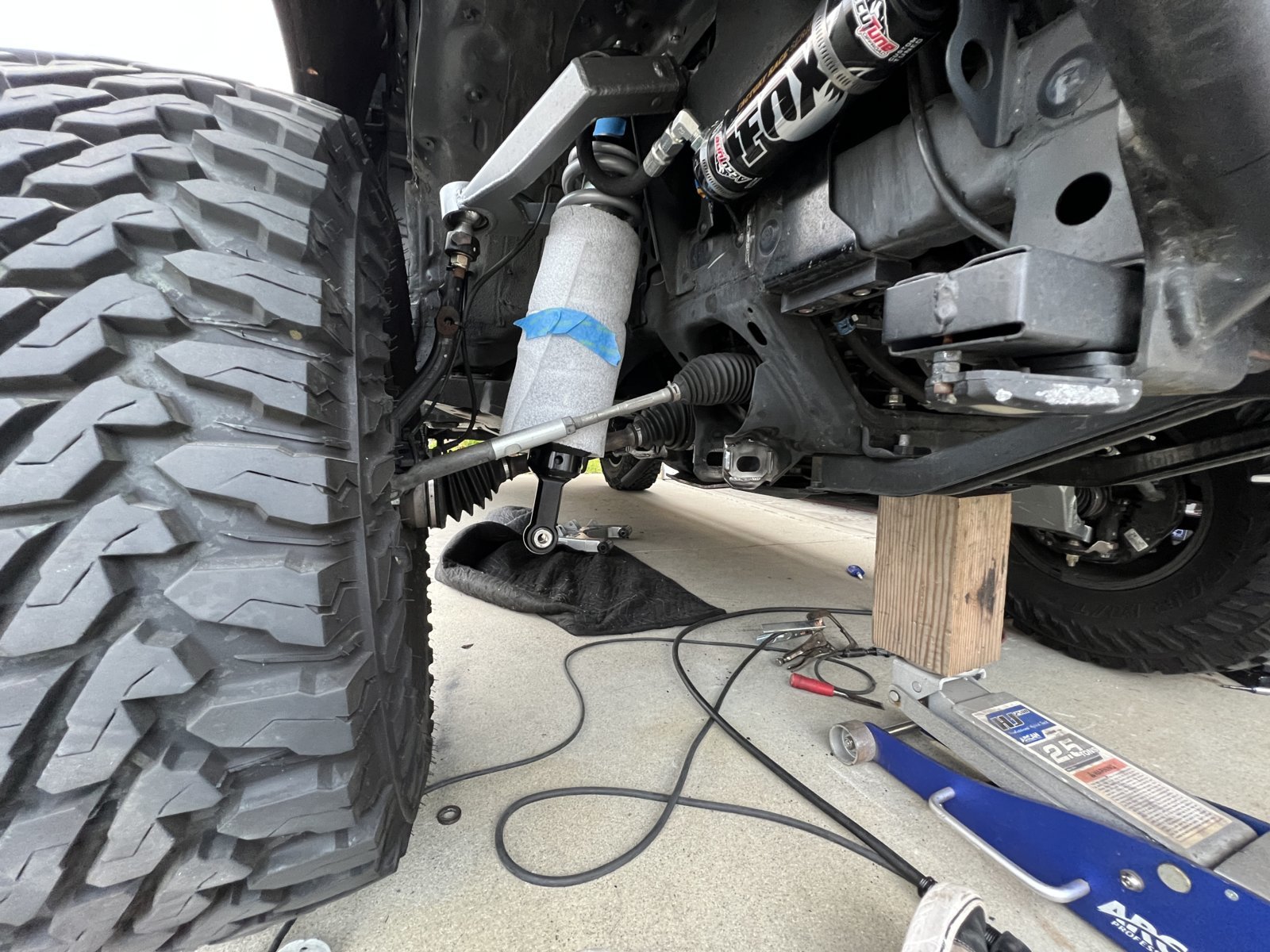

    I’m saying I used the 1/4” thick washers that came with my kit and placed each one in between the spindle and ball joint adaptor. By doing this you are raising the spindle and creating more space between the cv boot and the lower control arm (3rd picture). With that extra space between the cv boot and the lower control arm the spindle will be able to drop lower. HOWEVER the cv will now be low enough to bind up, this is why the wheel needs to be off the ground, so it can be spun to ensure it’s not binding. My wheel only was catching/binding in one spot so make sure to do a full spin of the wheel.

    I forgot you have +5 kit, our numbers are different lol. For me it is the cv that limits my travel. I still have space before my misalignment spacers hit the cup.

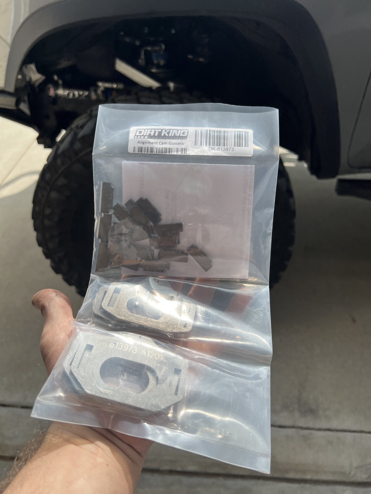

    Got the preload adjusted. Now just need to install the dirt king alignment cam gussets before I get it aligned.

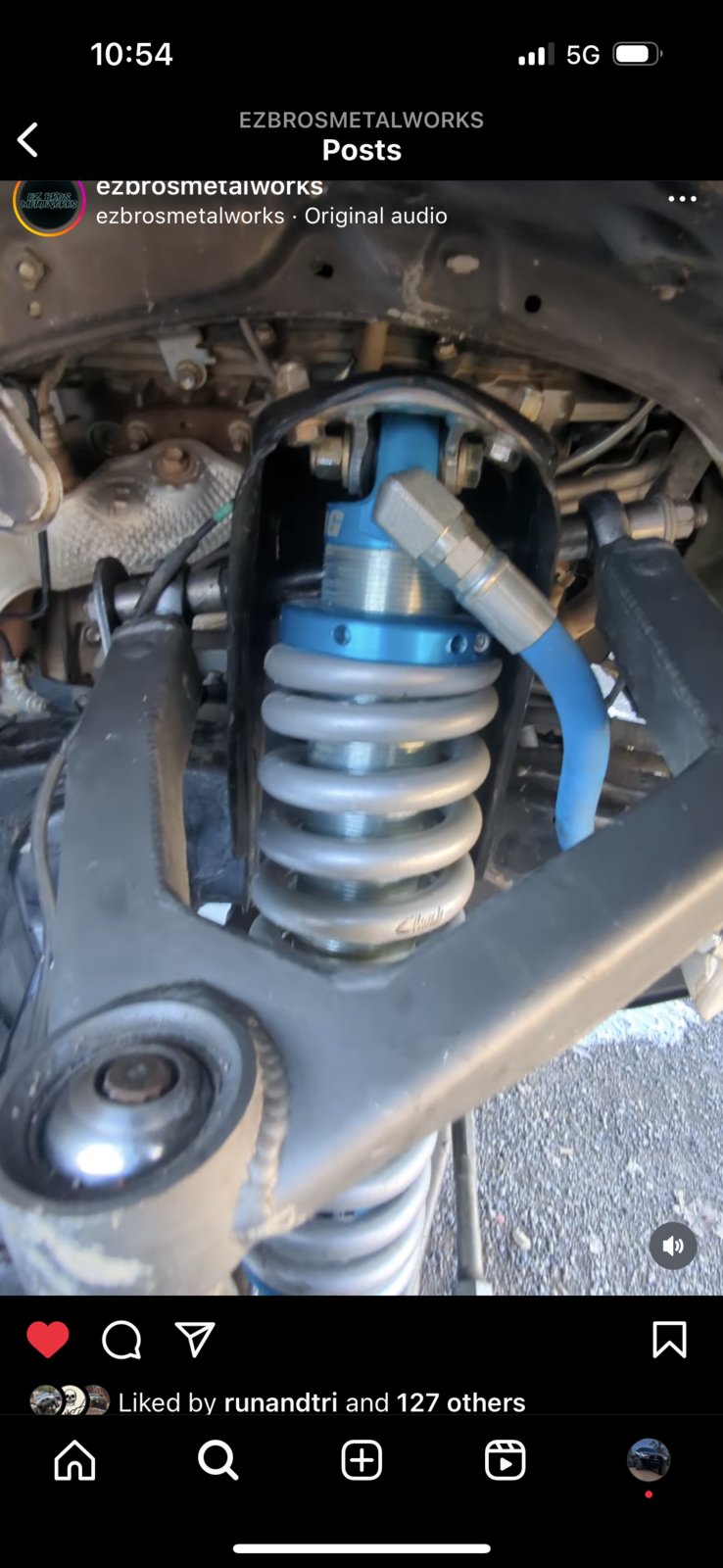

    hey bro do you have any pics of the damaged coil over tower? I’m curious how it failed and the weak point so I can pay attention to mine in the future.

    @Tcodyw88 i snagged a picture. Pretty sure the coil was bottoming out before the bump. The tower is definitely a weak point either way though

    Thanks bro. I wonder if a fox 2.5 coil over would have this problem. The top hats on the foxs are much beefier and spread the impact load better. Kinda looks like the coil over’s top hat tabs buckled and the load was no longer being spread across the outer section of the interior coil bucket and because there’s a hole in the center of the coil over bucket it allowed it to punch up thru it.

    I'm positive the same thing would happen if it was a hard enough impact. Just my opinion though

    Cam tab gussets installed and truck has now been aligned. Additionally the binding on my cv was caused by the alignment for my factory length coil overs, accidentally figured that out after forgetting to mark the cam bolt locations lol. Leaving the tire on makes the process a a lot faster too :D
