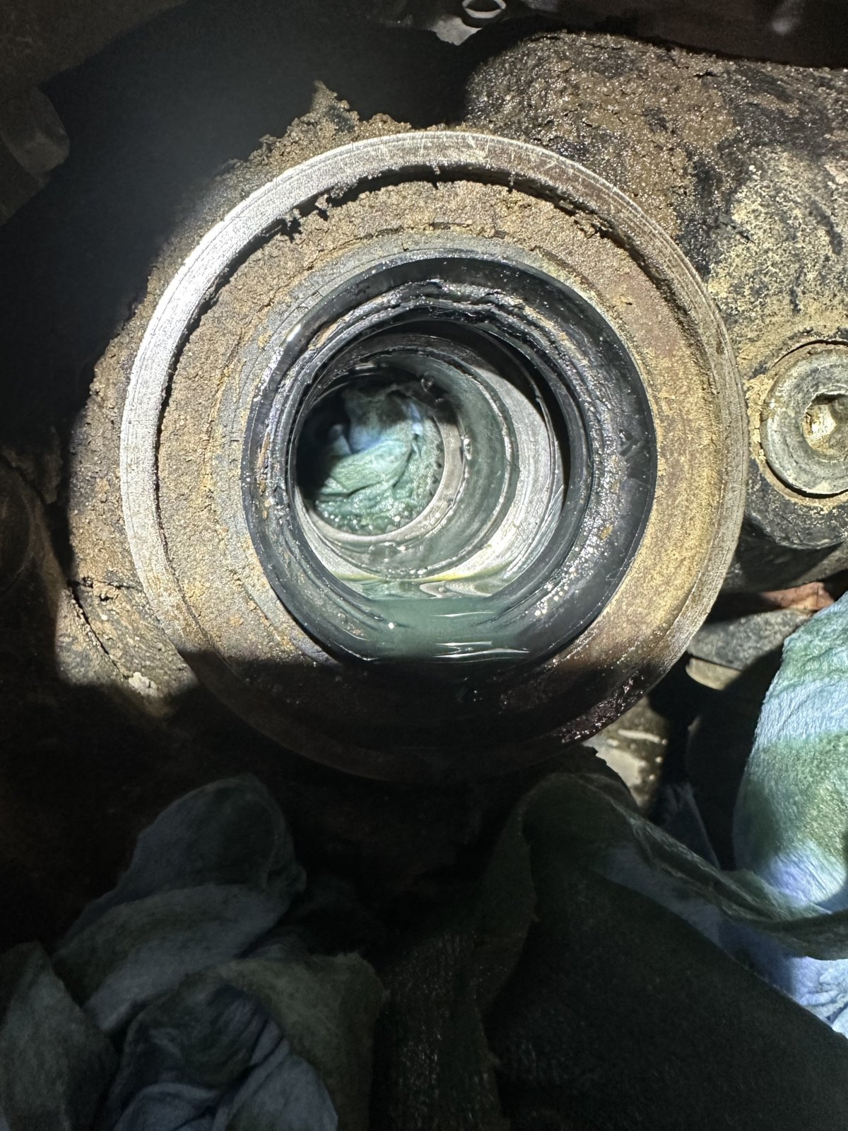

    Also somehow managed to break my needle bearing pulling my cv out. Ended up with just the sleeve stuck in there :confused:

    I finally got bigger tires 2020 Long Travel Tacoma 1997 MAGNUM
    Mines seated all the way

    you shouldn't have to ream the spindle at all. There is a correct size heim spacer for our spindles.

    No I just used a ratchet to crank it down

    I just didnt crank on them hard enough lol

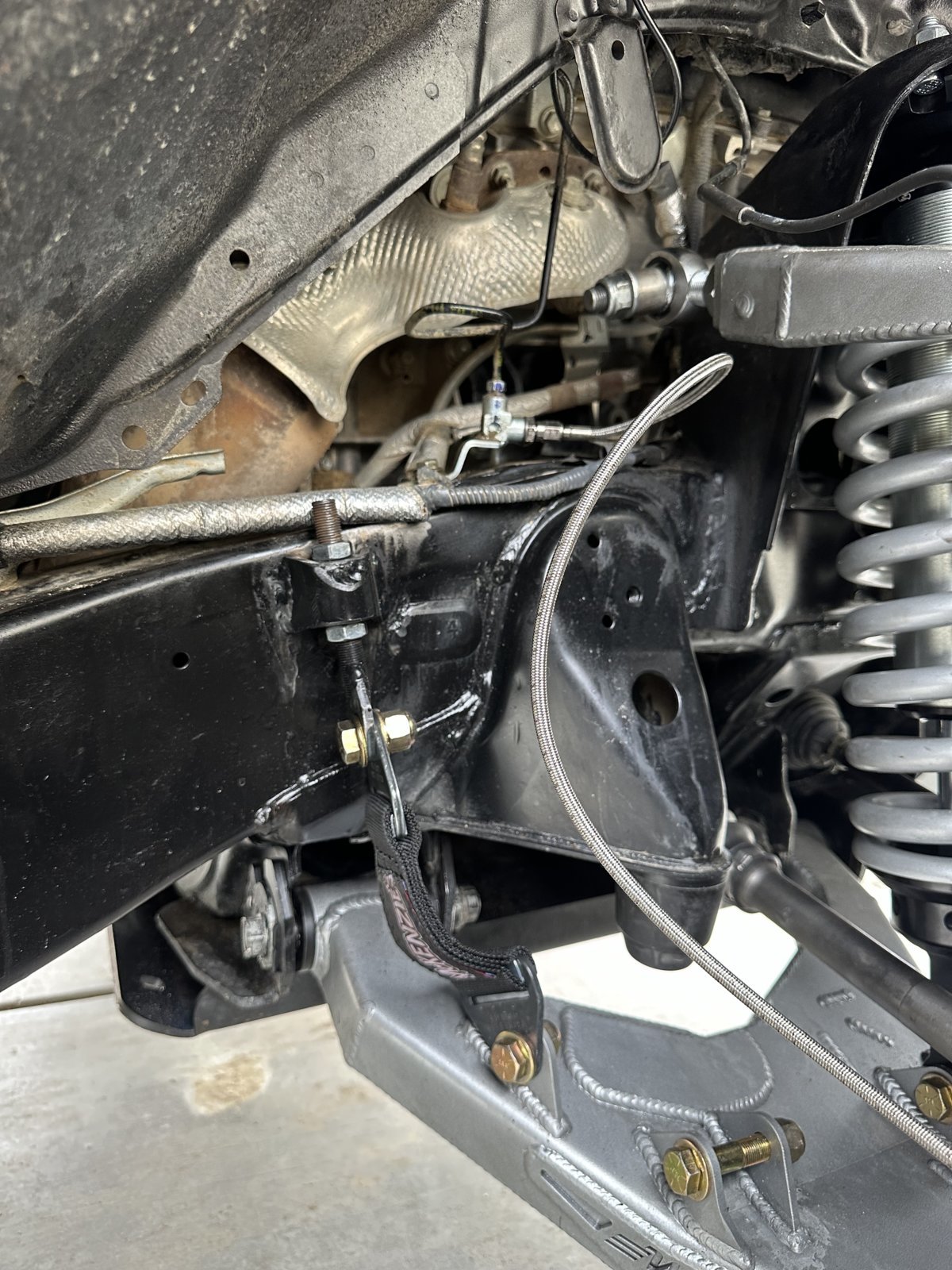

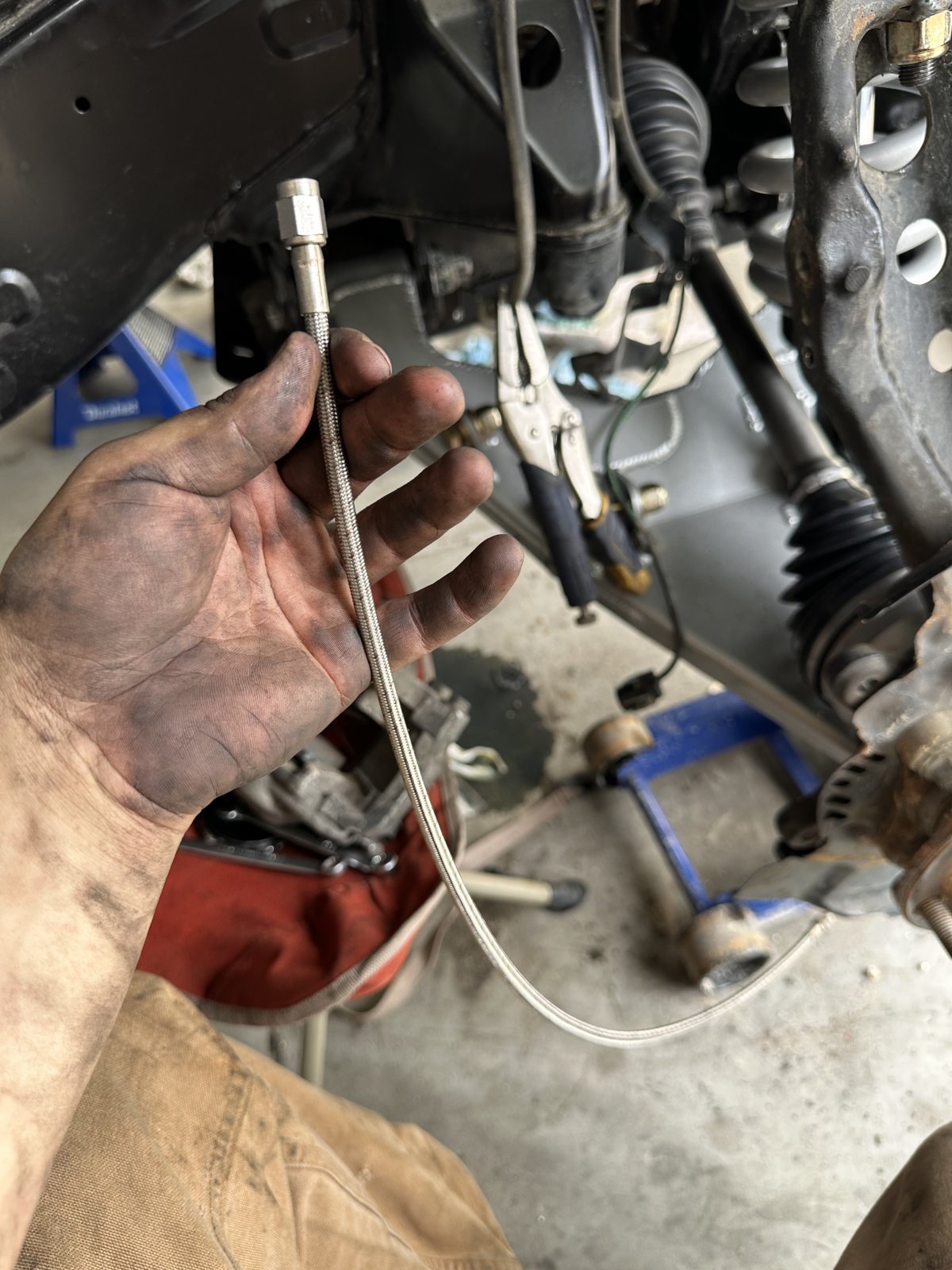

  6. Feb 24, 2024 at 1:11 PM
    #126
    trail.taco
    trail.taco Well-Known Member
    Jul 28, 2022
    #402379
    177
    2019 Tacoma Trd Offroad
    Beadlocks, 35s, Mid Travel
    These the brake lines you guys got with your kits too? I cant seem to thread them on
  7. Feb 24, 2024 at 2:06 PM
    #127
    SoonToBeOn39s
    SoonToBeOn39s Well-Known Member
    Mar 20, 2022
    #393038
    1,832
    I didn't get any brake lines lol. I got some crown brake lines. They're super good steel braided
    Tcodyw88 likes this.
  8. Feb 25, 2024 at 8:41 AM
    #128
    Tcodyw88
    Tcodyw88 Well-Known Member
    May 5, 2021
    #364823
    281
    Cody
    El Segundo, Ca.
    2020 TRD offroad
    I got mine from wicked but the ones I got connected to the brake line block that’s bolted on the top of the frame.
  9. Feb 25, 2024 at 8:47 AM
    #129
    trail.taco
    Jul 28, 2022
    #402379
    177
    Gotcha
    Gotcha, i couldnt even get them to thread onto the hardline at the brake caliper so its probably wrong. Just bent the hell out of my hardlines and pointed them straight for now. Ill go swing by the shop and ask them next week

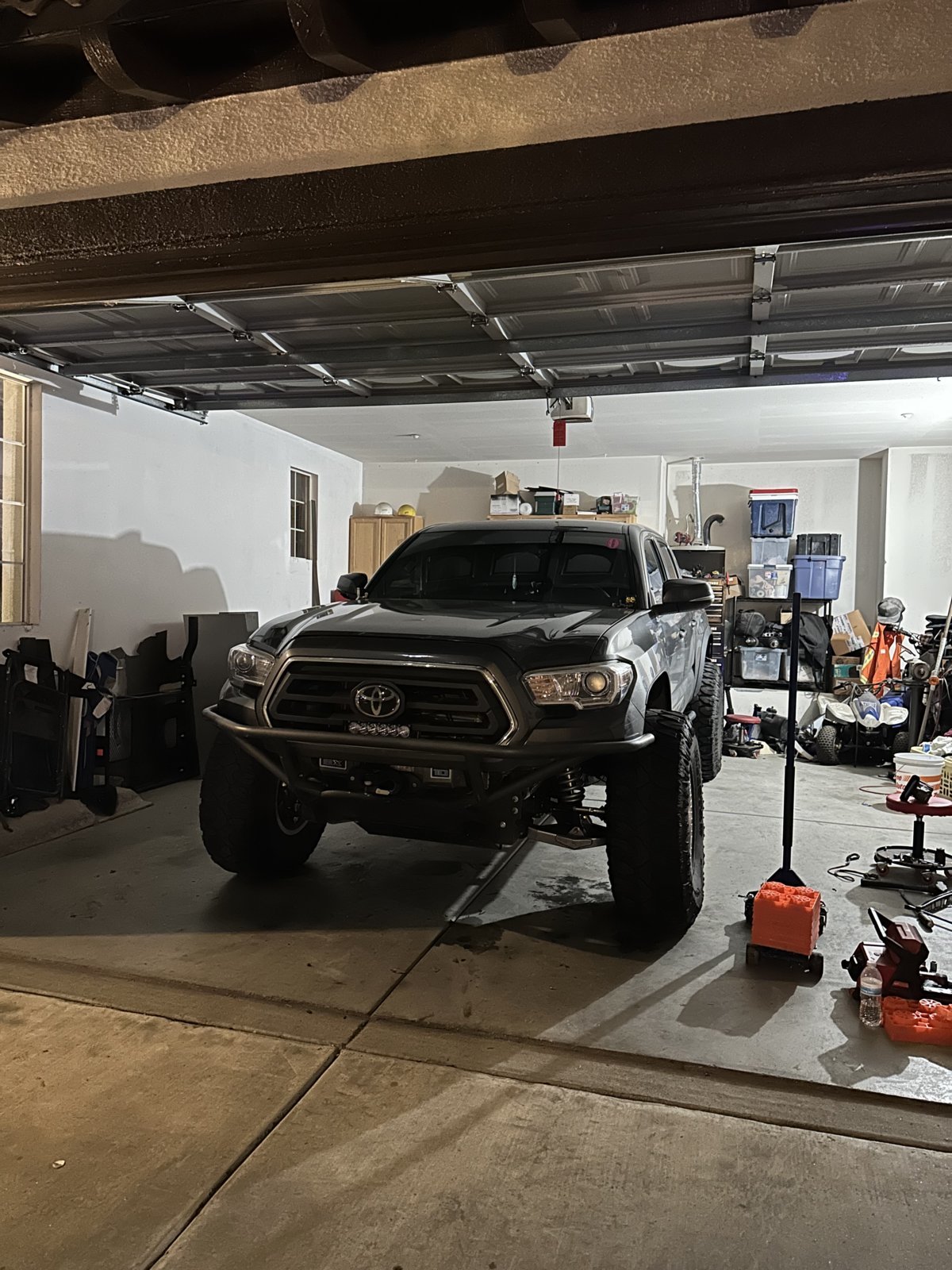

  10. Feb 25, 2024 at 8:50 AM
    #130
    trail.taco
    Jul 28, 2022
    #402379
    177
    Heres how she sits for now. Need to add a bit more preload and dial in the alignment when i get a chanceIMG_2134.jpg
    BabyBilly, SoonToBeOn39s and Tcodyw88 like this.
  11. Feb 25, 2024 at 8:55 AM
    #131
    Tcodyw88
    May 5, 2021
    #364823
    281
    Cody
    El Segundo, Ca.
    2020 TRD offroad
    Looks really good bro!
    Do you heim upper control arms? I had to adjust mine pretty far out for my alignment guy to get it right.
  12. Feb 26, 2024 at 8:09 AM
    #132
    trail.taco
    Jul 28, 2022
    #402379
    177
    Yep. Definitely need to adjust mine out to get my camber right. Closest i can get it without touching the ucas is still -2 degrees of camber
    Tcodyw88[QUOTED] likes this.

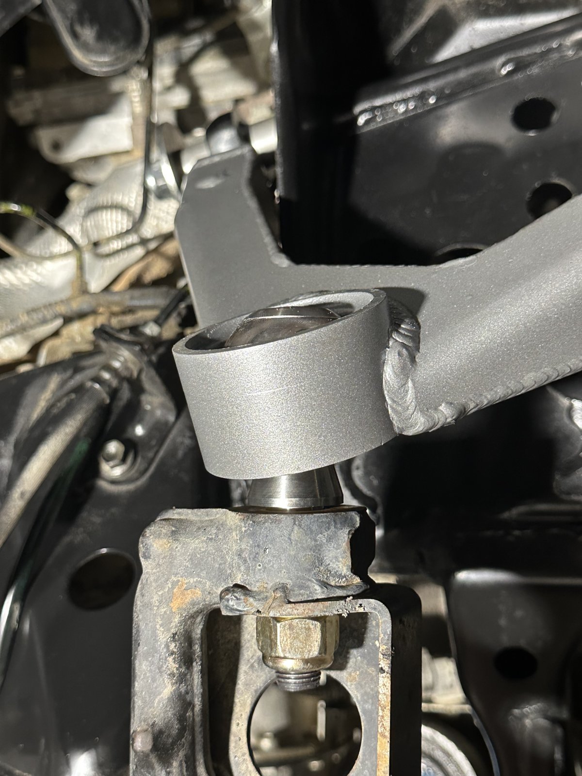

  17. Feb 29, 2024 at 10:51 AM
    #137
    trail.taco
    Jul 28, 2022
    #402379
    177
    Noticed my limit strap jam nut wouldnt keep the clevis tight and they started loosening up. Have had better luck running the nuts like so
  18. Feb 29, 2024 at 1:28 PM
    #138
    Tcodyw88
    May 5, 2021
    #364823
    281
    Cody
    El Segundo, Ca.
    2020 TRD offroad
    I have mine like that also right now cause I didn’t want to hear them clacking lol

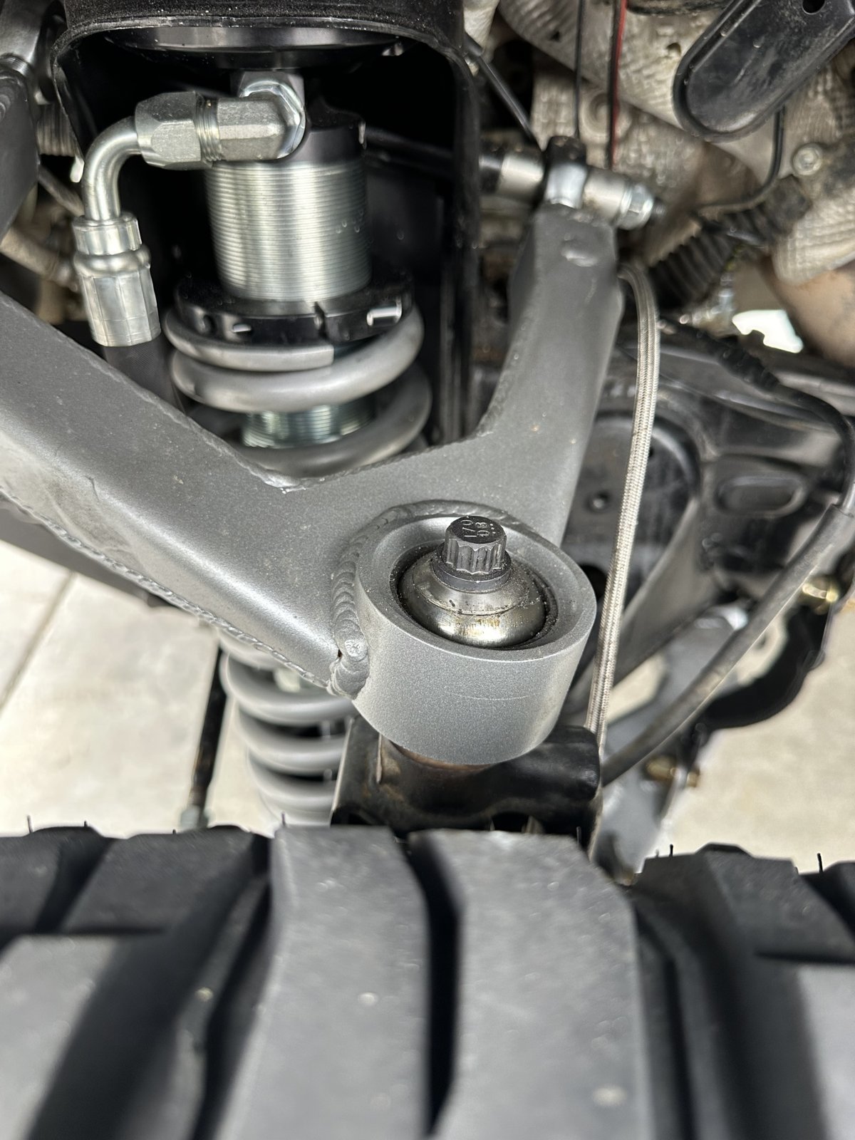

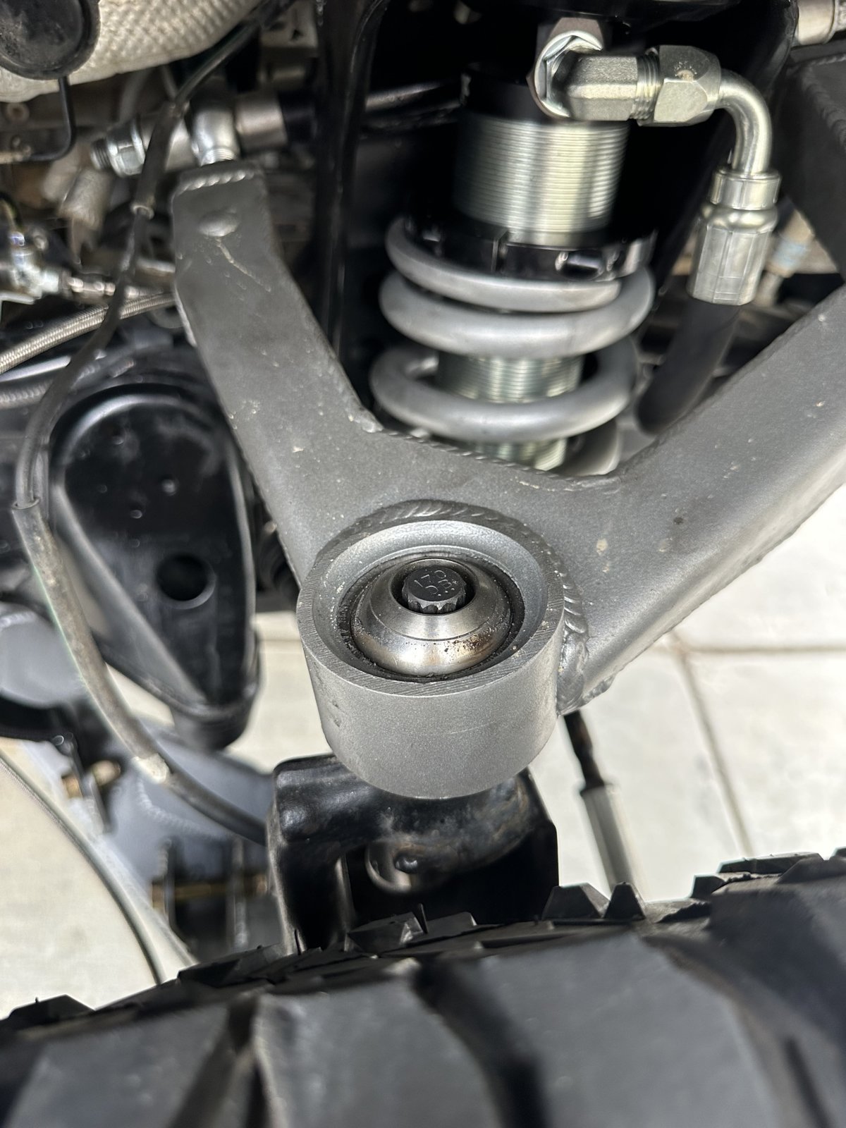

  19. Feb 29, 2024 at 1:54 PM
    #139
    trail.taco
    Jul 28, 2022
    #402379
    177
    Also have this issue. Looks like the cut out in the uniball adapter is too small for the bolt on one side only.
  20. Feb 29, 2024 at 3:12 PM
    #140
    Tcodyw88
    May 5, 2021
    #364823
    281
    Cody
    El Segundo, Ca.
    2020 TRD offroad
    Dude that’s a bummer. I’m sure they’ll mail you a good one. I would check all the uniball adaptors to make sure they don’t bind up against the uniball cup. I had one that was slightly high and didn’t allow full articulation it was catching at the edge where it’s supposed to be flush with the uniball. I just chucked it up in the drill and brushed it up against the belt grinder and polished it out.
