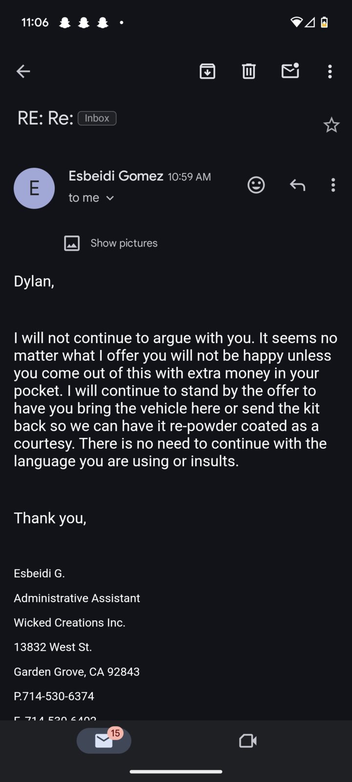

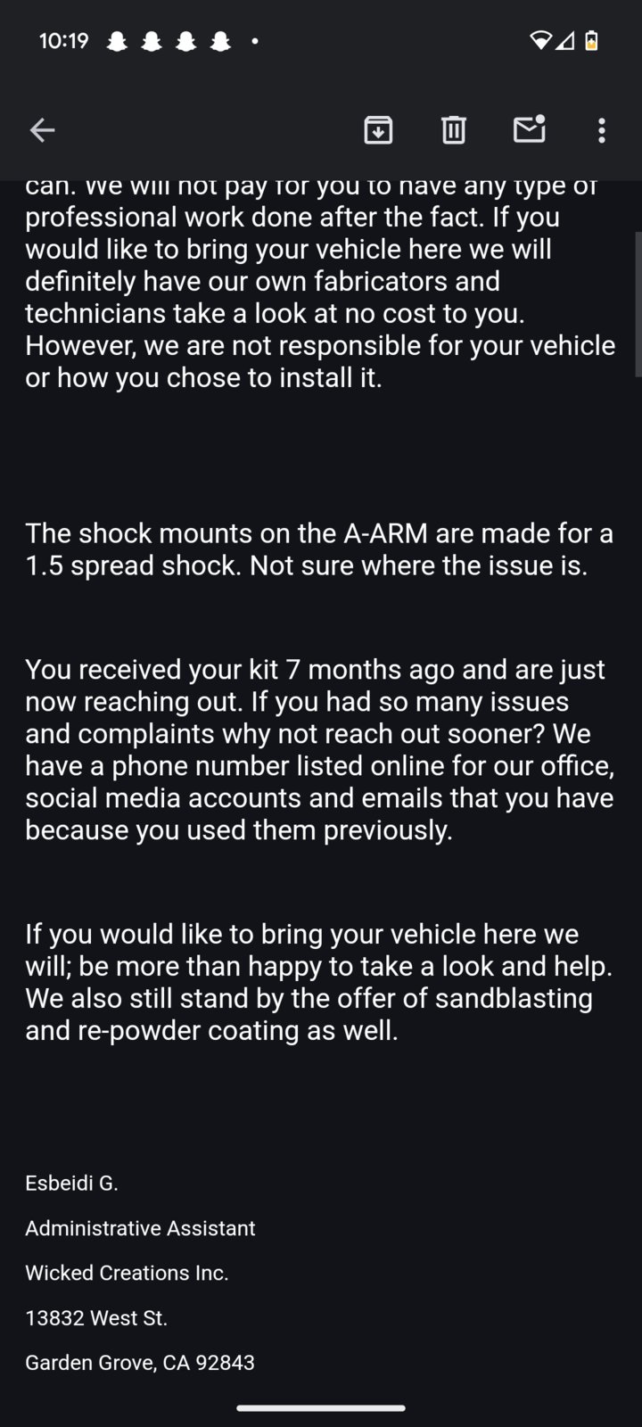

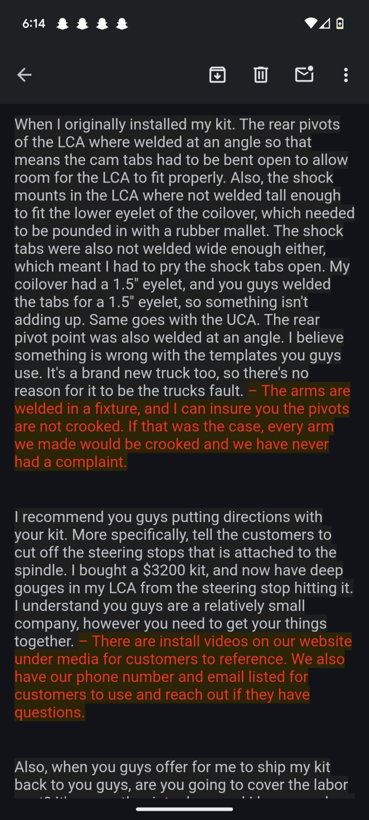

    They say no one else has had issues. @YotaFAB has had issues, I used him as an example. Red writing is their response. All because they sent me a kit with shitty coatings and just horrible fitment in general. I've sent them tons of emails in the past but I sent it through their "Contact Form" so I never actually got proof that I sent them emails

    They never responded till 5 days later until I copy and pasted the same email and they sent me an email within the hour. As much as I want to like this company, they are doing horrible as a company. Look at their reviews on Google, 2.5 stars with 16 reviews. Bad.
    And I hate to belabor this, but it's just for future customers when wanting to buy this kit

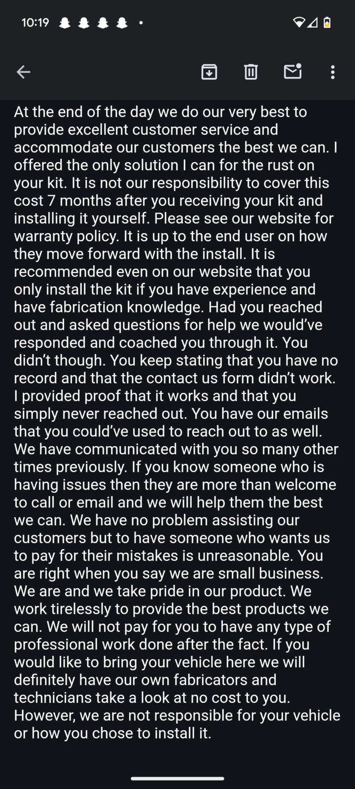

    To continue... All I said in the last email was to look at forums and reviews. They took it as an insult I guess. Didn't use any harsh language??

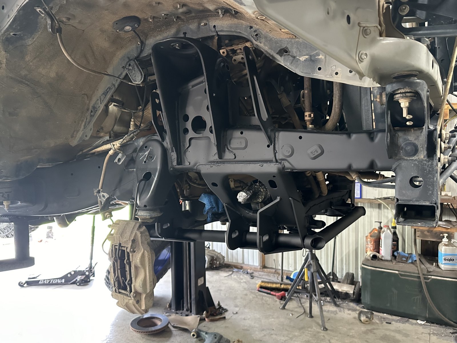

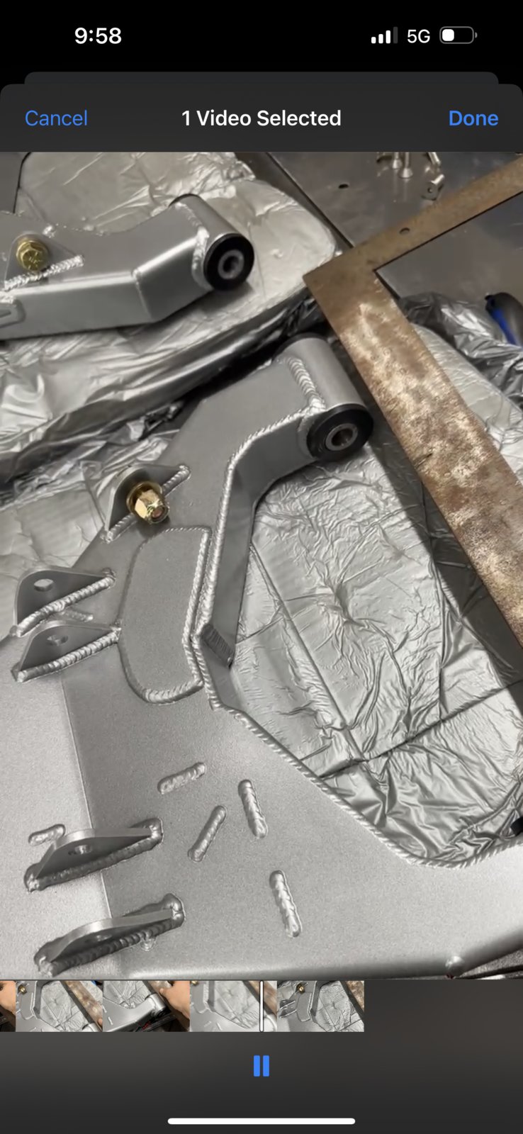

    1997 t4r has super duty axles, 5.13s locked front and rear. 3 link front with 14" kings. Rear 63s.
    One side is straight. Other side is tweaked. Called them and they are overnighting a new arm along with washers to go in the uppers due to separation when welding the uppers. Had issues with the double shear having massive gaps on the front side of the bucket.
    Both lowers have a different mounting width also which we been a sob to get in the jd fab pivot kit.

    Jd kit isn’t tweaked either. Measured out both sides. Bushing to bushing on one is 17 1/2”. Other is 17 3/8”. They didn’t get back to me on that

    Empty Wallet Mod

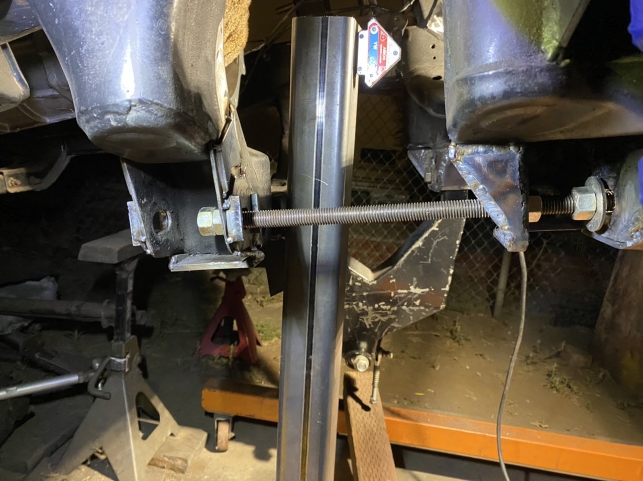

    I’d cut the outer bushing sleeve off of the control arm at the weld, clean it all up and mount it in the control arm mounts on the truck with some properly sized all thread (5/8?) all the way through the front and rear and some cam tab eliminators (333, TKO taco tabs etc) bolting it all together and try to tack it so that it can be welded out. Kind of like what I did to keep my tabs in place when adding gussets on them only instead using the idea to align the crooked bushing sleeve.
    If at least one of the outer bushings is square to the mounts, you could also make your own jig with angle iron, measure the distance, tack it, and test fit it.

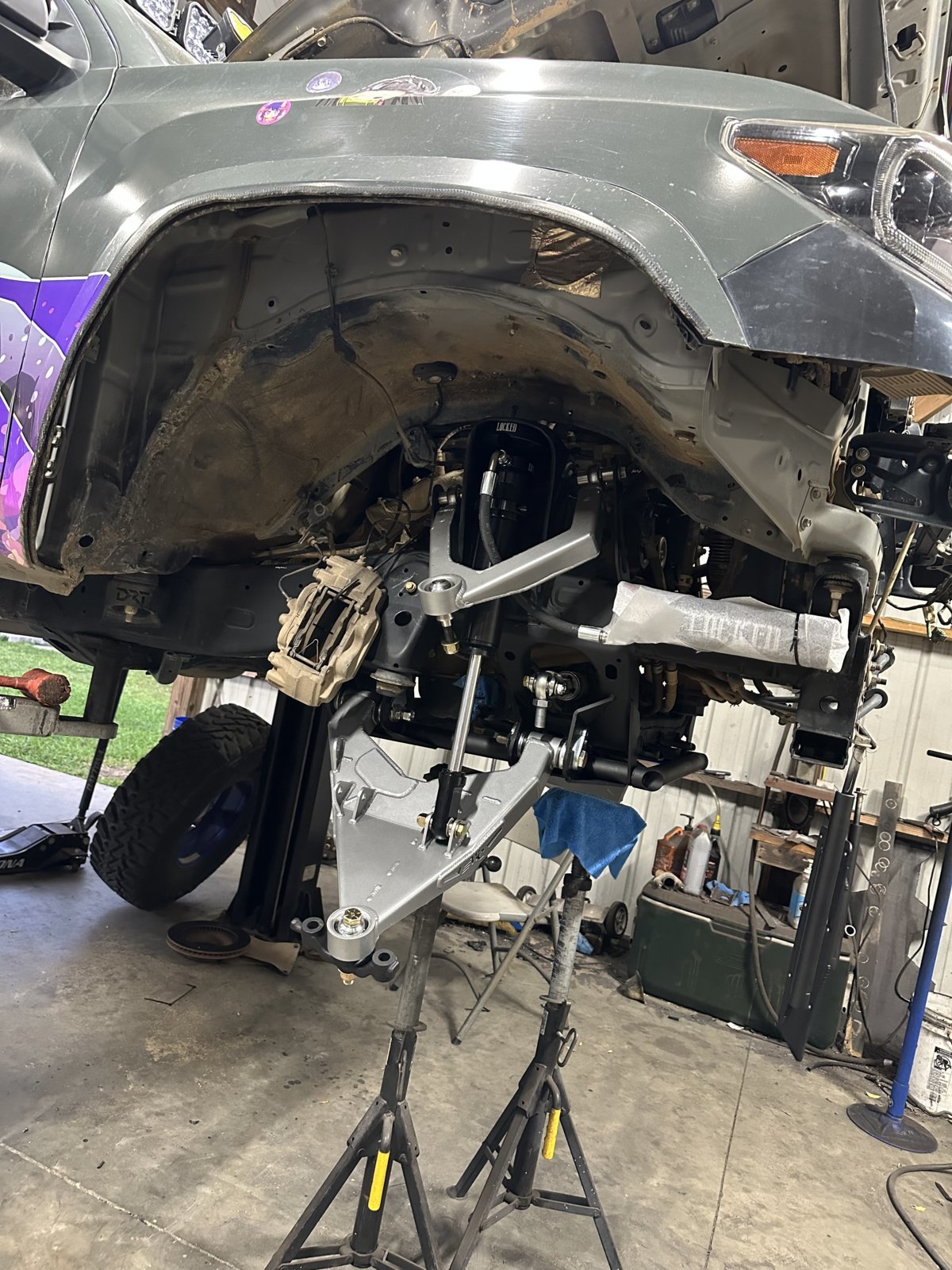

    New arm came in today. Had another job this morning so soon as I got done I put the arms in and prepped some other things.

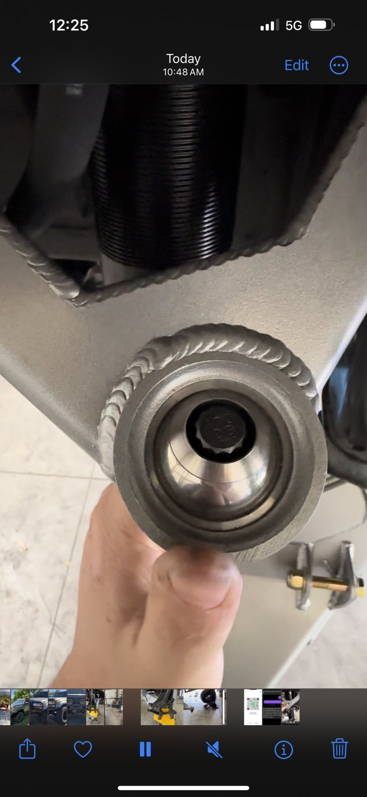

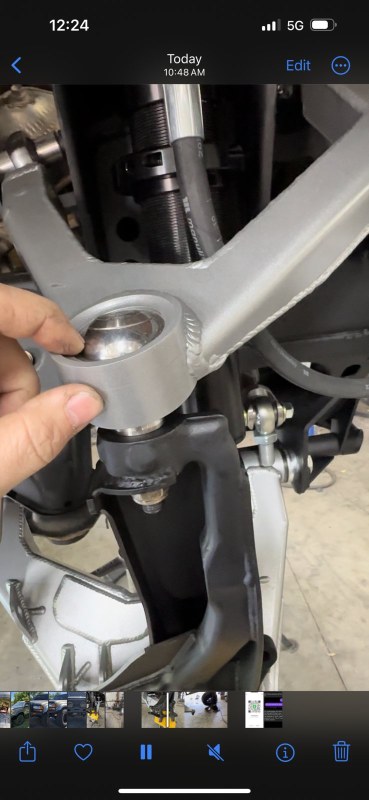

    Anyone else run into an issue with their uniballs? The upper uniball spacer for the bolt is raised causing it to hit and limit travel. Cant get the spindle in due to this issue. Sent them yet another video of the issues. Unfortunately probably won’t hear back until Monday.

  19. Mar 30, 2024 at 9:24 AM

    Not the same issue. It’s all the way seated. It’s still raised causing it to hit. I’ll have to take a picture when I get home.

    Can see from the screen shots of the video I sent the customer and to wicked
