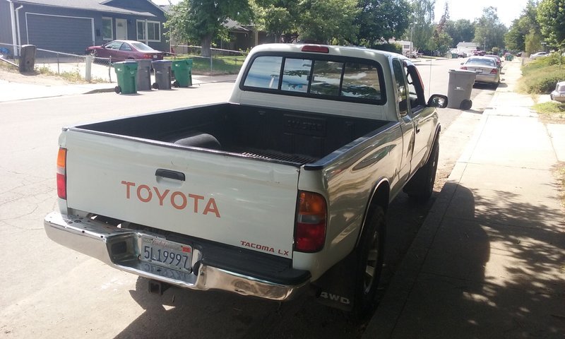

    Hi I own a 1997 Toyota Tacoma with the 2.7 which with research shows stock tire is 31x10.50xR15s. Which is on the truck, now my question is I want a wider stance (California legal limit is at the first Grove of tire away from the truck which has to line up with the fender, if I'm not mistaken. Well anyways I want the maximum i can run and staying within the legal limit. (Spacers). Any recommendations would be appreciated

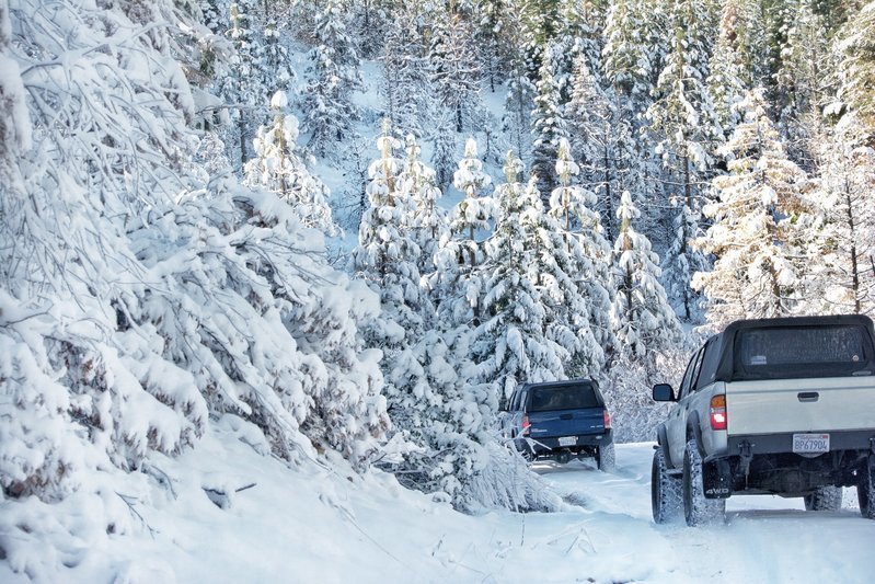

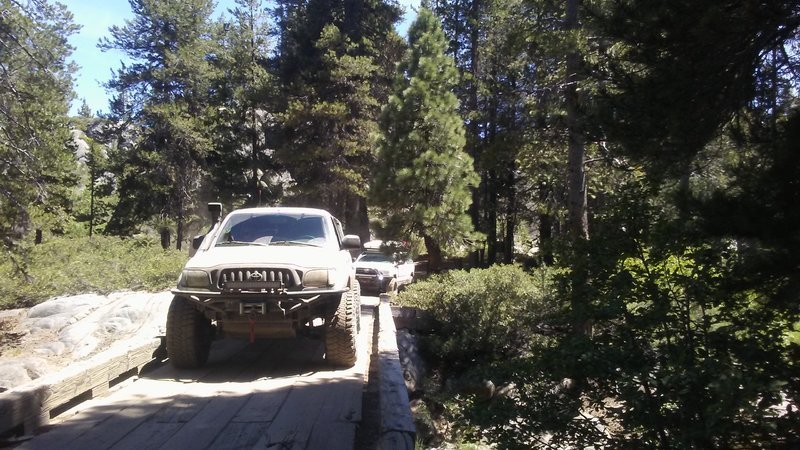

    Checkmy build.
    The pic in the snow is on 15x8 with 33x12.5 tires. The other pic is with same size tire but with 15x10 rims

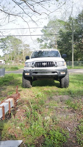

    3" Toytec spacers, Bilstein 5100s in the back with add a leaf and overloads removed.
    They were flush when I had the flares on.

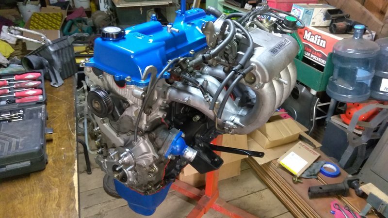

    Looking good isn't it. First motor rebuild of my own lol
