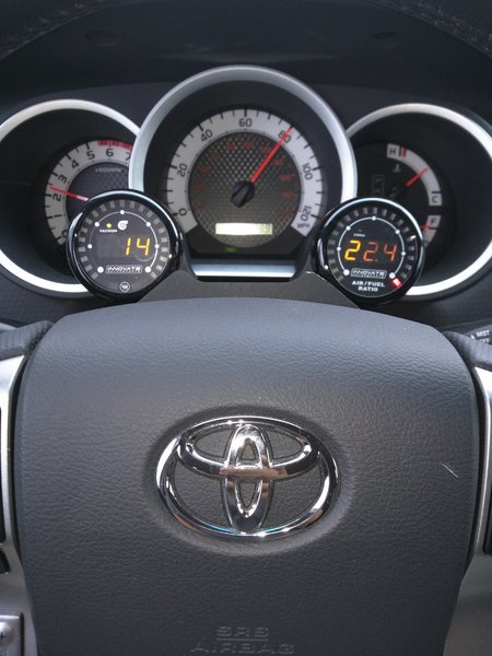

    Seem to be running super lean. Basically stay at about 22.4 on the afr gauge unless it's under boost. Not sure where he put the bung. I'll find out later today

    what? that doesn't make sense. Your AFR gauge is saying you are running at 22.4?

    Yeah. Somewhere. Somehow. Shit is screwy

    I put this in another thread but thought it applies to you
    I assumed the 22 was actually your vacuum line and you misinterpreted the gauge. That number is pure air basically.
    Test the gauge first like the youtube video. if it doesn't work then either your sensor or the wiring. Make sure you tapped into
    the correct fused line.
    https://www.youtube.com/watch?v=rmnxKLjM25g

    Do you get an almost steady reading at 22.4? Check the manual for your innovate AFR gauge and do the calibration process.
    Check where is you bung. Those sensors doesn't realy appreciate being to far from the moter.
    I see 14 on your boost gauge!

    lol...yeah, there is a 14 on there. random piece of dirt must have been covering the dot. i've never seen higher than 6 on that side. good call on the calibration process. i'll get on that one. thanks!

    Maybe it's normal to have an AFR of 22.4 at 14 psi of boost lol.

    Nailed it

    Put a piece of dark window tint over the screen

    All good. Simple calibration... Like it told us to do lol
