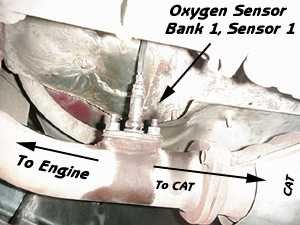

    To all of you first gen Taco owners, how did you install your wideband?
    The bung in the exhaust is made for this kind of 02 sensor.

    I just put mine in yesterday. I put my o2 bung just in front of the stock o2 sensor at about the 9 o'clock position on the pipe.
