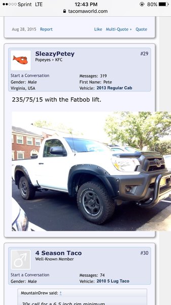

    IMG_0859.jpg It's a 2007 Tacoma access cab. Well I understand they view of width isn't what feels out the wheel well. I guess I'm just not. Wing very clear on what I'm saying. This guy right here has stock wheels with a 235/75/15 and it looks pretty good without sacrificing drive ability. I just want to know what the widest tire that would fit on the stock 2007 tacoma wheels

    Most tire manufacturers will list what the minimum and max widths are as well.
    But it looks like alot of us are running 235/75 with no problems.

    Line one of post 5.
    OP, to find that info, you won't normally see it on tire sales sites. You'll want to go to the tire manuf. site, look up the model/size of interest, and find the detailed specs.
    Also note that tire sizes are a generalized standard. IE not all 235s (or any other size) are promised to be exactly the same dimensions across product lines. Close, but not exact. That's one reason why the research per particular tire make/model is worth the effort.

    Go with 235s! unless you wanna spend the big bucks to get 31s. Also regearing may be a must if you go over 31s. Even with 31s I was considering a regear, but I have the automatic so its about the max you want to go with them, and maybe a little more then you should. I recommend 235s that will be my next tire. I do enjoy the 31s off road, but on the road its 90% driving, and I wish I had the 235s up hills.
