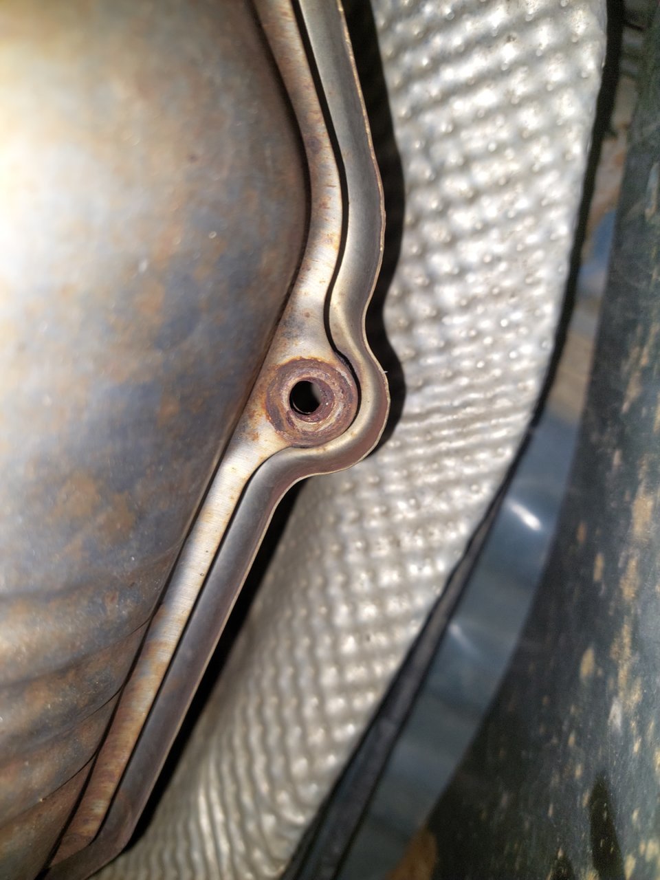

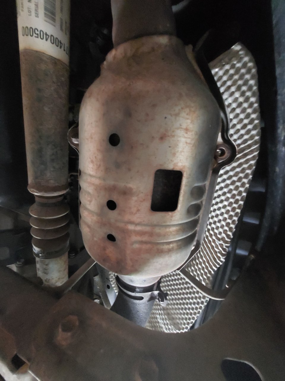

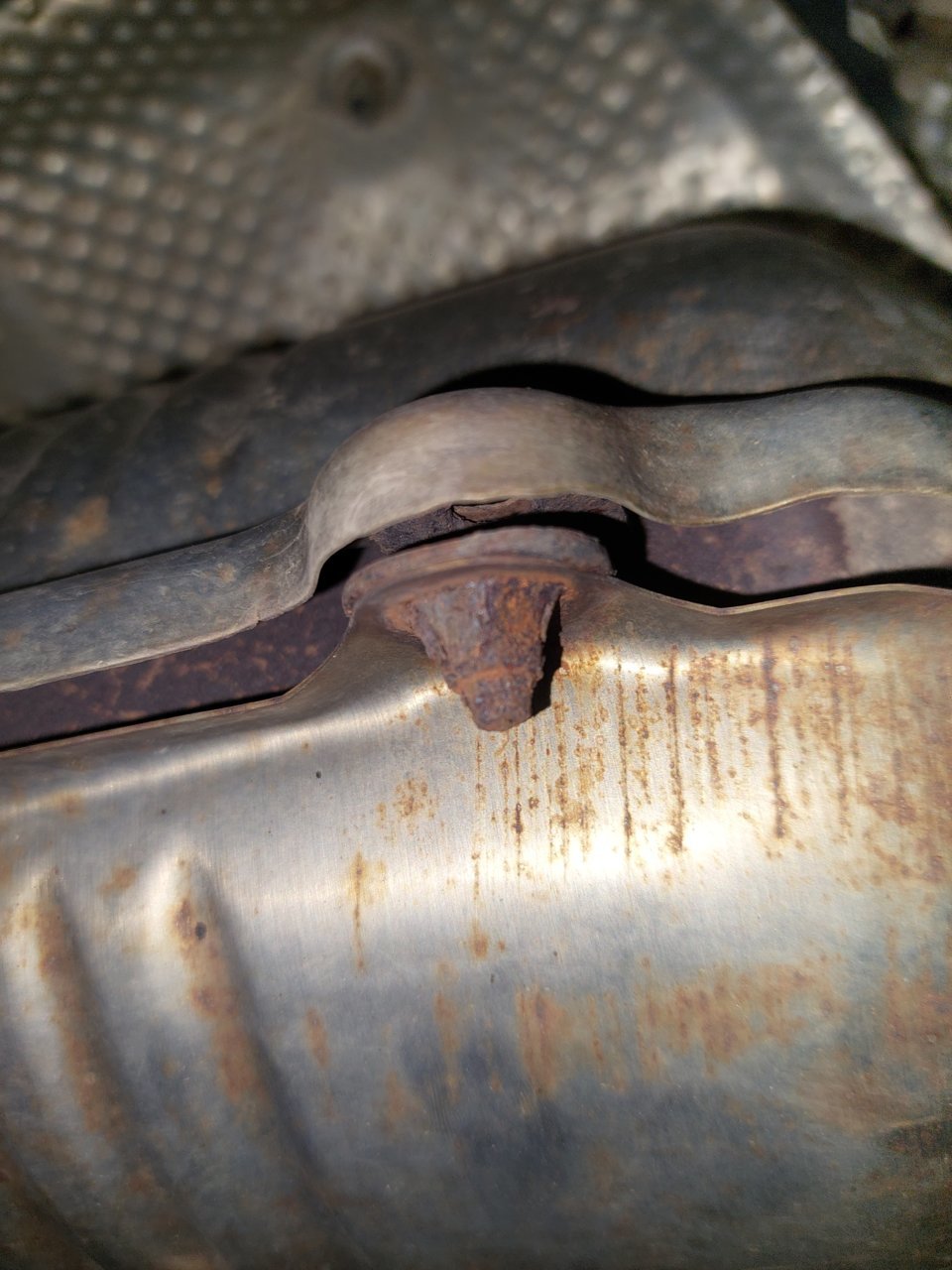

    Basically that's all that came off, no clamp, missing screw and washer and the other one is just too rusted I don't even know how to take it off

    If you put a socket on the rusted one chances are it will break off. Then replace both of them with new hardware. You may have to use a slightly smaller socket and tap it onto the nut since it looks pretty far gone.
