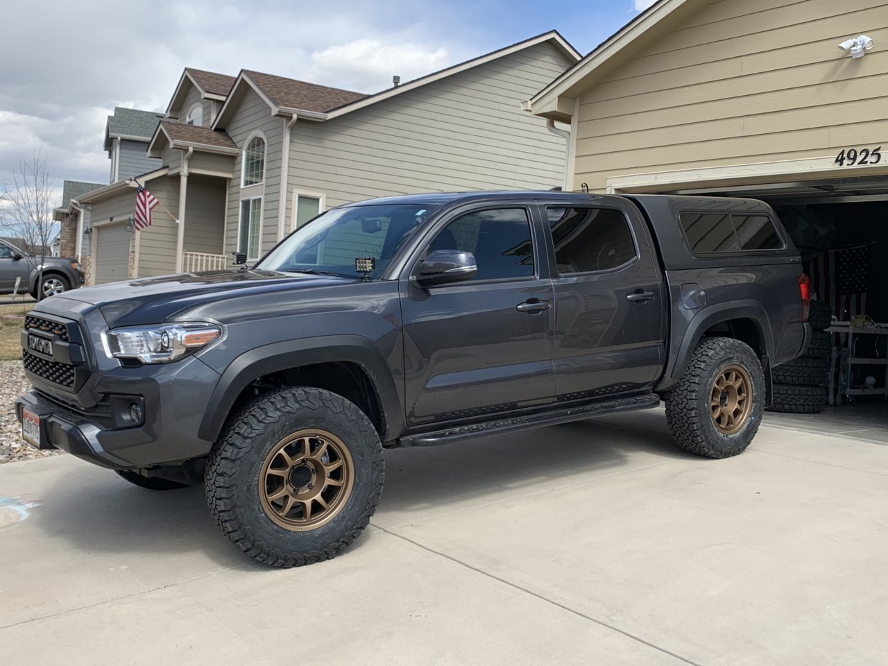

    I'm out of town and my wife called and said the front end of my 8000 mile truck locked up as she was running errands. She got to the end of the walmart parking lot and went to turn onto the road, made it about 10ft and the truck just skid to a stop. She tried to go forward and it just spun the rear end.
    Once she backed up into the parking lot she call me and I had her put in 4 low and try to get the front end to break free with no luck (thinking the brakes are stuck, rear just was spinning), but she says it's fine in reverse. So I have no idea wth is going on with this thing. I baby this thing (it's been off-road once) and like mentioned before it only has about 8000 miles on it.
    She has a tow company coming to take it to the dealer but of course it's Sunday and won't find out anything today. I'll keep ya posted what they find out in the next couple of days.
    ****UPDATE*****
    Alright, here is what you all been waiting for.
    It was the rear E-brake/brake-lines. Apparently the shop I had install the lift didn't reroute the rear brake-lines which caused them to kink/stretch enough to eventual apply the e-brake. Dealer has me for $120/line x2 and 5hrs of labor for a total of $980 plus tax.
    Yes this will be addressed with the shop as this could have ended up much differently if they were on the highway when this happened.
