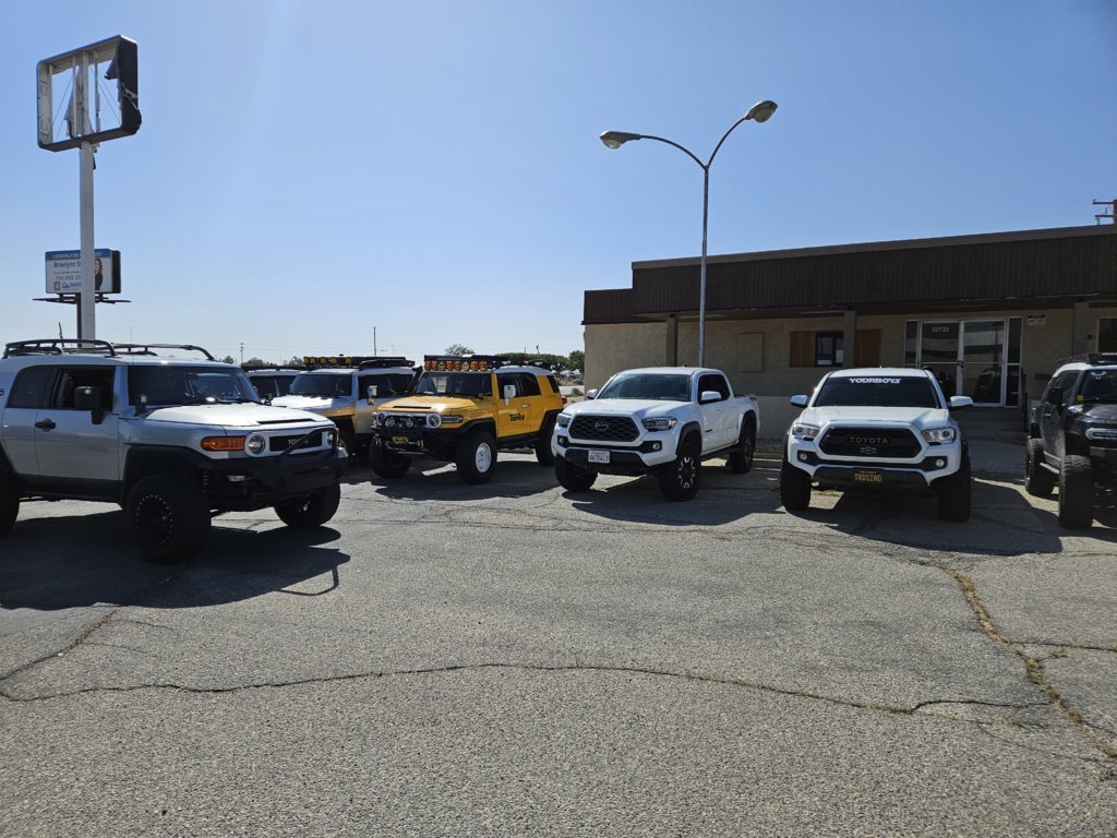

    255/85r16 gang here, they do work.
    Now if I were to do it all over again, after lift etc, I'd go with 17" rims and 35x10.5r17 Kendas.
    Lots more sizes available for + size tires with 17" rims

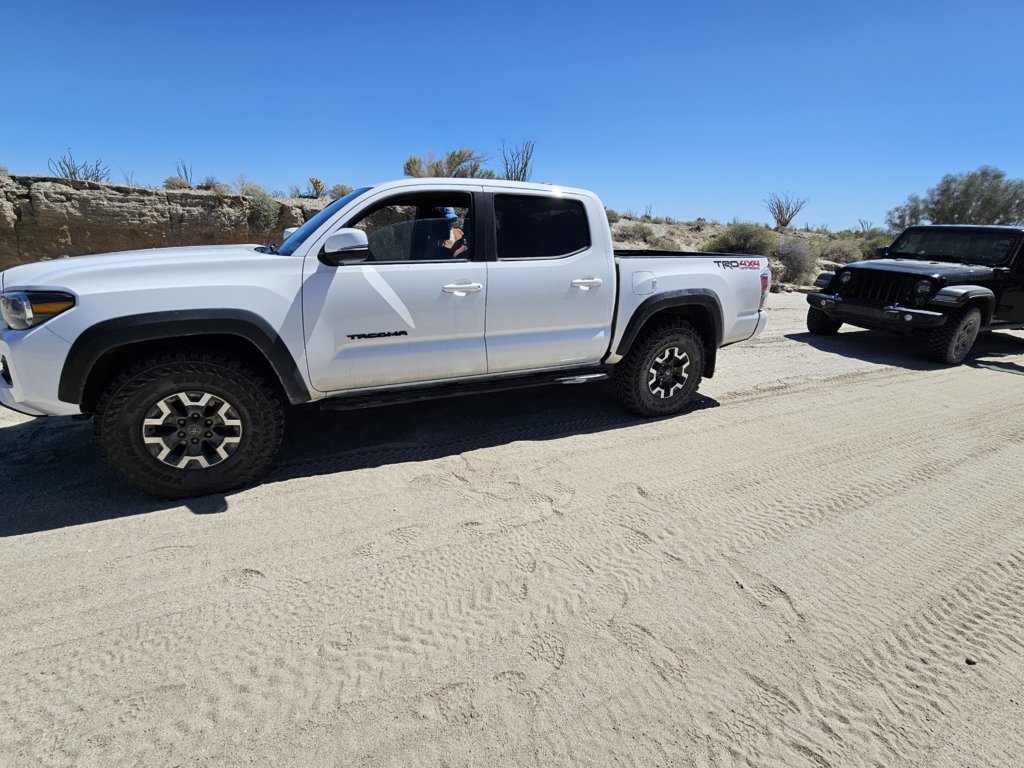

    Theres just so much space with a UCA and small lift (skinnys galore). My truck is the one who looks like he skipped leg day, but, no CMC , and isnt rubbing on anything. The other truck is on 285's CMC'd and waiting to install UCA...go with 17's give yourself options. You'll want them down the line.
