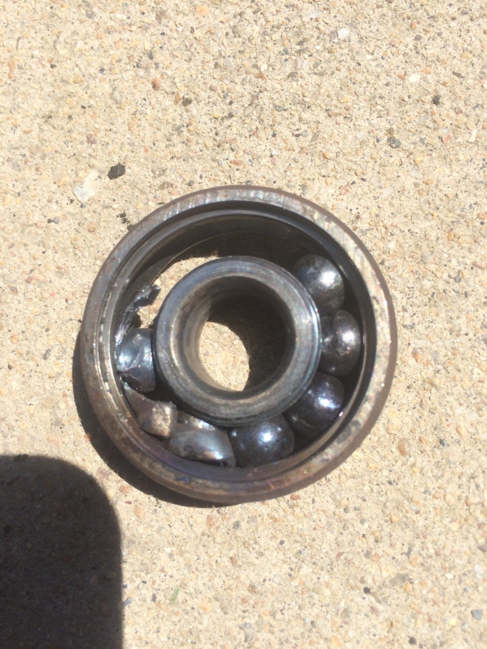

    Probably the AC idler pulley seized or exploded.
    Mine seized then exploded and shot bits of belt everywhere.
    Prior to that it happening it was squealing loudly.

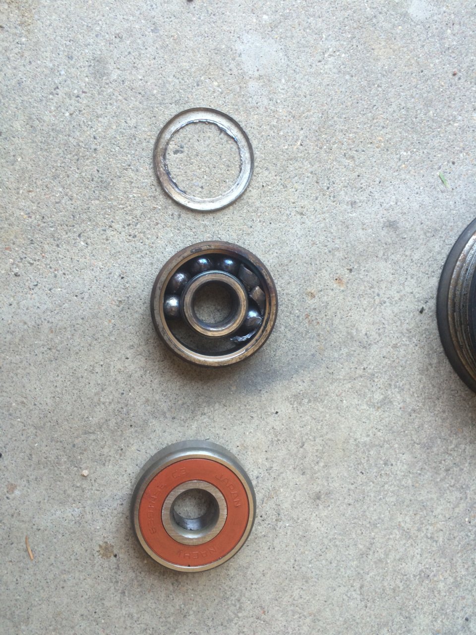

    Old OEM one is not sealed and is positioned low on the front of the motor. Susceptible to water intrusion especially if you do water crossings. You can see one of the bearings is seized and there are others that grenaded.
    New one I suggest is the Nachi one. Made in Japan and fully sealed. No issues since.

    Fairly easy. You just replace the bearing from the pulley with the new one.

    Mine was the idler pulley that did this too, not the compressor pulley
