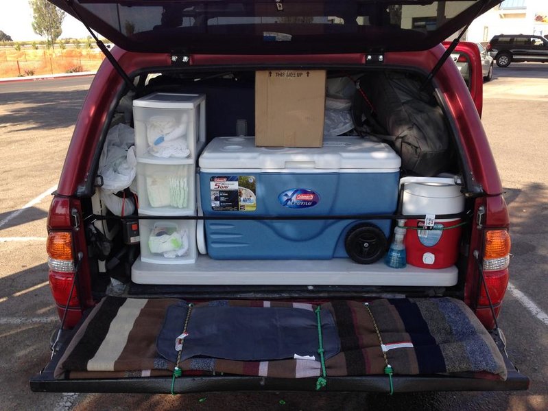

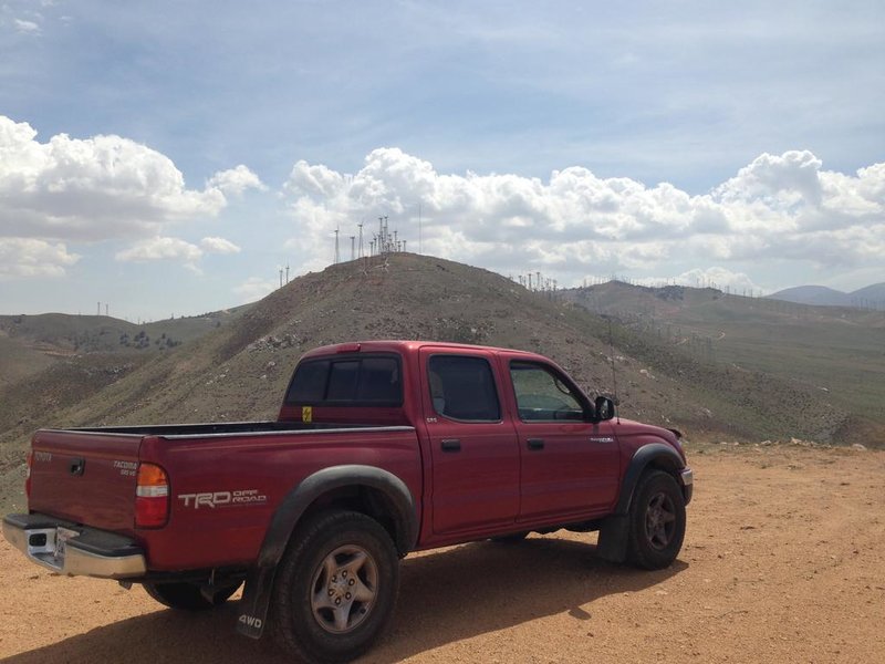

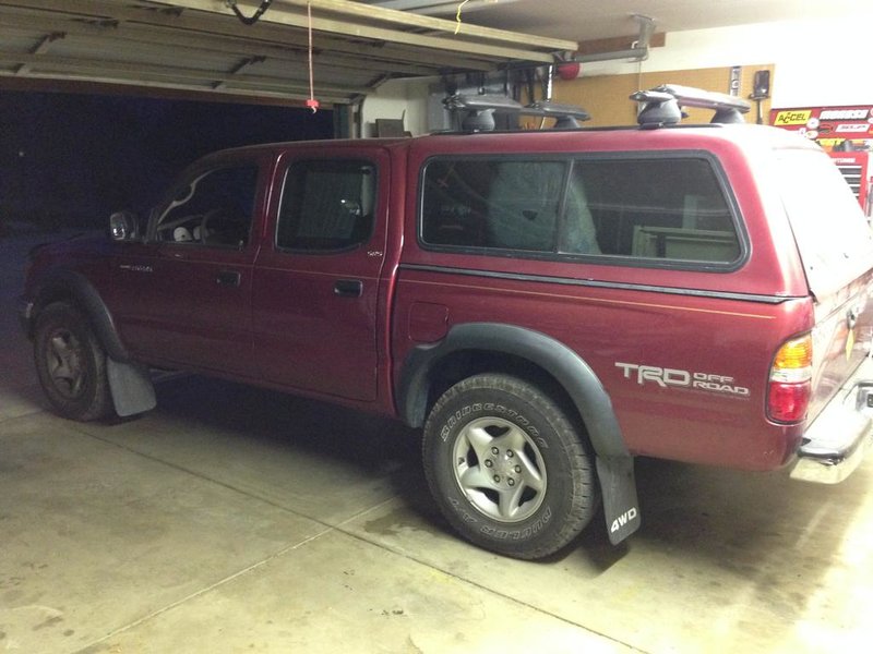

    The backstory:
    My wife and I took our 4 month old son on a 1600 mile roadtrip from So Cal to Oregon and back. Stock leafs were frowning bigtime from all our crap and the stock coil overs didn't do much in the way of smoothing things out. My son would wake up pretty often from the gawd awful bumpy ride. CFO gave me the green light...says "you should spend some $ to make the ride smoother".
    On the hunt for new leafs, front coil overs, and rear shocks. Going to leave the stock A-arms and tires. I'd like to put sliders on at some point and the truck rides with the shell exclusively now. Springs have to be able to support the added shell weight full time and be able to support the weight of all our crap on future trips without sacrificing ride quality on the highway. I'm looking at a max of 3" lift. I'd like to try an OME setup, but users say the springs are weak without the AAL. What would you buy?
    First 2 pics are loaded down, 3rd pic is unloaded.
