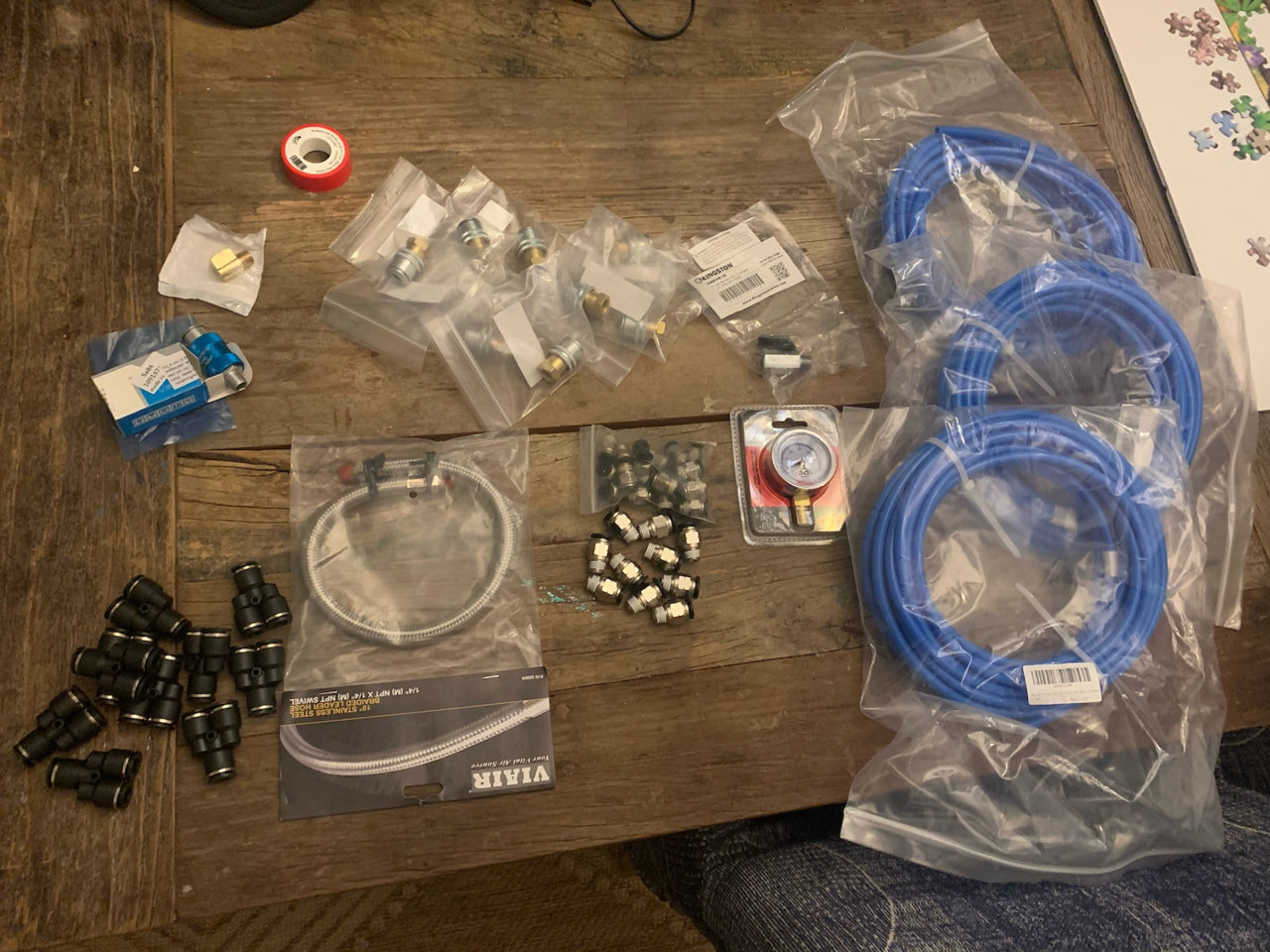

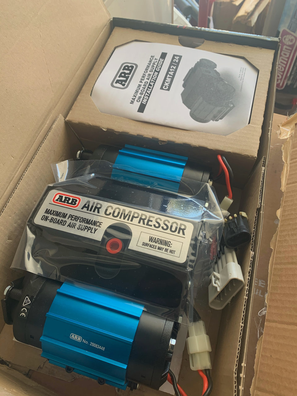

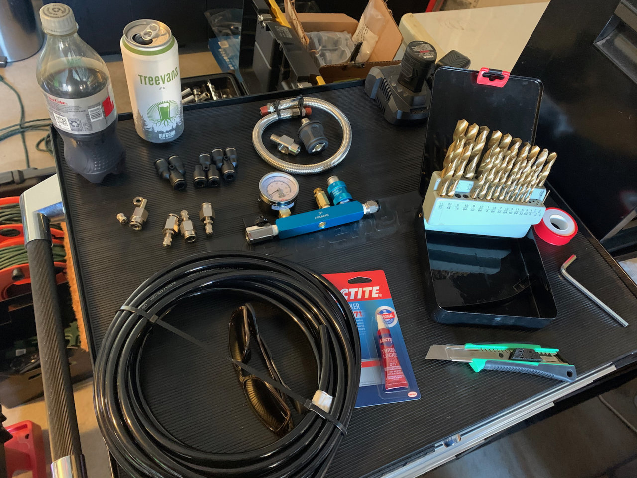

    For those interested, I'll lay out the parts info and some tips about install I learned the hard way, as well as some suggestions for different parts than what the "wifey system guy" lists out for this build.
    I used the ARB twin. You could use any compressor, but at 5.65cfm this one is 3-4 times faster than all of the other compressors I considered.
