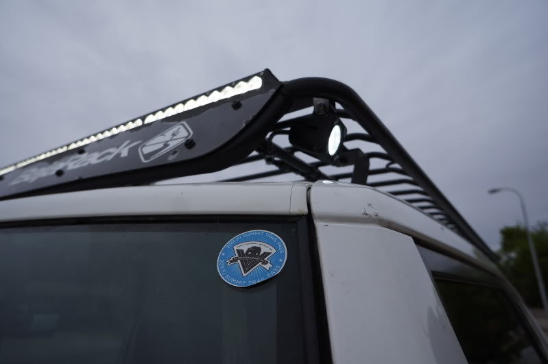

    A few upgrades

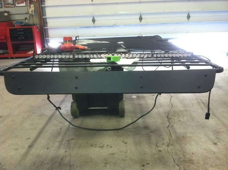

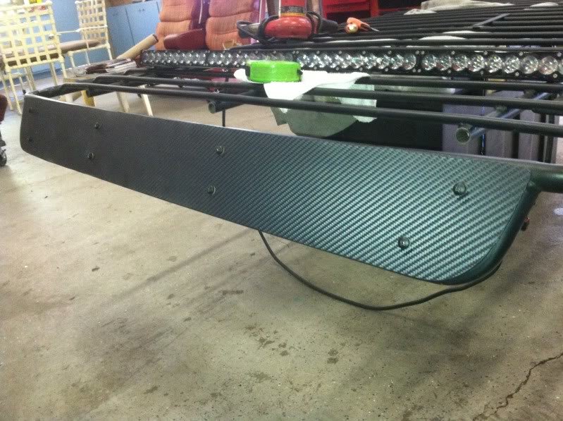

    This is the result from removing my rack, modifying it and making a little device to keep my light investment safe, legal and more stealth than it already was.
    This is the prototype.
    I am working on a drop in solution
    Click on the image for a little video clip
    Here was the in process pictures
    It required a rack modification
    One bonus, is the ability to raise or lower the light, in very small increments. If I'm blinding the drivers in front of me, on the trail, I can bring it down some. Or I can raise it, to see something up high, a hill etc.

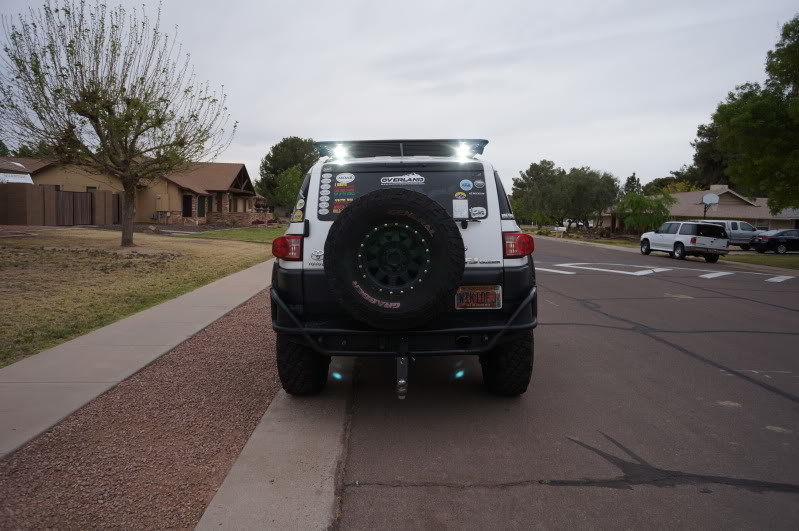

    This is pictures of the other lighting I installed during the light actuator mod

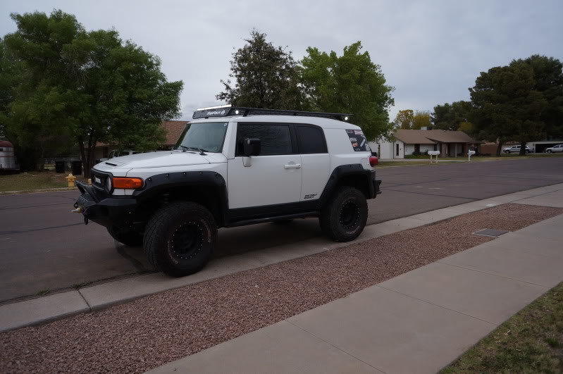

    I didn't pull the roof rack, but installed all of the lights
    I used the outer light tabs and welded a bracket to the outside frame of the roof rack, then painted it in a satin black to match the rack . It was a simple piece of 1x1/8th flat bar. The nice part is that I only needed to weld one side and bolted the other, The light position is actually perfect this way.
    It was too late to get a good shot of the mount
    same bracket and attached the front pair of 2" ers. I added another welded bracket to mount the rears, going off to the side .[​IMG]

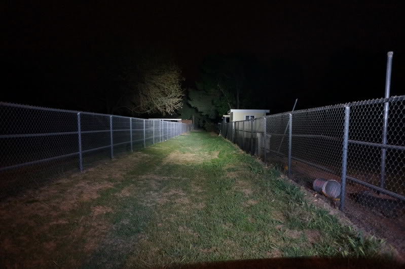

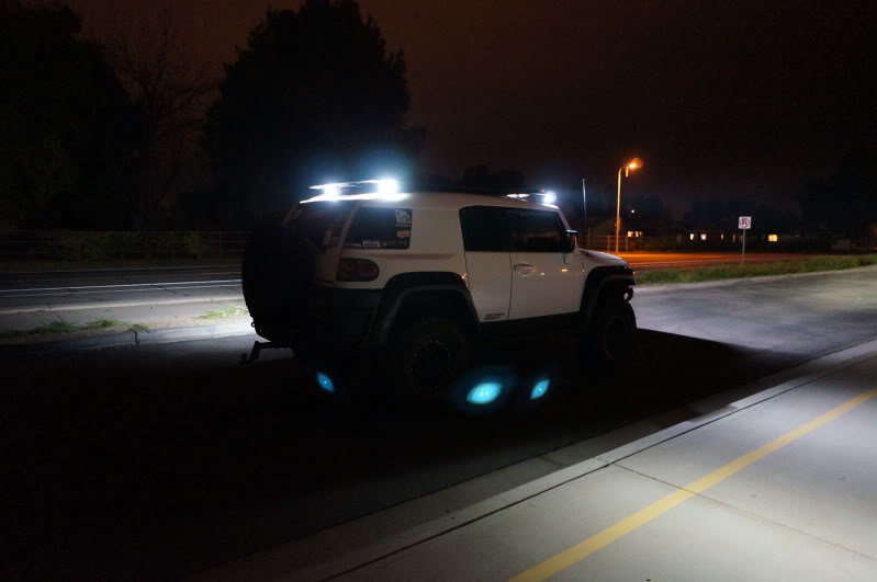

    These are the 2 in round version that puts out more light. I believe they put out 1300 lumens each [​IMG]
    The way it's wired, I have 3 circuits, each side and the rear .

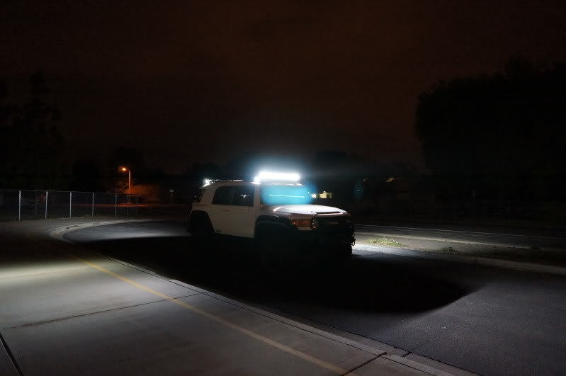

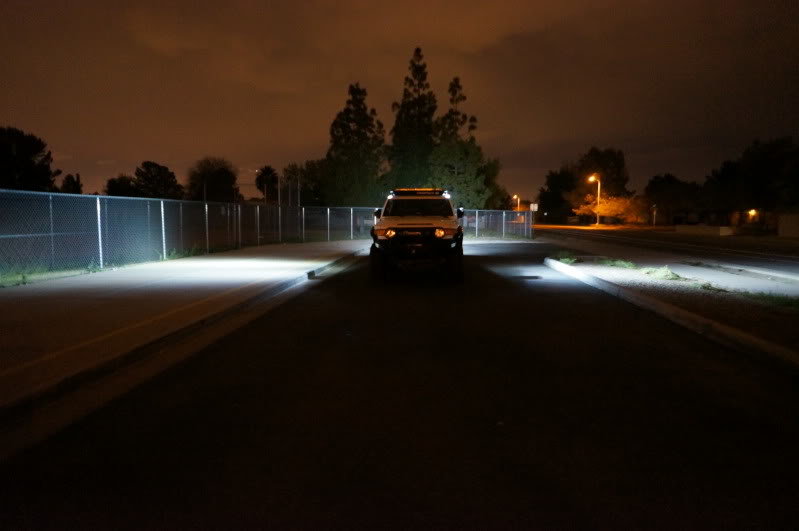

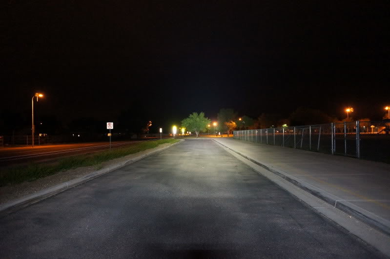

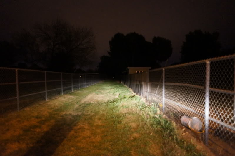

    Here are a few bad pic, night time shots
    I will need to do some aiming ,after I try them out
    regular headlights
    stealth bar
    Side lights will need adjusting , but I think the coverage is fine
    This was a really dark area
    crappy pic
    All the wiring is now ran, inside the outer tubes of the rack

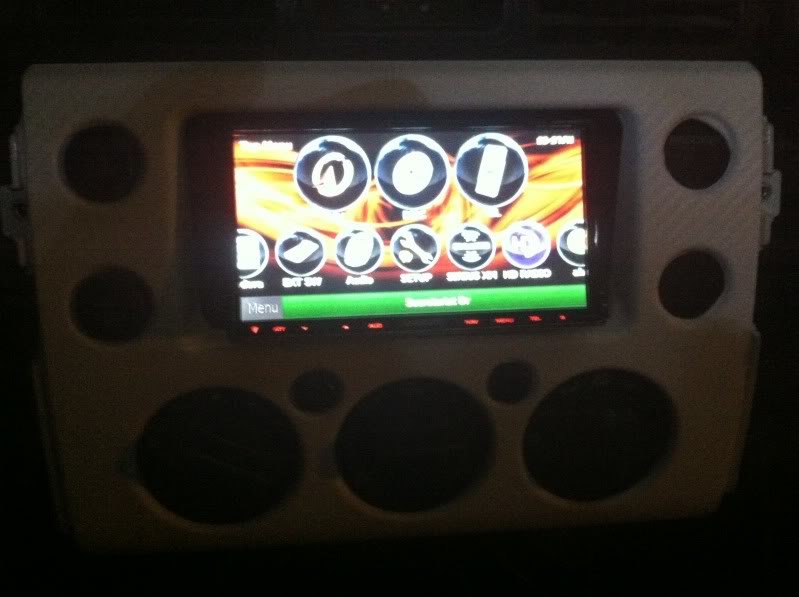

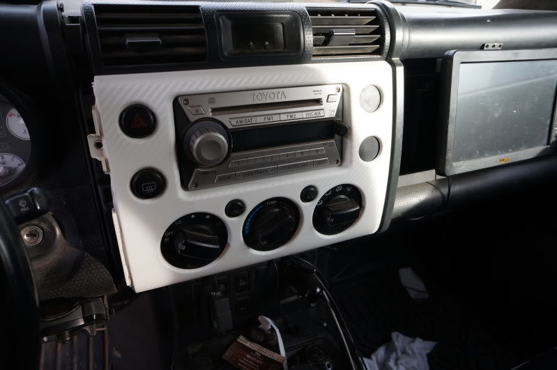

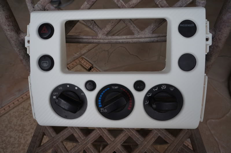

    While I was doing the stereo upgrade ...
    I Went ahead and wrapped the center console with white carbon fiber
    I think it came out pretty good and I like the that it isn't in your face.
    Here are a few pics [​IMG]
    Probably not that good of the time a day to take pics, maybe I will get better ones later .
