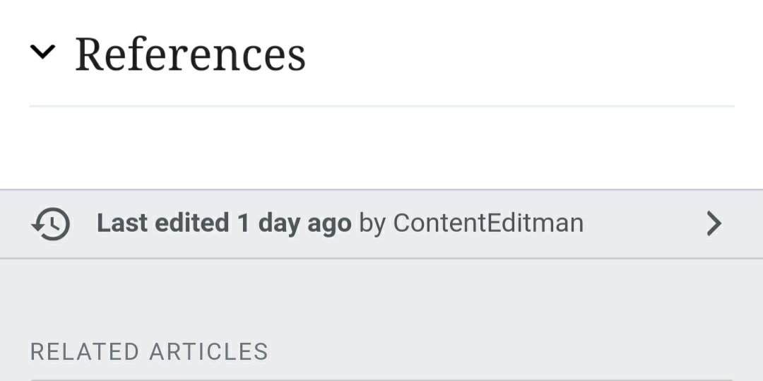

    Indy Master of all I survey.
    Sep 15, 2013
    #112518
    2,582
    Well, I clicked on the link you posted and nowhere on that page has your original quote. At least nothing the search this page function could provide. The closest I found "
    • Extended drain intervals, with the environmental benefit of less used oil waste generated"

    inwood customs
    inwood customs Roaming potato
    Sep 11, 2016
    #197024
    4,712
    Dave
    2006 v6 potato bugTuRD
    K&n, flowmaster, plastidip, chipped, hids, daves
    The power of wiki...... someone here musta had fun :rofl::rofl::rofl::thumbsup:
    I seen his quote there yesterday.
    Thats fucking comical
  15. Feb 5, 2018 at 8:14 PM
    #35
    Indy
    Sep 15, 2013
    #112518
    2,582
    So you'll trust an anonymous group of people on 1 forum instead of a group of anonymous people on another forum. Gotcha, good game plan.

  17. Feb 5, 2018 at 8:17 PM
    #37
    Indy
    Sep 15, 2013
    #112518
    2,582
    Im going to come clean. I only went fully intending to change the page but someone beat me to it :laugh:
    There's a reason that no one uses wiki as a source.
  18. Feb 5, 2018 at 8:21 PM
    #38
    inwood customs
    Sep 11, 2016
    #197024
    4,712
    Dave
    This sheeple, that sheeple...
    All the debate... then some dude just wipes it out.
    I love it!
    Did they even cite any proof?
    2ski4life7 likes this.

    inwood customs
    Sep 11, 2016
    #197024
    4,712
    Dave
    Lmfao, nope... i dont see a footnote or whatever its called with objective data.
