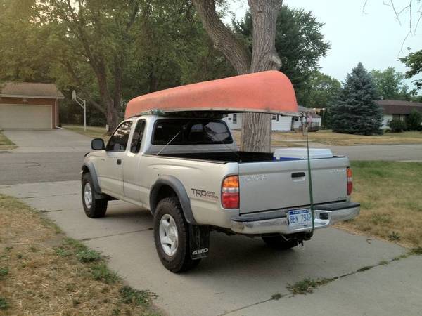

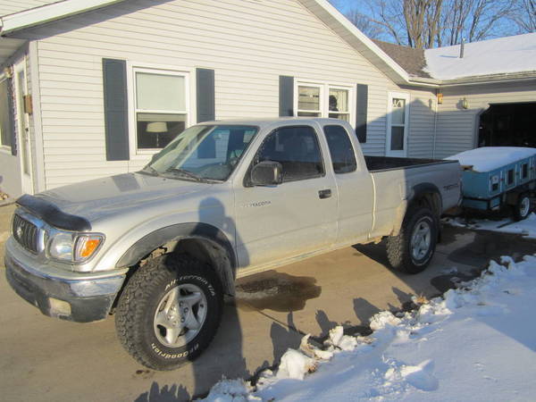

    Picked up the truck in February 2012, flew down to Omaha, Nebraska to get her. Drove it up on bald-ass BFG A/T's. Was hectic, drove up through 2 snowstorms and it was the middle of the night. Almost wrecked it half a dozen times due to drifting. The rear-tires were so bald, a small gust would break the rear-loose over the ice and snow.
    It is a 2002 Tacoma, 4x4, TRD, SR5, Xtra Cab, V6, Manual Transmission and manual transfer case. Silver color. 90k miles on it. Frame and body in beautiful shape. Body has NO rust or blemishes. Frame had a TINY amount of surface rust on the rear-shock attachment points.

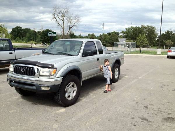

    When I brought her home (Don't mind the dog trailer in the background):
    Currently:

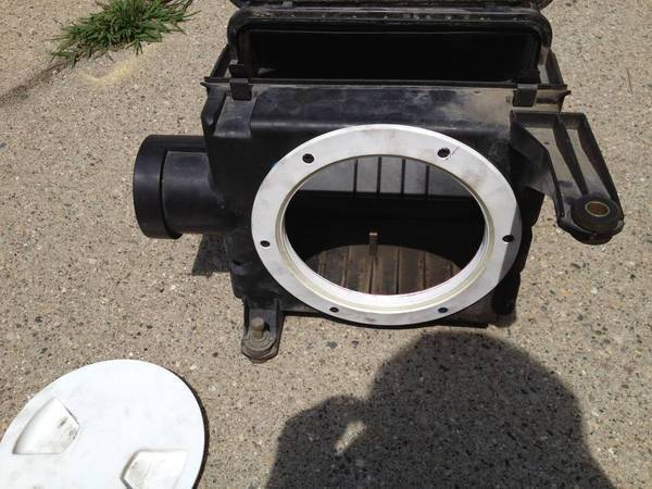

    Did the deckplate mod, used a 6" deckplate from West Marine. Installed it with sensor-safe RTV sealant and some drywall screws. I retained the stock silencers on the intake, for now.
    That really opened her up, noise and a decent power gain.

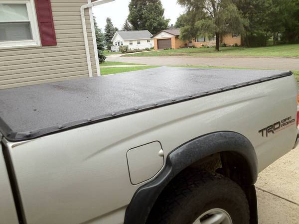

    Lastly, quite recently, I bought a soft-Tonneau cover from a gentleman. Perfect condition, $60. Installed it, and it looks quite nice. Should protect crap in the bed from rain and sun.

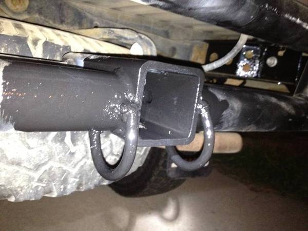

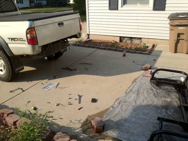

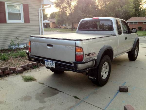

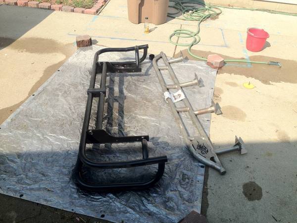

    Got the sliders and rear-bumper today, so I decided I would tackle the easier of the two. I installed the rear-bumper.
    Rear-bumper being painted with one of the sliders next to it.
    Out with the old....
    In with the new!
    My sexy helper (just a friend!)
    Now, I still need to put a second-coat on that bumper, and mount the license plate onto the tailgate, which will involve some wiring for new lights and such, unless anyone has a better idea? It can't cover the hitch-hole, as I use that on an almost daily basis.

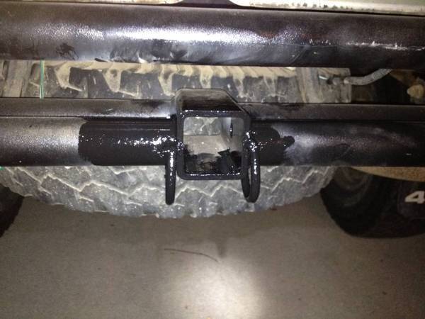

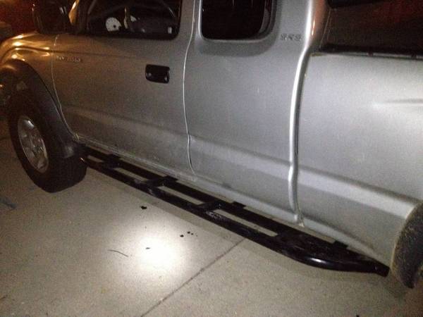

    Alright, finished up painting the sliders, decided to weld them on. The good news and bad news. Good news is, they're on! And decently solid, two grown men jumping up and down on them and they're fine! Bad news, however, is that these weren't quite an "exact" fit to my frame. The front plates on both sides have about a 1/4" gap between them and the frame. And the cool little "Trail Gear" flame pattern had to be installed on the rear, instead of the front, due to the positioning of the legs, plates, and my frame.
    My solution to the very front plates is to slide a piece of raw, flat steel in there, and then weld them all up, frame, steel, and plate, all at once. That should make it be just fine.
    My welds weren't pretty, or perfect, but *most* of them got a good toe-in, and she's staying on. I didn't buy these for rock crawling, so they shouldn't ever have to hold the whole truck up on their own. Now, I just need to do some touching up, some scrapes and scuffs that happen when installing.
    I also modified the rear-bumper, and put in some hoops to clip trailer-chains onto when hauling a trailer. Because I do that....alot. Also, I ordered a 12" drop ball-mount, as that is what I will need when all is said and done. Why did Toyota make the butts so high on these things?!
    I'll be taking the whole rear-bumper off and giving it another good coating of paint....probably Monday. Not sure, yet. Until then, it can look a little bit like butt. I don't care.

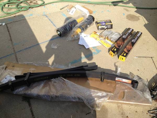

    Well, look at what Fed-Ex had sitting in their Lansing warehouse waiting for me!
    882 coils, Nitrochargers all around, Dakar leaf-pack, larger and new U-Bolts, and Diff. Drop.
    This oughta keep me busy this weekend. I also relocated my license plate to my tail-gate and wired in some lighting for it. Waiting on the JB-Weld to dry before I get some pictures.
