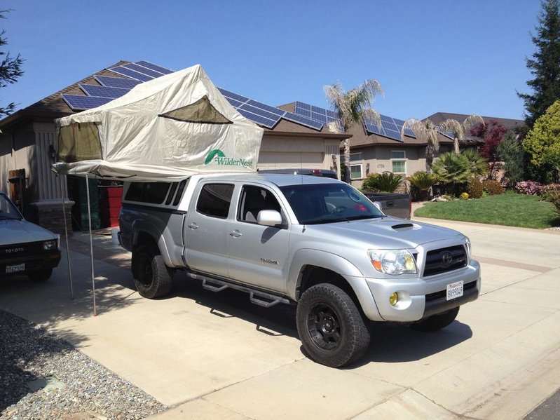

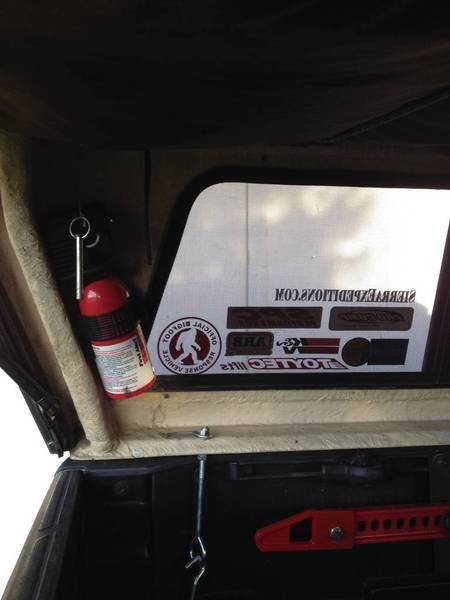

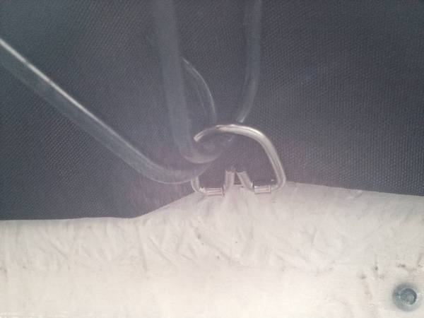

    These are amazing if you can find them. I chose to paint mine with Rustoleum bedliner spray and its holding up well. I mounted picture hangers to pull the guts of the tent up so it wouldn’t hang. I also mounted a fire extinguisher to the rear using self tapping screws.

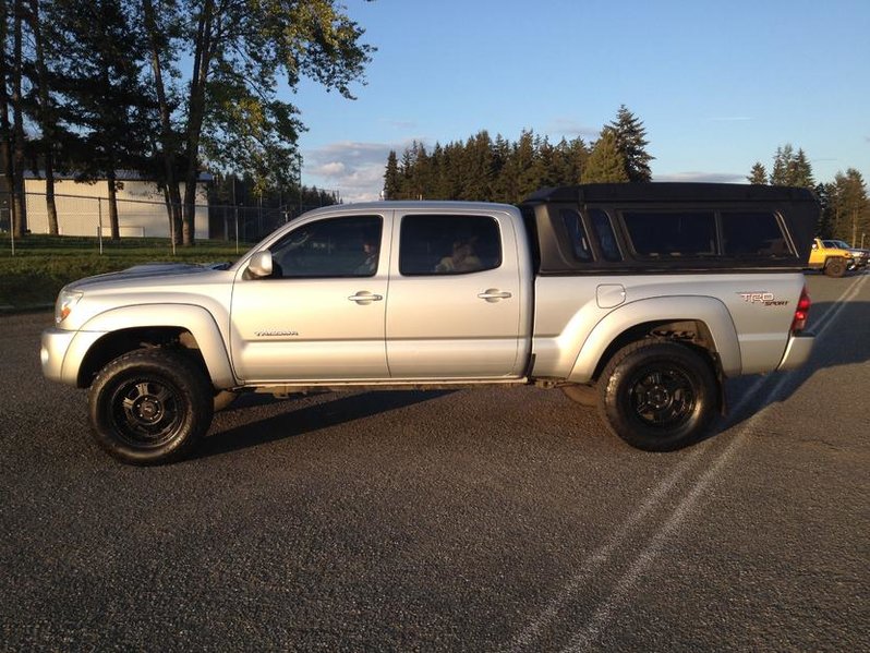

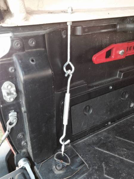

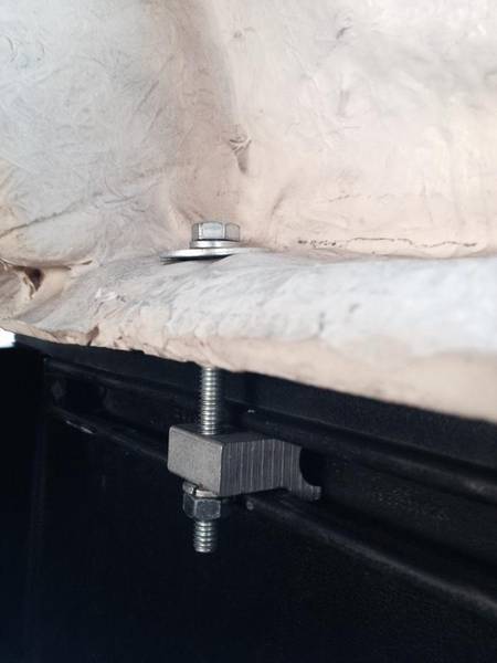

    Well I have it mounted using turn buckles at the bed D-Rings forward and aft I also purchased some hardware from a shop the sells tonneau covers. The hardware slides into the rails where the cleats are. It took a bit of work but everything is very secure and stable. I can't wait to paint it should be fun. I'm going to go with rustoleum bedliner.

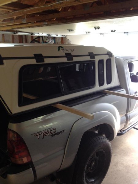

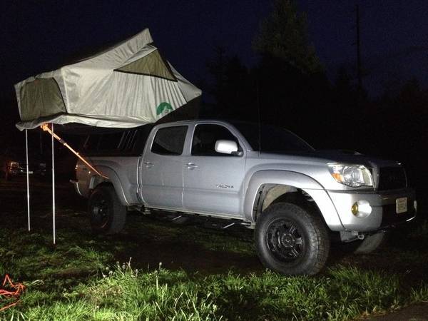

    Setting up the pulley system used 2x2 so I can feed line through. I grabbed 2 pieces of line and tied bowlines. Then I had 4 cambuckles rated at 200lbs. I placed 4x4s in the overhead above the A-Frames for additional support.

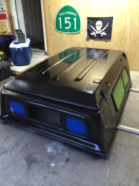

    I washed the canopy with a mild detergent then let it dry. I used rustoleum paint / primer with 02 coats then let it dry for an hour or so. Then I painted it with rustoleum bed liner spray. I came back the next morning after 8hr and it looks mint. I cant wait to reinstall should look pretty sick.
