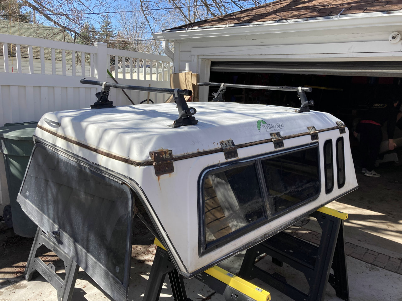

    Saw a thread like this, but never got finished so I'm making one! Just picked up a Wildernest Camper in salt lake for a good price and am planning on restoring the whole thing and replacing my current canopy with it! Things in decent enough shape, not too much rotting and doesn't look like it needs too much fiberglass work. Today just cleaned off the outside pretty good and planning on replacing the hinges and the bulb seal sometime soon.

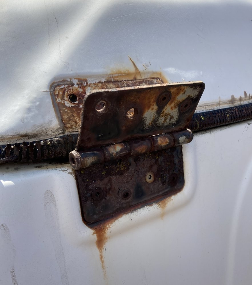

    First issue we've run into, 3 of the hinges function fine right now but one of them is halfway removed and we can't remove the hex bolts. We tried an hand held tool and no luck, so we are gunna try letting it sit in some WD40 and try an impact tool with a hex attachment. I'm new to all of this, if anybody's got any suggestions feel free to let me know.

    I'll try it! I got a tip to try a drill first with a hex-bit attachment, maybe try an impact drill, and then if nothing is working might try a 1/2 in rachet with a large bar and try to get the right torque to crack them. Honestly, rust stains weren't that bad coming off, wire brush did the trick I got most of them out.

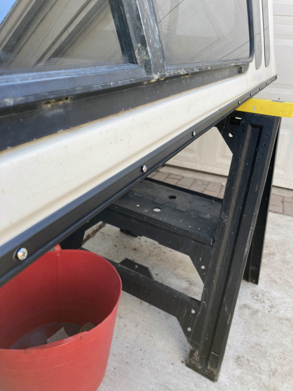

    Spray painted the metal trim and I'm slowly replacing all the screws with stainless steel. Trying to figure out the best sealant for the screw holes, probably will go with silicon as I've heard that's the best thing to use. These hinges are a real PITA project for me, we got the correct size, they are 1/8in hex, but still no budging from them. I'm going to coat em with PB blaster today and wait a few days and try em again.

    Don't go too apeshit on those hex bolts. Otherwise you'll either snap the head off or round it out.
    Have you checked on the inside of the topper to make sure there aren't any nuts on the backside?
    Could also try a bit of heat on them as well.

    Kroil is the best penetrating oil I've found for rusty/stuck bolts. Far better than PB blaster, etc.

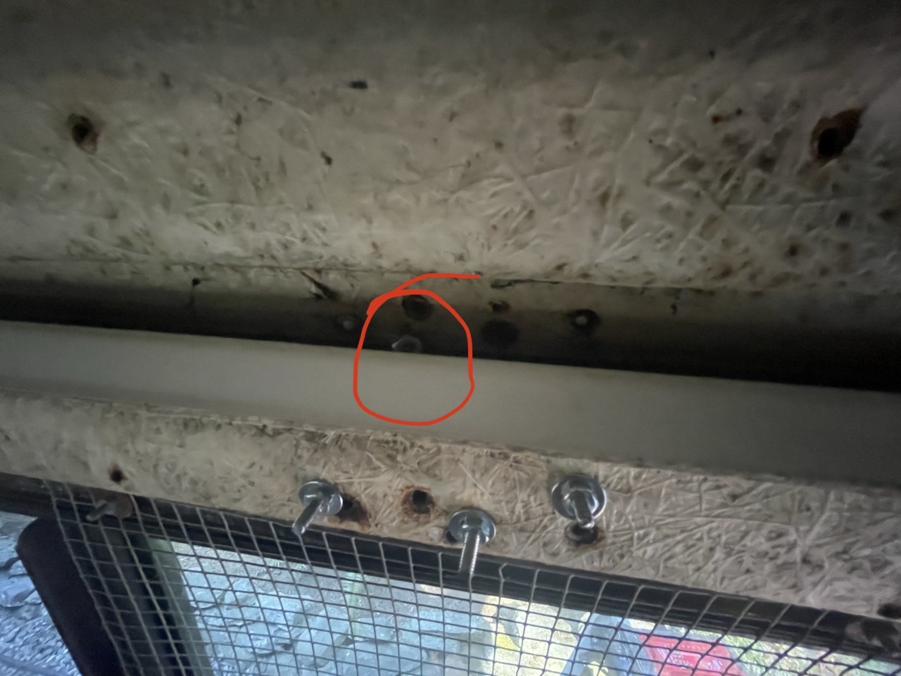

    Hey dude, how did your replacement hinges go? My hinges are a real PITA and I can't seam to get the nuts on the bolt on the top half of the hinge (see Pic) I'm finding that there's not enough room to put my hand in there, any suggestions?

    I've had a Wildernest for about a year now and done lots of restoration on it. What kind of metal trim is that? I'd like to replace my old one with something like this.
