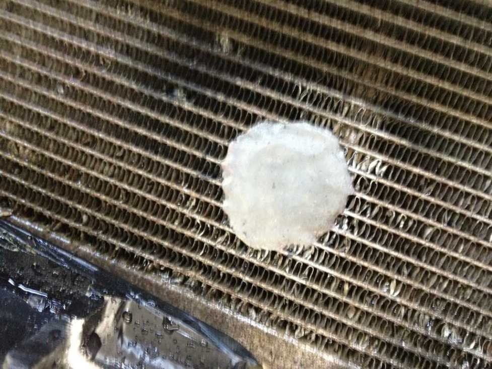

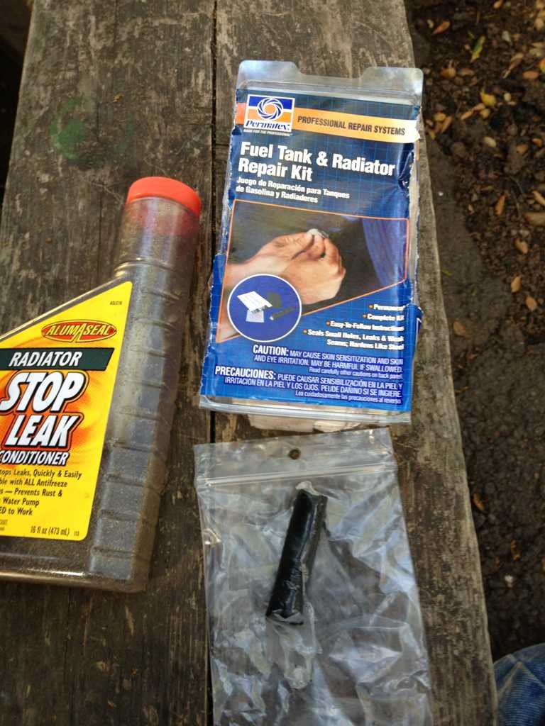

    a693581d-5a97-c1bd_ee463051b1039718dd75a975484eb5336e5a4f75.jpga693581d-5aac-dea1_208b4c6970c267dd62e7f417d21cafaf6b0ffddf.jpg
    Today while I was working my bumper accidentally poked a hole in my radiator
    So I used that puddy or black stick looking thing in the second pick and then I put it were the hole was it was a small hole but I put a lot of puddy on it and pushed it in so it would plug up the leak and wait 2 hours for it to dry.
    Then after all the fluids drained I poured some of that stop leak and new radiator fluid and gunna test drive it right now to see how it goes

    So far so good the patch seems to be working I'll keep updated on this and hopefully i don't have to buy a new radiator

    It was pencil tip size and I over did it on the puddy so it stays on so far so good but off roading I don't think it would hold because the vibration
