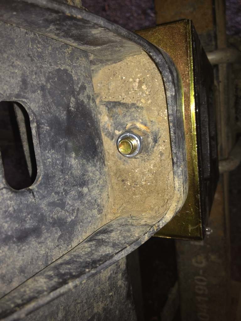

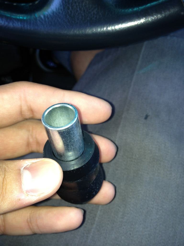

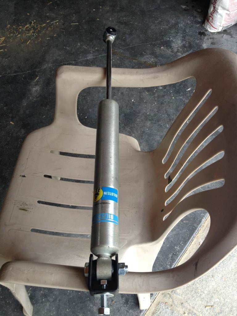

    Kings bruh

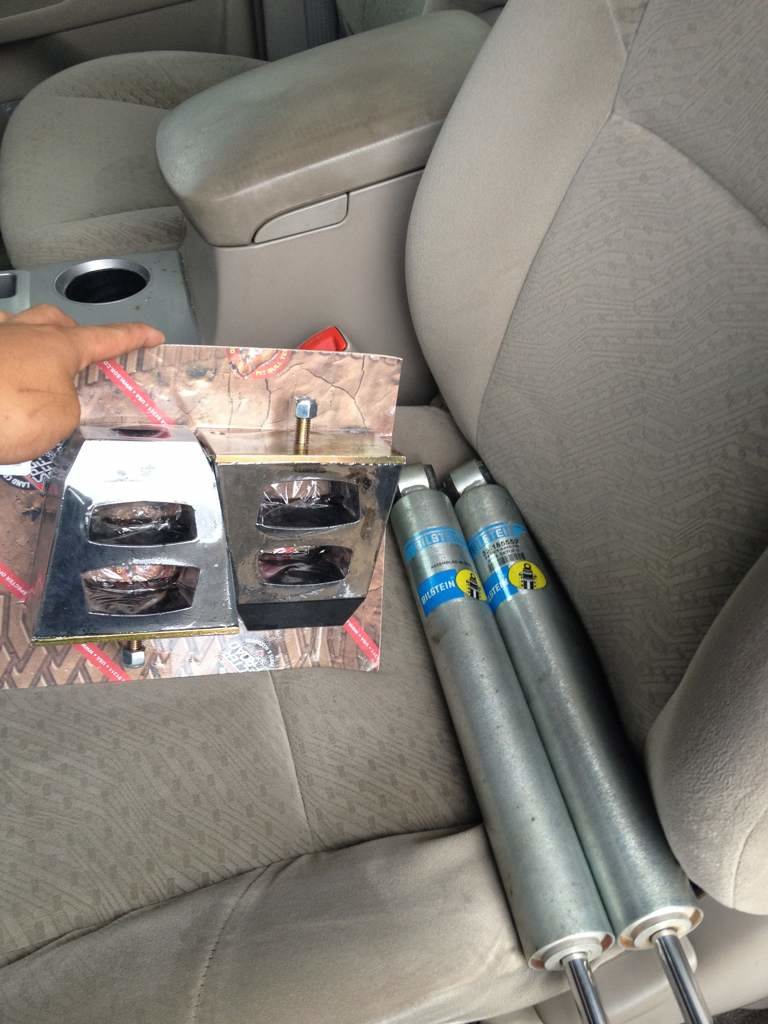

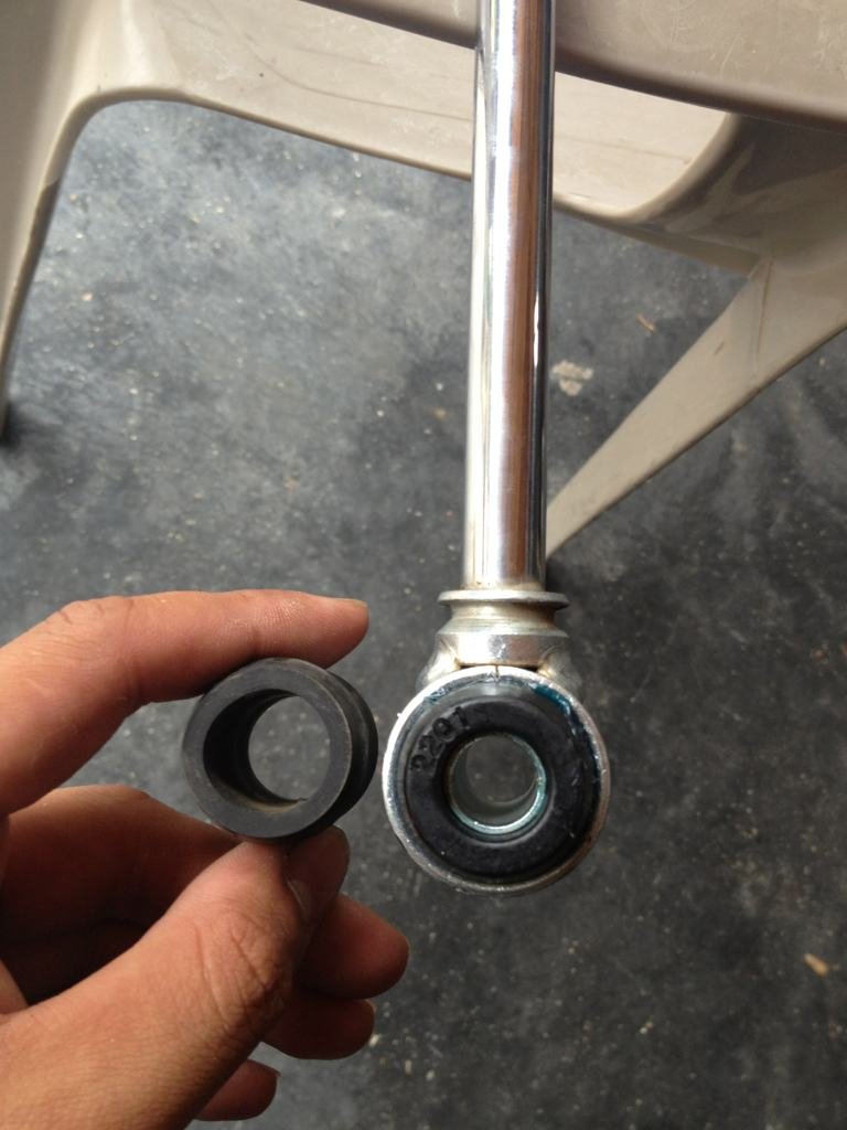

    Pics of some 5125 that. I just got off a first gen. This the process of fitting first gen. Shocks too a second gen you have to get new 5/8 bushing it's easy to take out the old onejust hammer it out and then you'll need the eye to Stem adapter there yeah go I you got an question just ask

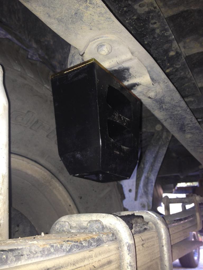

    You might like the bumpstops there 4 1/2 inches tall and just drill hole on the center strike pad on the frame and then cut the stock one off I'll take a pick right now
