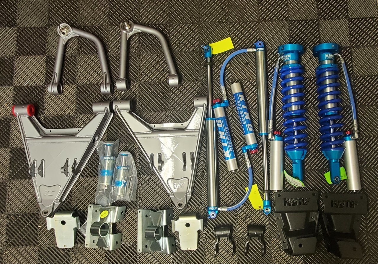

    Ok, so now that the boring stuff is out of the way let's get to the build. I wanted to break this build into 2 parts, I didn't want to one of those people that starts a build and 4 years later it's still sitting in my garage. So I went all out on the front suspension and will back half the rear in a year or 2.
    Front suspension:
    King 2.5 coilovers with adjustable resevoir
    Total Chaos +3.5 long travel kit
    Total Chaos weld in spindle gussets
    Total Chaos lower gussets
    Total Chaos front cab chop
    Total Chaos upper control arm gussets
    Spidertrax +1.25" front and rear spacers
    Rear suspension:
    BAMF rear shackle and shackle mount
    BAMF rear shock relocation
    King 2.0 bump stops
    King 2.0 +2" smoothie /W adjustable resevoir
    AllPro +3" rear leaf springs
    Kartek custom assembled limit strap kit

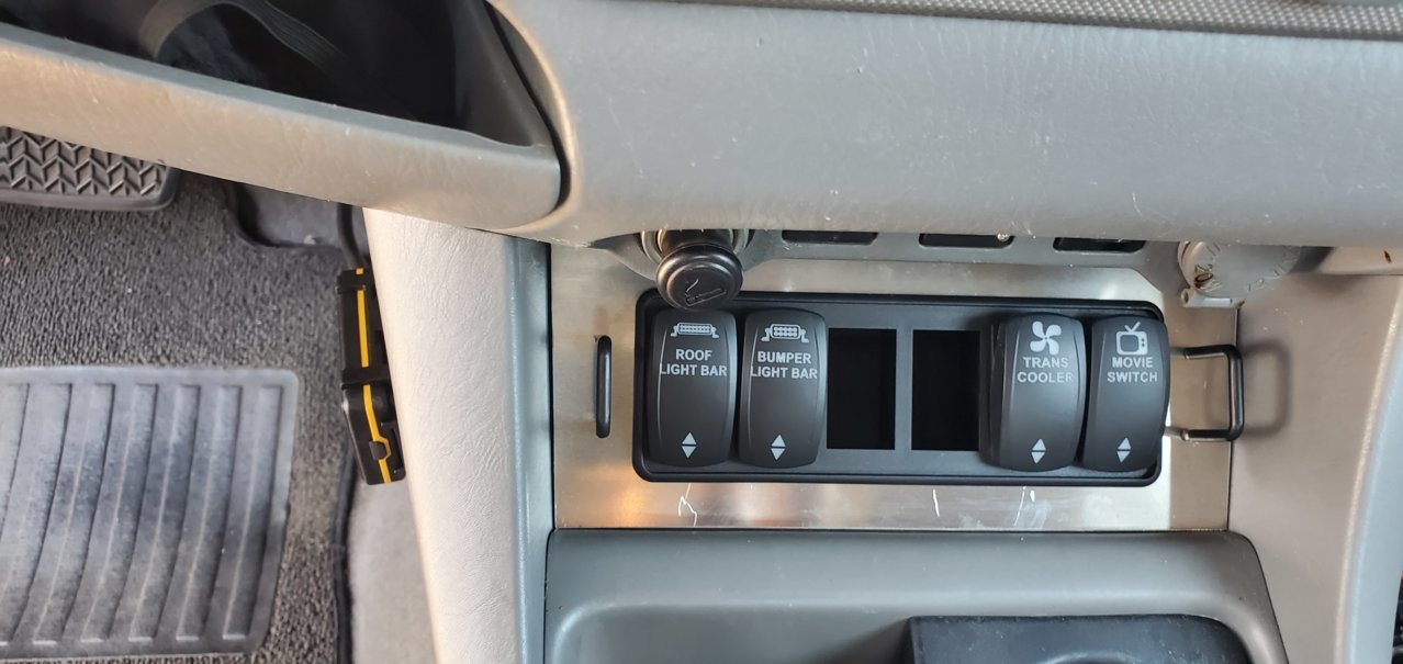

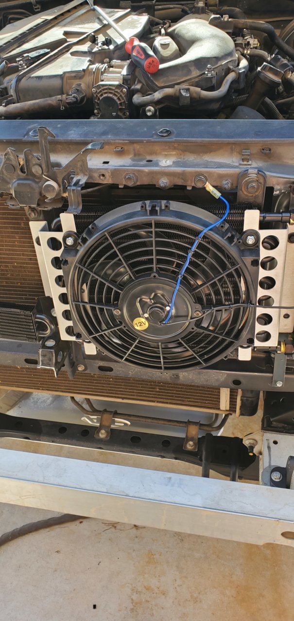

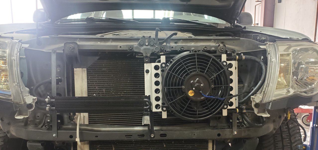

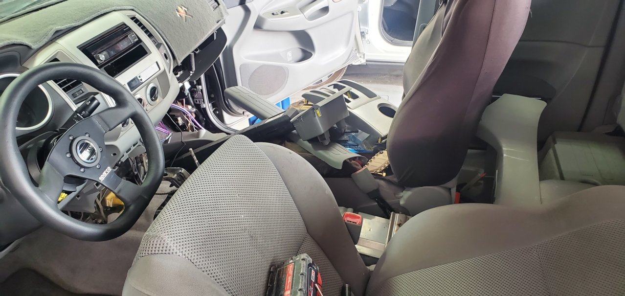

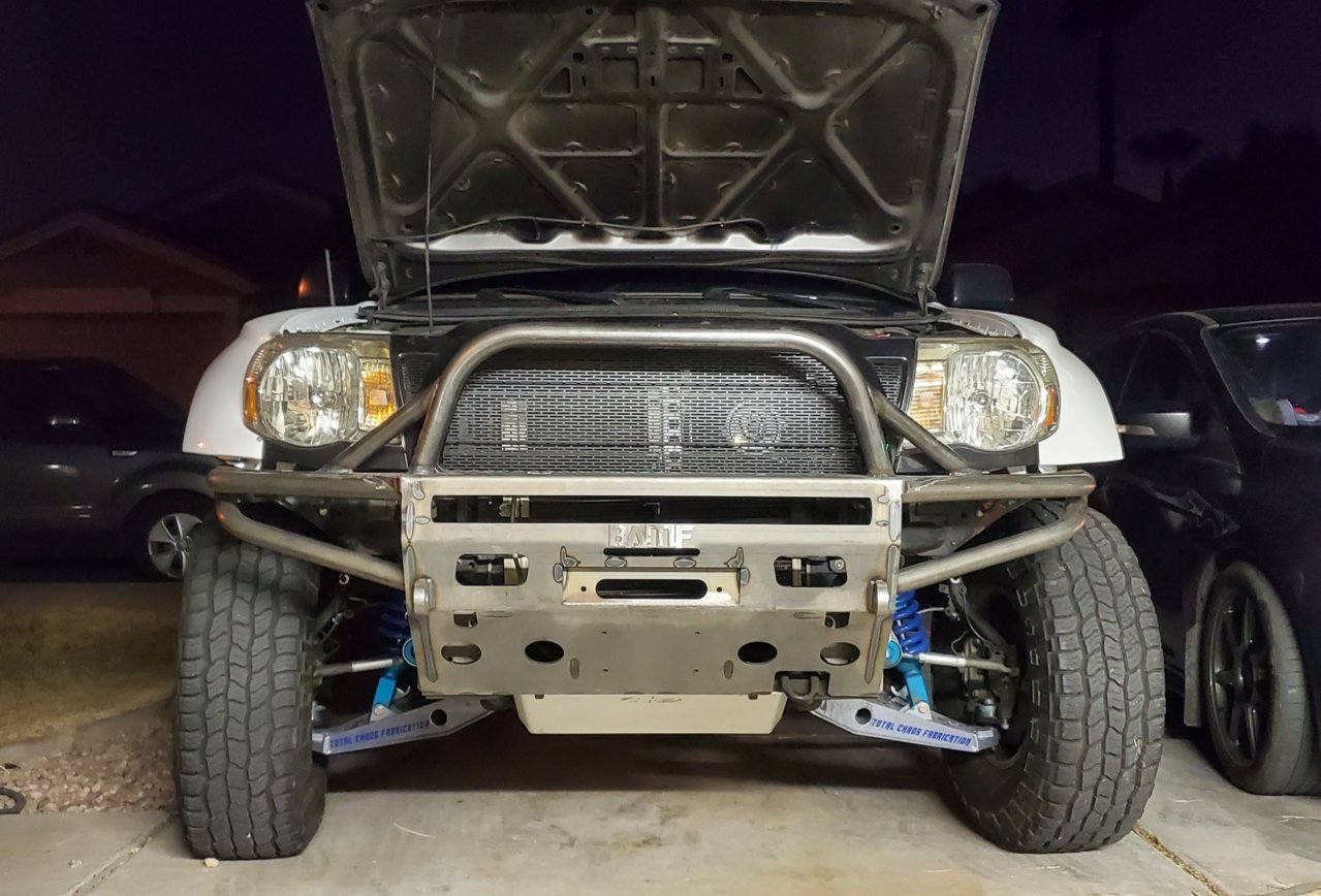

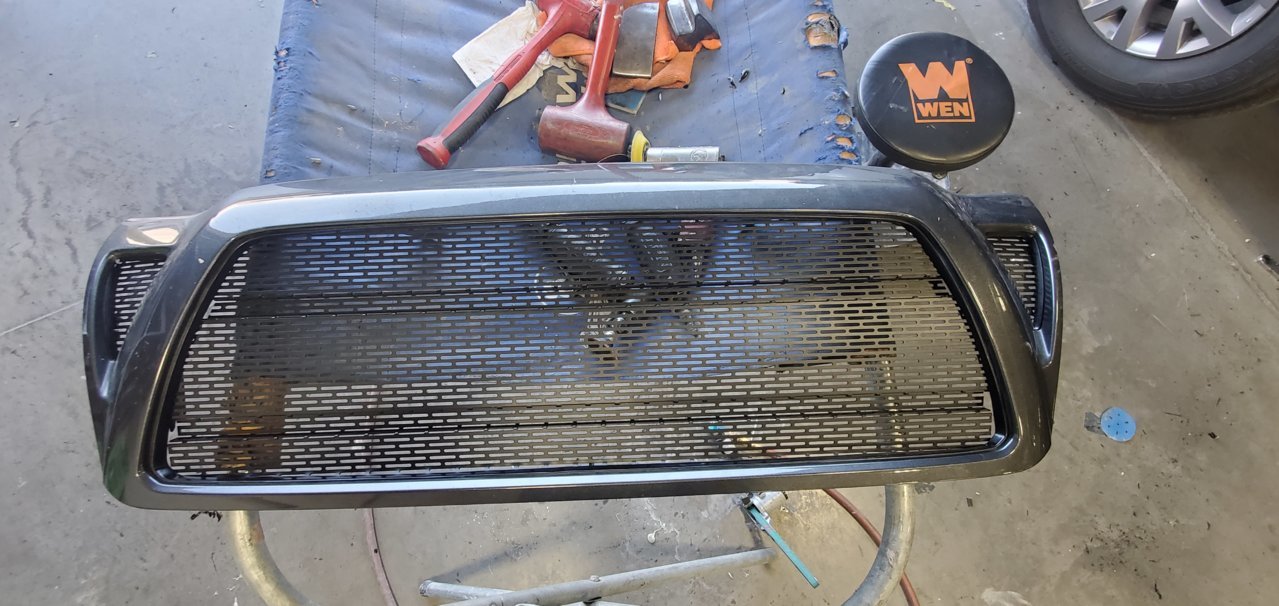

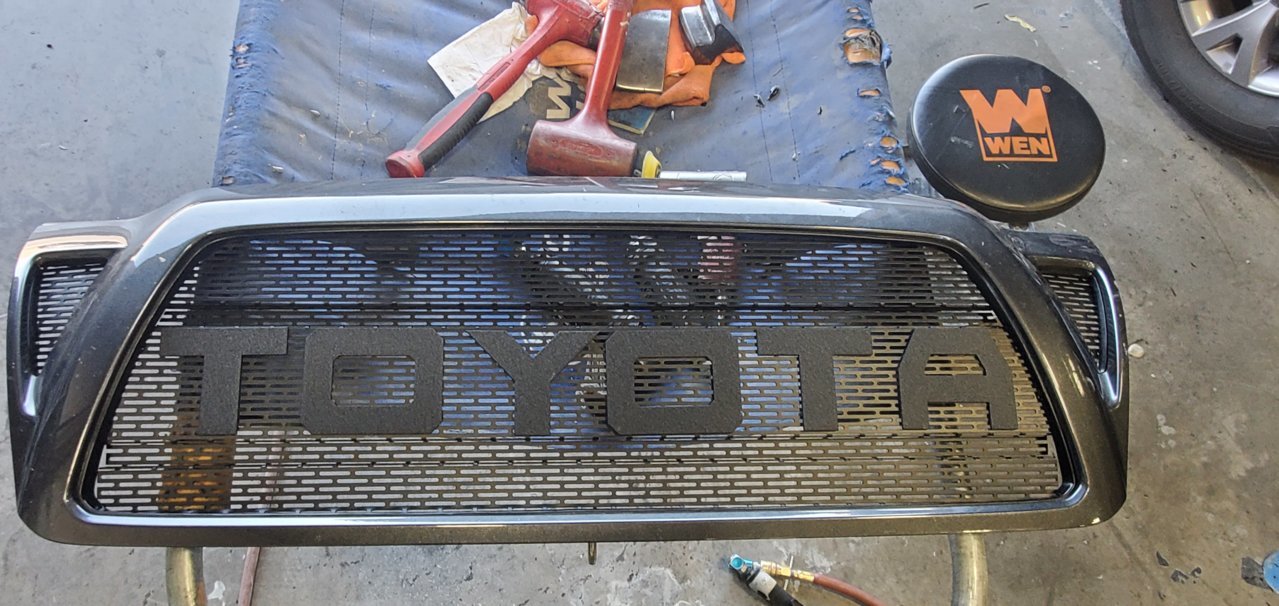

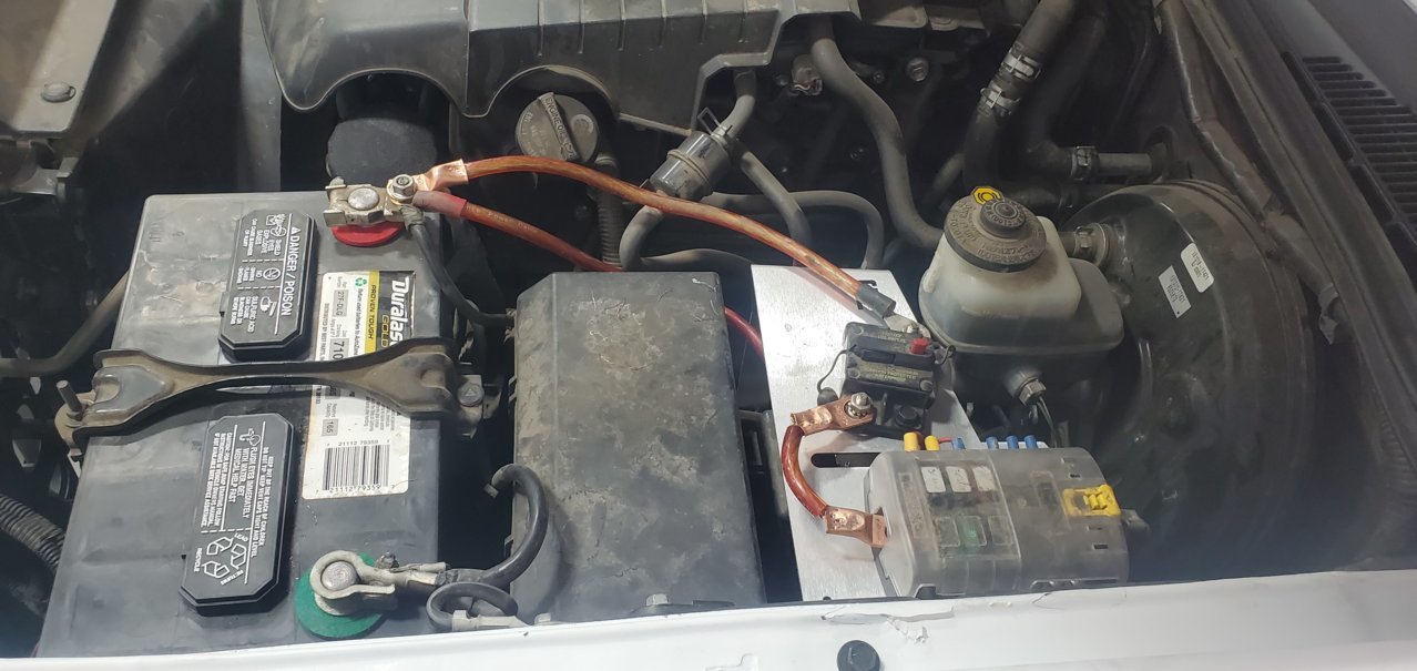

    Redid the speaker wiring I did 7 years ago and cleaned up the engine bay wiring. I got the wiring for the transmission fan done while I was at it and now just waiting on the Iggy switch panel to finish up the electrical.

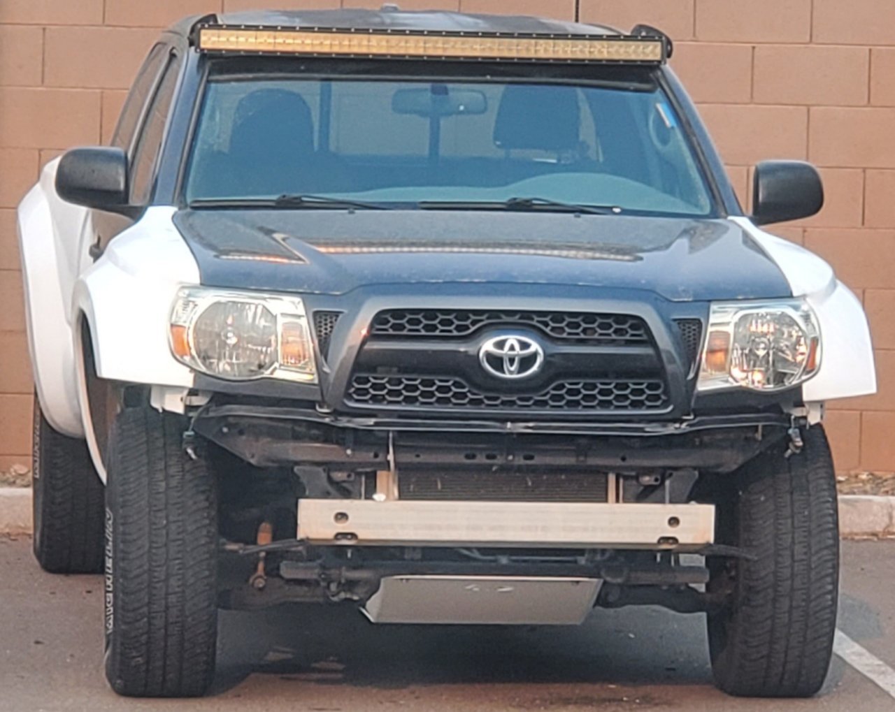

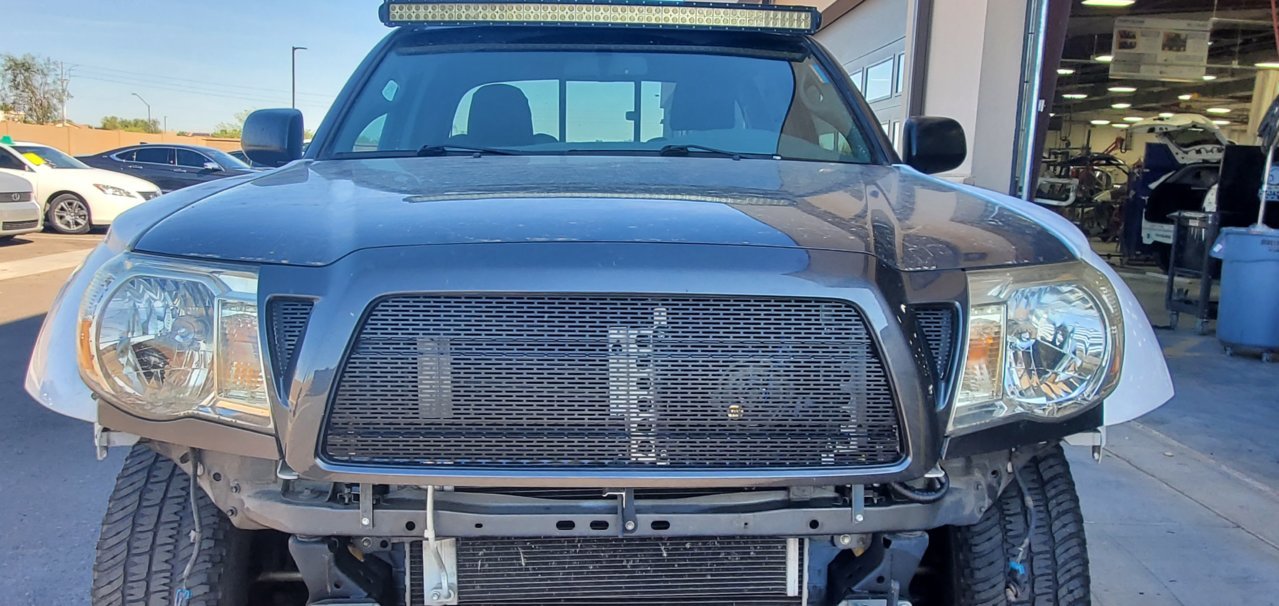

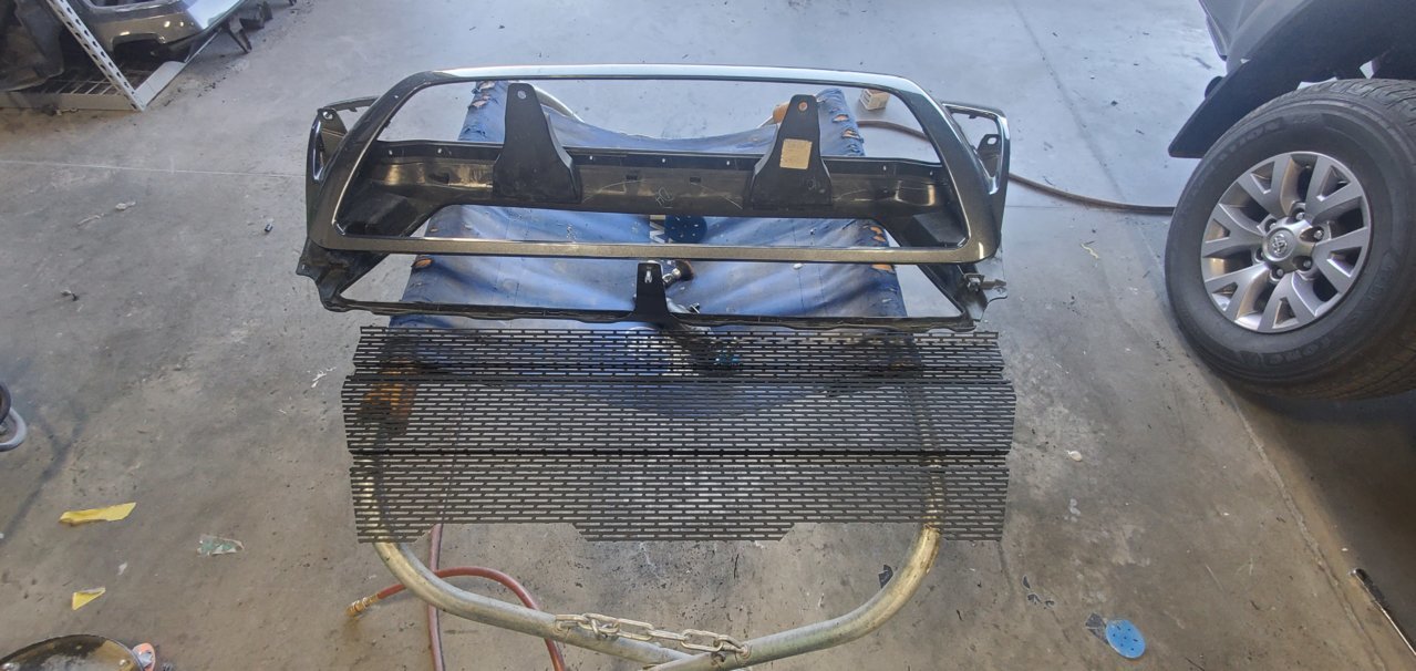

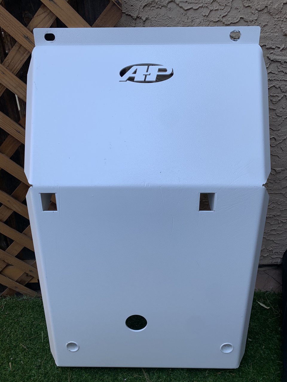

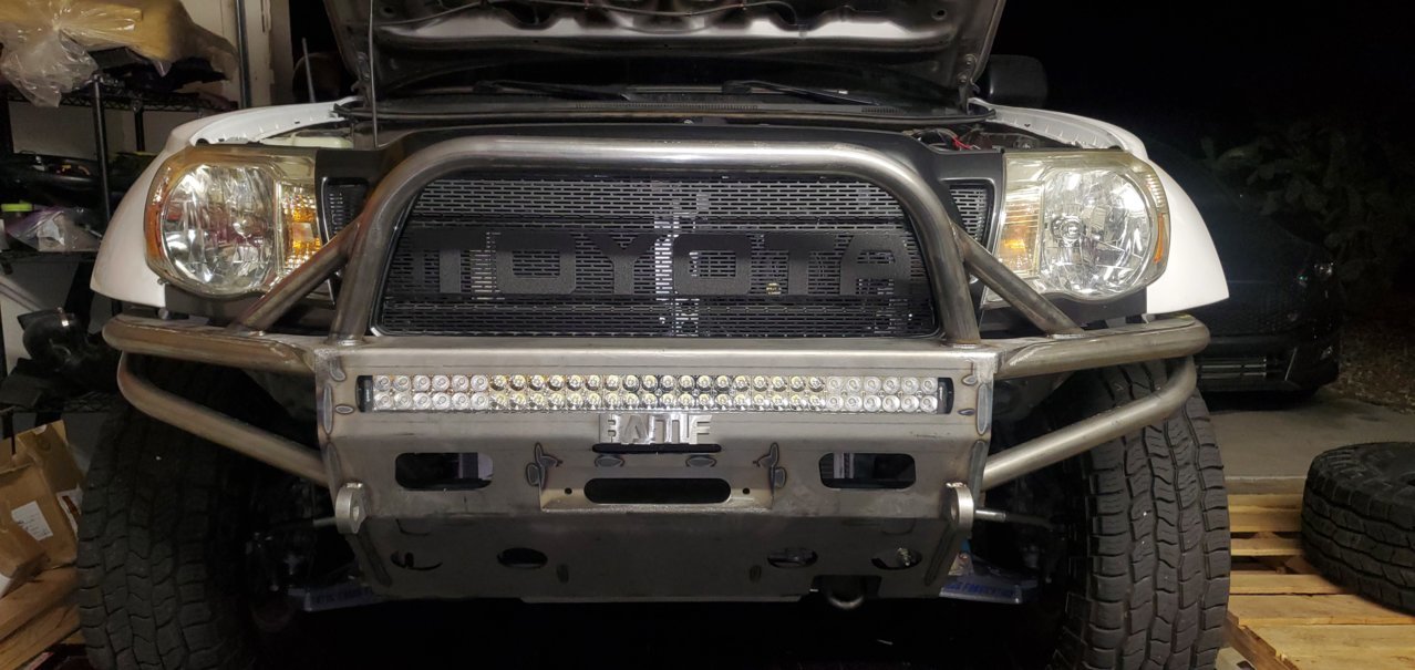

    I'm having a custom decal made for my skid plate, should be a good laugh the first time I jump it and make people look!
    I also can't decide if I want to add the Toyota letters or leave it alone. My main goal is to increase air flow to the cooling fans, I might wait until I take it out a few times and see how it handles the operating temps.

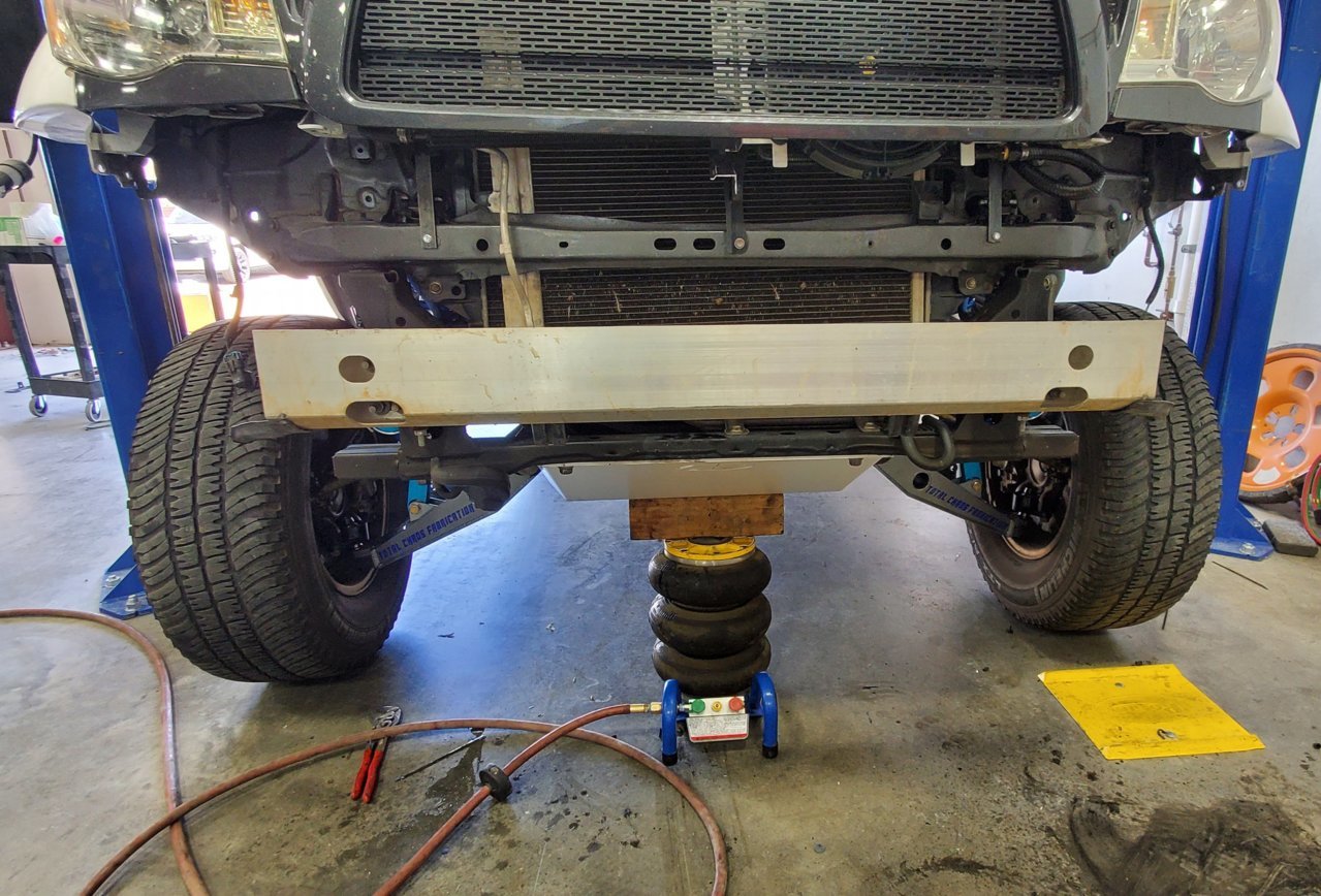

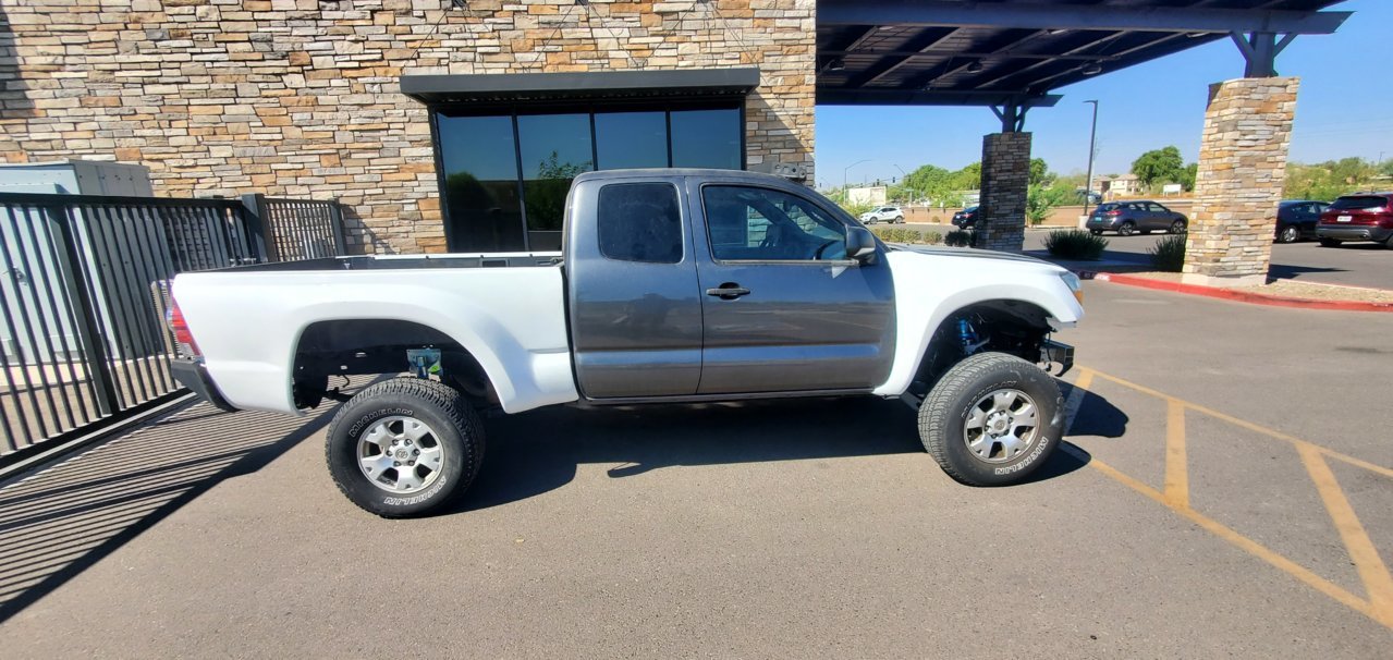

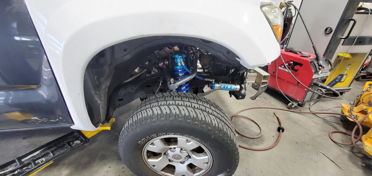

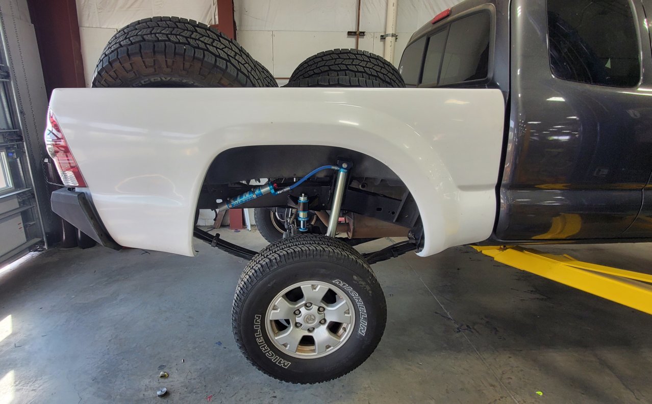

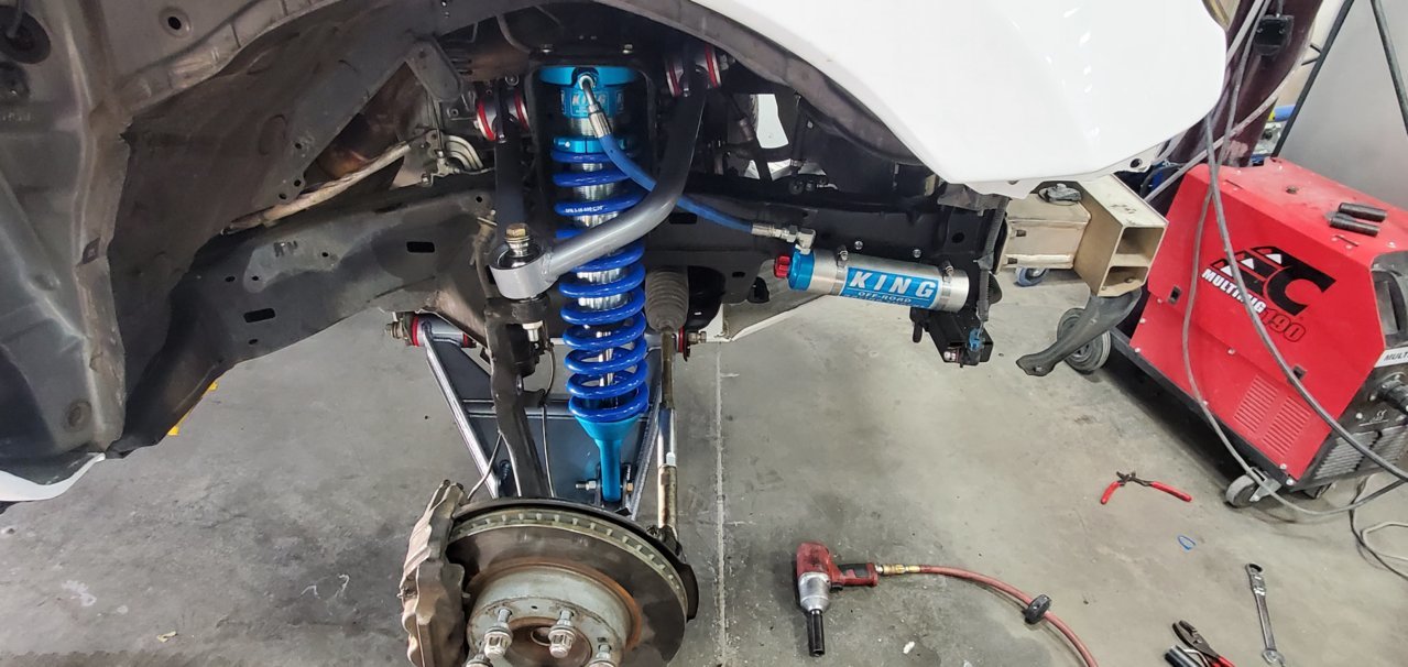

    Got the front suspension installed. Unfortunately dad duties called and I wasn't able to fab up the rear shock tower or do anything other than install the rear bump stops.

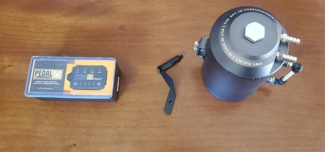

    Oil catch can, Ultraguage mount and pedal commander are ready to go this week when I can sneak them in. I decided to hold off on the gusseting of the components until life calms down a little. Having a 2 week old baby is making this build harder to schedule time for, my most productive time is usually my lunch break now.
    The last pic is actually the suspension on its own weight, my stock tires look like they came off of a Miata now!

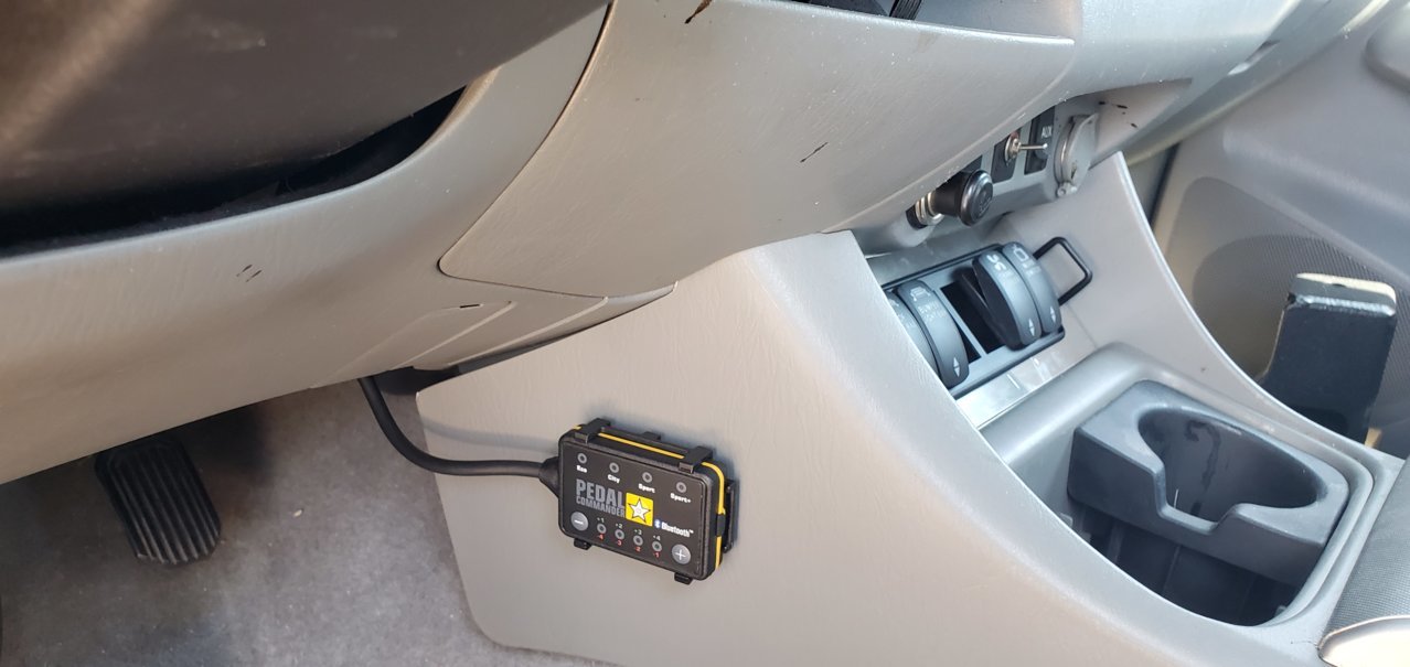

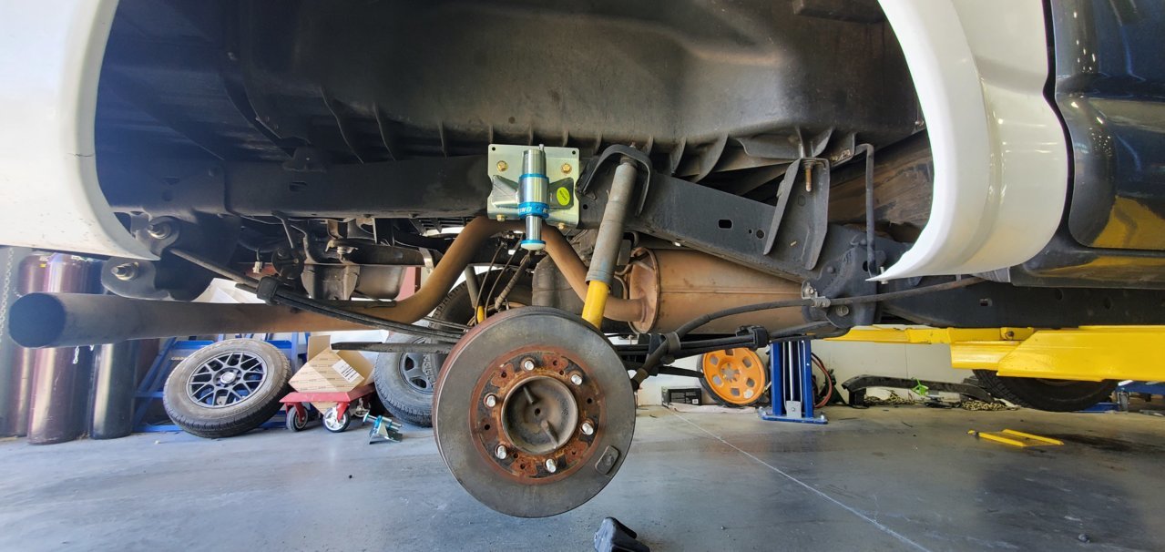

    I didn't get as much done this weekend as I was hoping for. Rear suspension is ready for me to take my time and tack in the shock mounts and cycle it for next weekend. In the mean time the Pedal Commander was put in, overpriced but definitely needed. Since this isn't the Fast and the Furious and we are adults, in order to monitor my temps the only route is an Ultraguage

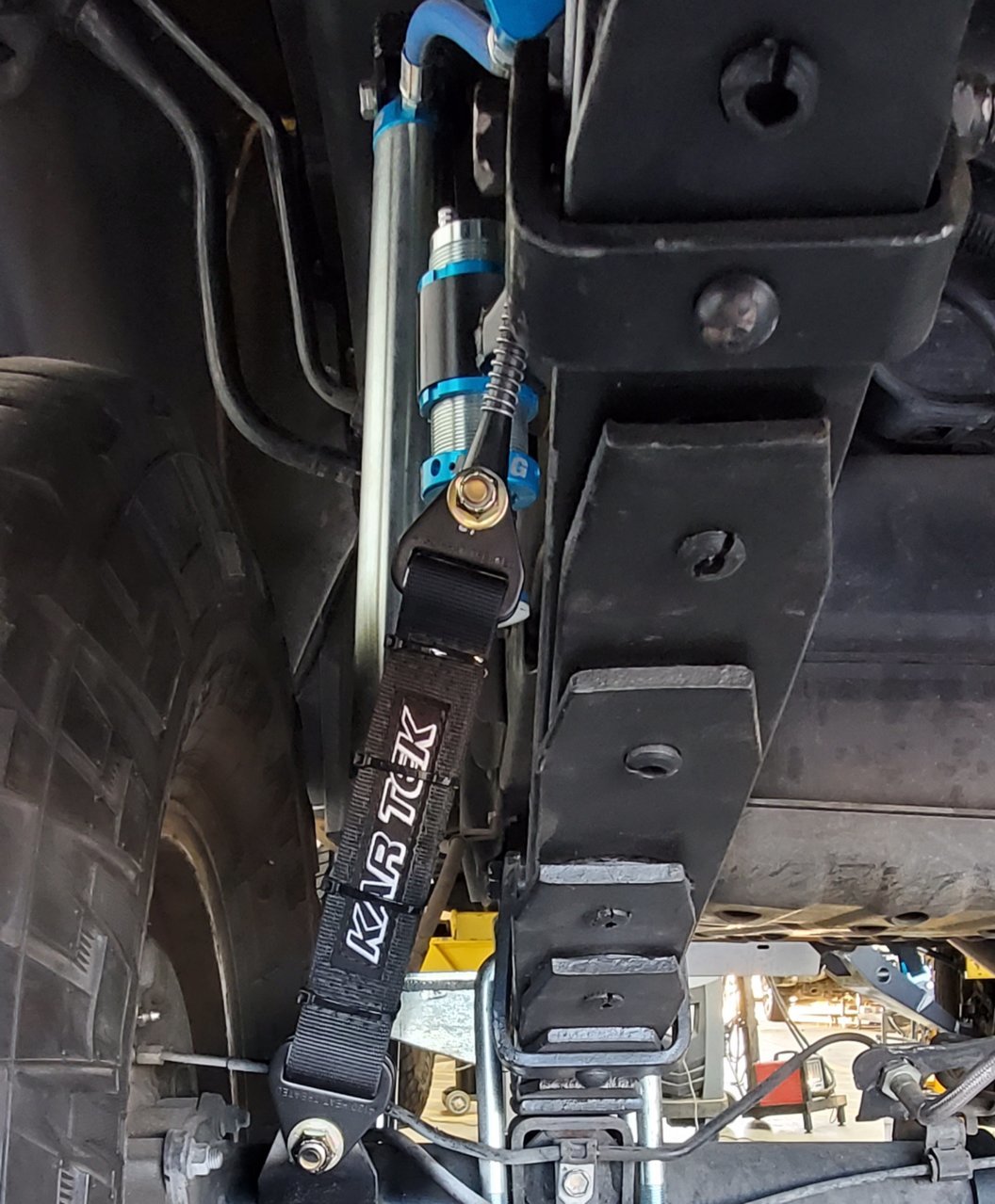

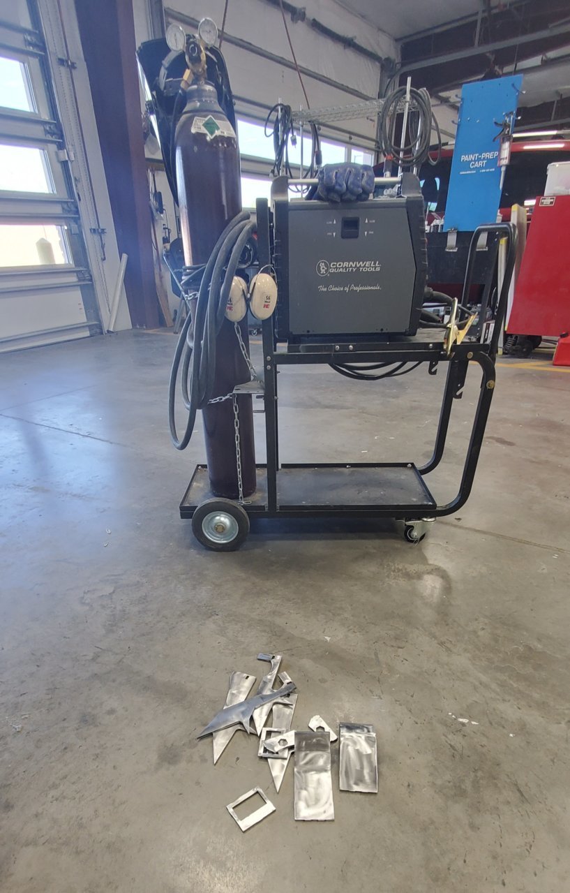

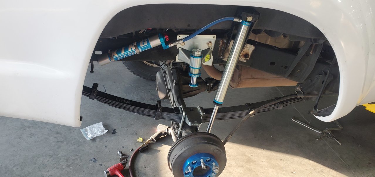

    Got the rear shocks in and 5 new tires from a fellow AZ member this week. Grinding the stock shock mounts were a nightmare! Hopefully tomorrow I can find a local shop that can do an alignment with my long travel and get the tires mounted as well.

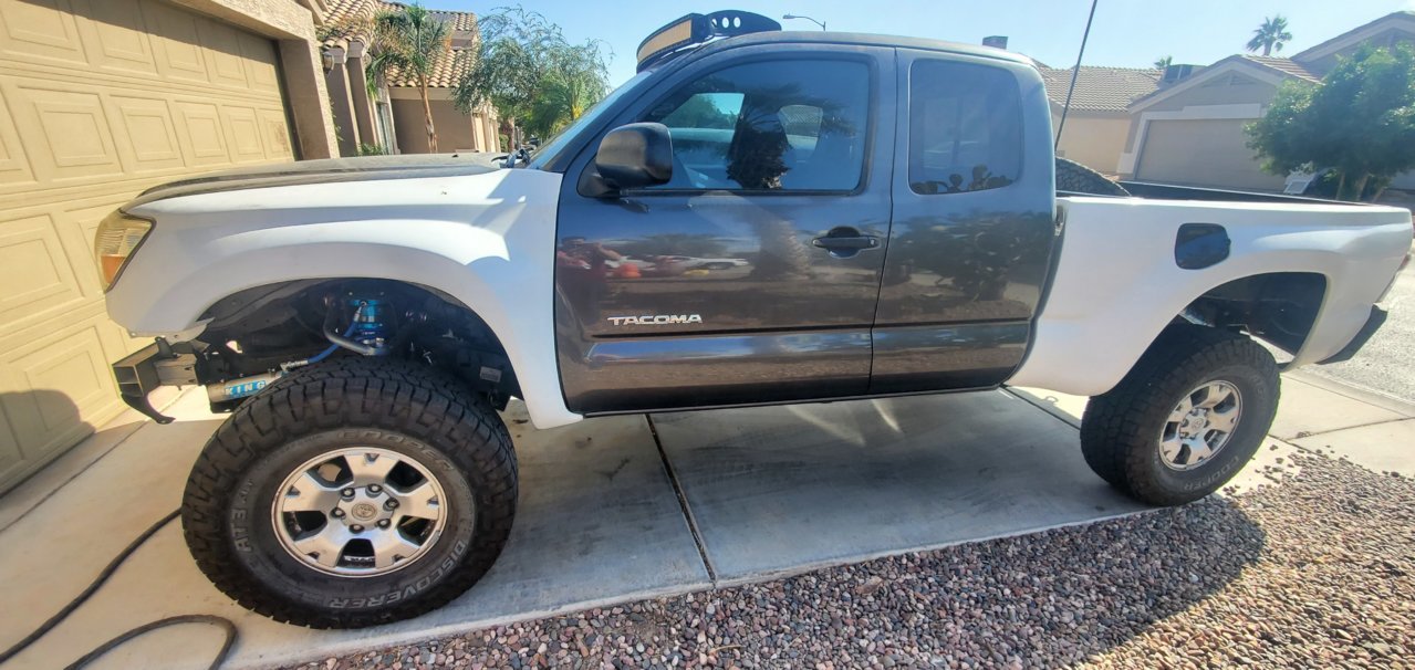

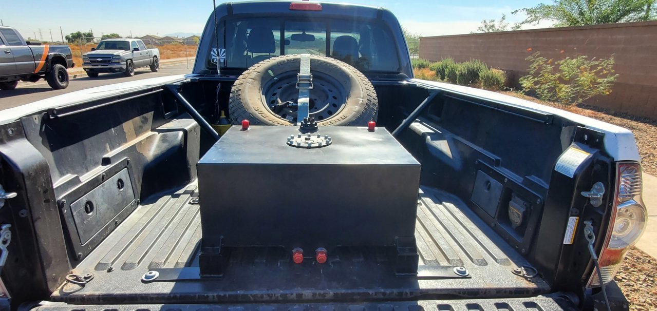

    So I finally got the rear end strapped, so now its safe enough to start offroad testing this rig anytime now. BAMF sent out the bumper a week after ordering it and I had it on my truck less than 13 days; for running a skeleton crew they are insanely fast!
    I have my fuel cell mounted and will plumbing the lines to tap into the filler neck, doubling my gas mileage and adding an extra 200 pounds to the rear end never hurts. 34 inch-ish tires mount and balanced, I want to redo how my spare is mounted in the bed and I will be adding a Tonneau cover to keep my things from walking away.
    At this point its just a few odds and ends, mainly electrical wiring and painting the front and rear bumpers. I can officially say phase 1 of the build is nearly complete, now I can start planning out the back half of the frame or going SUA route and all the components for that. I should start sometime in September for that portion of the build, hopefully I can find some cheap Sparco seats and 5 point harnesses in the next couple of weeks and hit the cold Arizona desert ASAP.
