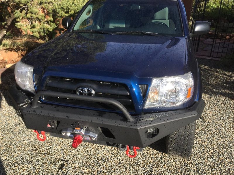

    No more chrome grill.

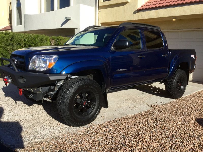

    Lift and tires are on! :woot:
    Waiting for suspension to settle before posting measurements.

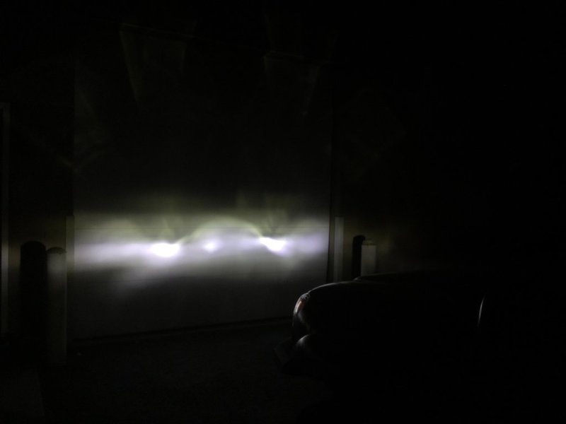

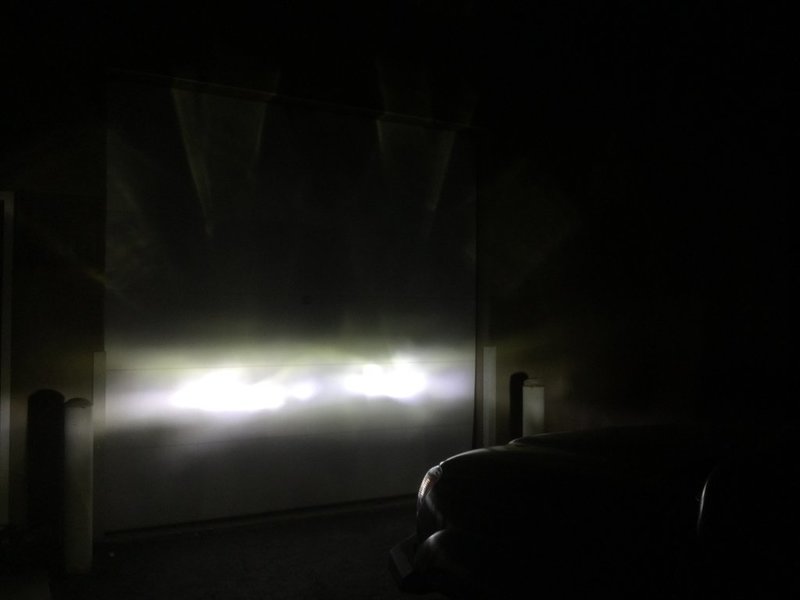

    I reduced the exposure greatly so you may see the patterns.
    Low beam:
    Highbeams:

    I got about 1.25 to 1.5 inches in front and 2.25" in the rear.
    Still waiting for the new coilovers with 700# rated springs but here are the measurements with the 650# rated springs at factory settings:
    NOTE: I have an additional 240lbs of weight in the front. Thus the reason why I ordered the 700# instead 650# springs in the first place.
    Ground clearance before lift and tires:
    8 5/8" at the Allpro ifs skid plate
    9 9/16" at the rear diff
    Ground clearance after lift and tires:
    10 7/8" at the skid plate (1" credited to the change to 255/85/16)
    10 9/16" at the rear diff (1" credited to the change to 255/85/16)
    Fender height before lift and tires:
    Front driverside - 34 3/16"
    Front pass side - 34 3/8"
    Rear driverside - 37 3/16"
    Rear pass side - 37 1/4"
    Fender height after lift and tires (1" credited to the change to 255/85/16):
    Front driverside - 36 11/16"
    Front pass side - 36 15/16"
    Rear driverside - 39 7/8"
    Rear pass side - 40 1/16"
    Distance between top of rear axle and the frame's bump stop contact plate:
    Before lift:
    Driverside - 8 1/2"
    Pass side - 8 7/16"
    After lift:
    Driverside - 10 11/16"
    Pass side - 10 9/16"

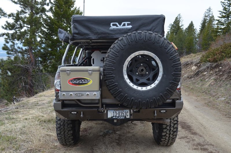

    Ordered the All-Pro Rear bumper with dual swing tire carrier. :woot:
