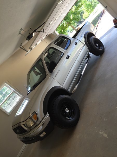

    Bought new wheels and they are hitting the caliper so I bought some 1/4 inch spacers. Will this help clear the calipers and will it leave enough threads on the lugs?

    Thanks guys, the 1/4 spacer ended up clearing fine. I put on at my house to try first and the tire store thought I had plenty lug left. We don't have a discount tire or any large tire stores where I'm from. I use a small family owned tire store. Got the tires and wheels put on today and it made a huge difference!
