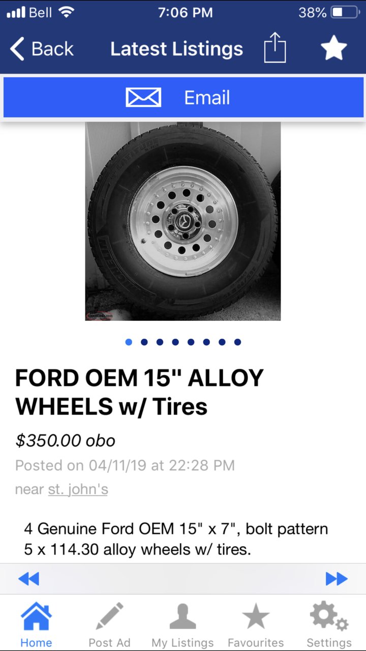

    Local dude selling these, you guys think they’ll fit?

    It has a Mazda center cap. Bolt pattern will fit, but you need to check offset/backspacing to ensure they will clear the brake caliper
