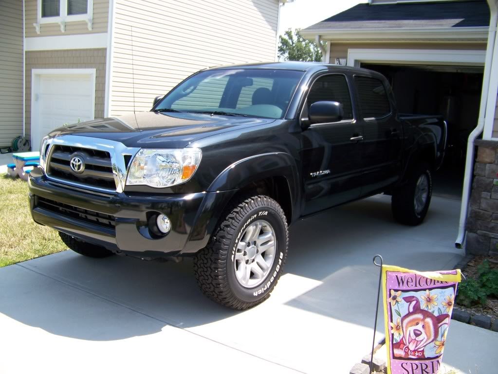

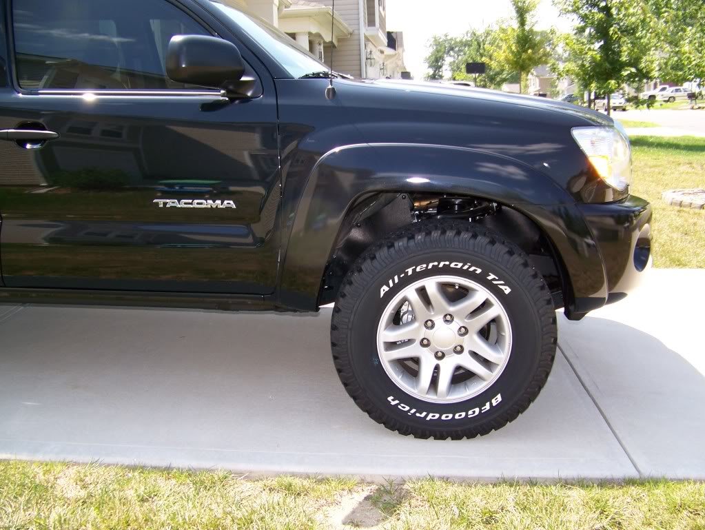

    Thanks for the pic, they look nice. Do you have a pic showing the whole truck?
    Thanks

    Those look pretty nice! I bet if you painted them black it would look a lot better.

    Your wheels look great.....what size tires are you using?

    Those look sick bro!!!!!

    265/70/17 on stock ride height. I'm also considering getting them PC Bronze.
