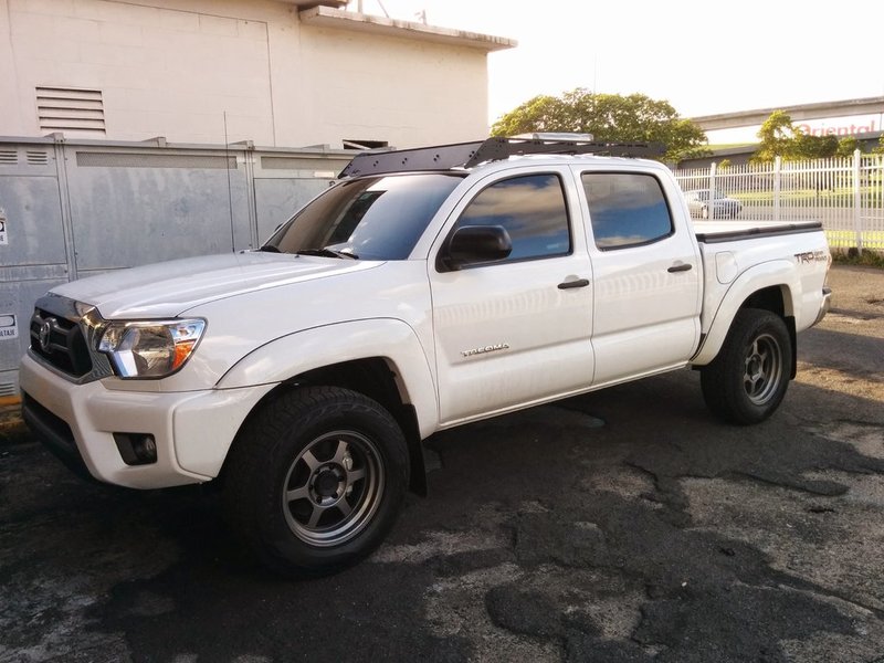

    I have Konig Countersteer type x with Pirelli Scorpions ATR in 265-65/17 and they only rub in reverese full lock with the stupid front black plastic thingy. Other than that they fit like a glove, and I'm on stock suspension. I don't remember what is the offset of the rims though. Hope that is of some use for you!!!

    Thanks bro! Looks good on ur truck. Ive been doing some research n it looks like ur rims have a 4.1 inch backspacing and according to some sites, a 5 inch backspacking on a stock suspension might have some rubbing issues. Ill be going into costco today to put my new tires on and hopefully i wont need to add spacers for them to fit properly. Just crossing my fingers because i really dont want to spend more money on getting spacers

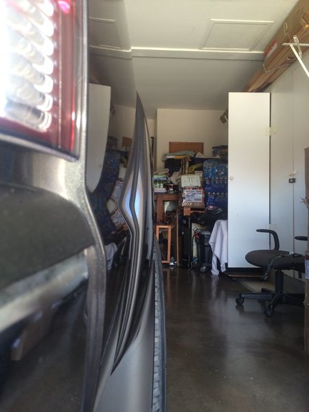

    Surprisingly they dont rub at all even at full crank. Pretty satisfied even though i had to wait 4 fckn hours for these to be installed at costco lol. They stick out just a tad bit but nothing too major

    iRay808, could you post a picture from the back (or front) along the side, so I can get an idea how they line up with the fender. It really would really help my decision making. Thanks in advance.

    Heres a photo of how much it sticks out from the fenders. Hope this helps a little.

    perfect, I really like that look. I guess I gonna settle on 17x9 offset 0. thank very much for your help
