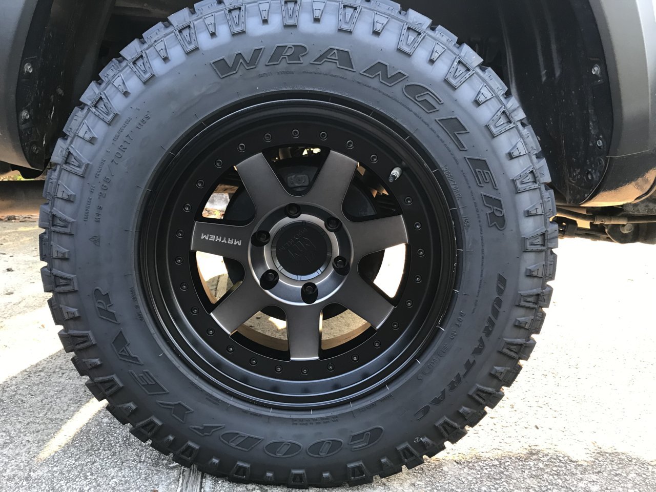

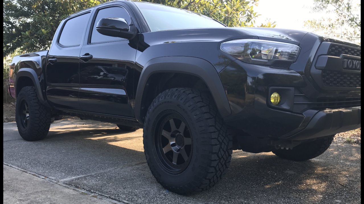

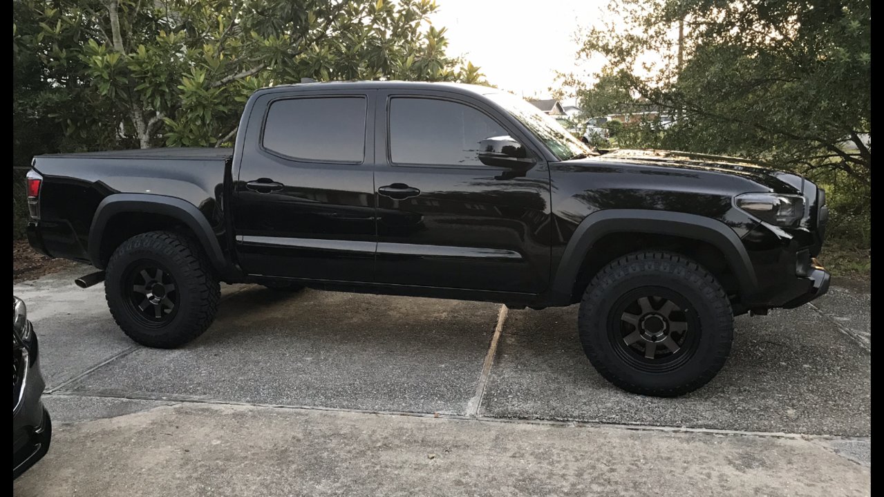

    I was skeptical about fit with -6 off set. But it works, I only rub at full tilt in reverse on plastics. Still haven’t heat gunned my plastic tho. And like I said a ton of Toyota wheel companies use a -12 offset. Like almost all the stealth customs are!
