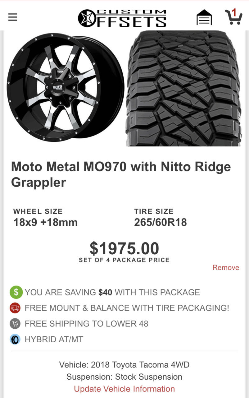

    I have a 2018 limited,it's completely stock and I want to keep it that way.Will 18x9 rims with +18mm offset fit without any rubbing or sticking out?

    This is the wheel and tire set up I'm looking at

    That’s a 5.70 backspace. 5.5 is usually the max. May have some uca issues.

    What backspace should I be looking for,what's factory?

    Each factory wheel is different. They have the marking on the backside of the wheel. An 8” wheel 0 offset is a very good happy medium. Also if you go down to a 17” wheel there are many more tire choices. Just food for thought.

    I just placed an order for this exact set up, the dude at the shop says they’re gonna remove mud flaps and do some trimming.
    Did you end up going with these.

    Not yet,I don't want to trim anything,I would rather find a wheel that might fit better,sucks because I really like these!

    So I would be better off looking for an 18x8 wheel with a 0 offset if I stay with 18's?

    Imo it’s a great choice. It will give just a smidge of poke w/o the issues of getting into negative offset.

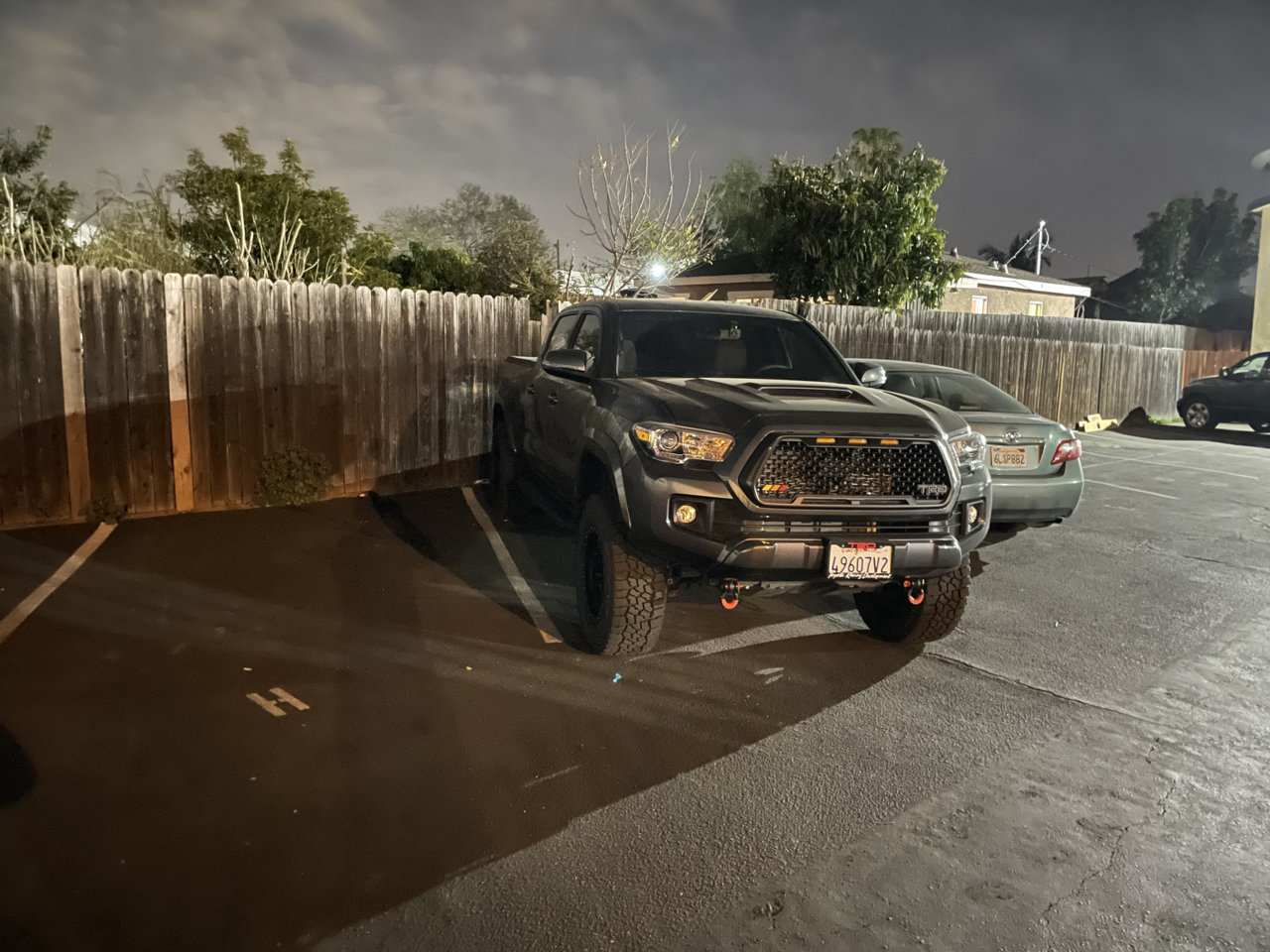

    Hey dude so I did the method mr309
    18x9+18 offset. I’m kinda rubbing on the uca you may want to go with a 0 or negative offset. I’m not quite sure what stance you’re going for I wanted something that poked out a bit more, but overall I’m pleased. Maybe some spacers in my future. 28E1FEC2-2E93-46F4-8EE4-19D93989D46D.jpg114249E6-7467-4223-9231-6D681C69B5E0.jpg
