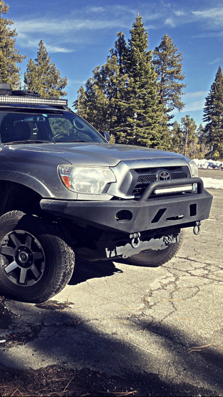

    DC1B4545-8FD1-46B7-A31D-7B1FECFCC7EF.jpg This is a 5-11 bumper on my 2015

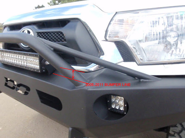

    In the case of the Demello bumper, there will be a 2" gap between the grille and the bumper. You can always cut a piece of aluminum angle from a hardware store and bolt/glue it in as a gap filler, just depends on how big of a discount you're getting with the used bumper.

    Yep, unlike the All-Pro, the Demello bumper dips down at the grille:
