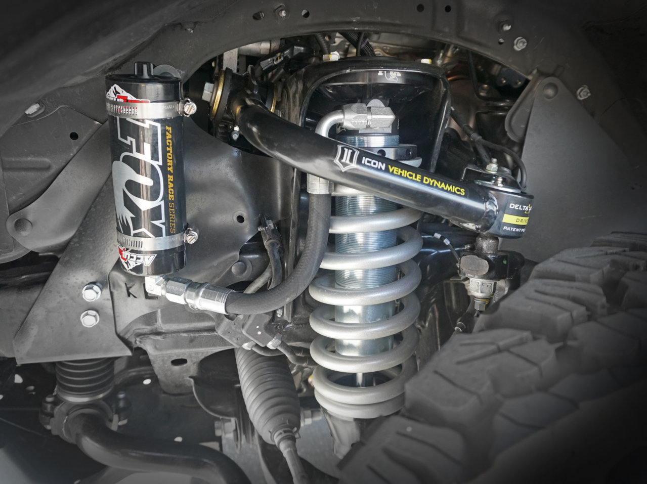

    The 4Runner Coilovers will come with a 14" x 600lb spring, instead of the 13" x 600, but may work out well. Biggest issue will be hose/reservoir mounting. Tacoma kits also come with spacers for the sway bar.
    4Runner hose routing and reservoir mount
    Tacoma hose routing and reservoir mount:

    so do they sell replacement lines? or do you think i would have an issue with with the 4runner lines?

    It would just require one of the fittings to be replaced or removed. You could try and make it work as is, with a universal fit reservoir mount, or we can swap everything to make it fit with Fox factory bracket.
