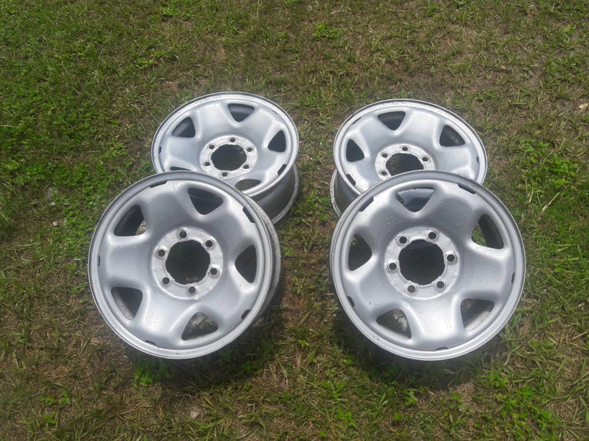

    I want to know if the 2015 Tacoma PreRunner Factory 6-lug 16 x 7 steel rims will fit only 2000 Tacoma 4WD that has the Factory 15 x 6 or maybe they are 15 x 7 steel rims? anyways, I like the look of the Factory steel rim but just want a little bigger rim is all.

    Yes.
    I have 3rd Gen wheels on mine. Most, if not all 6 Lug Toyota wheels will fit.

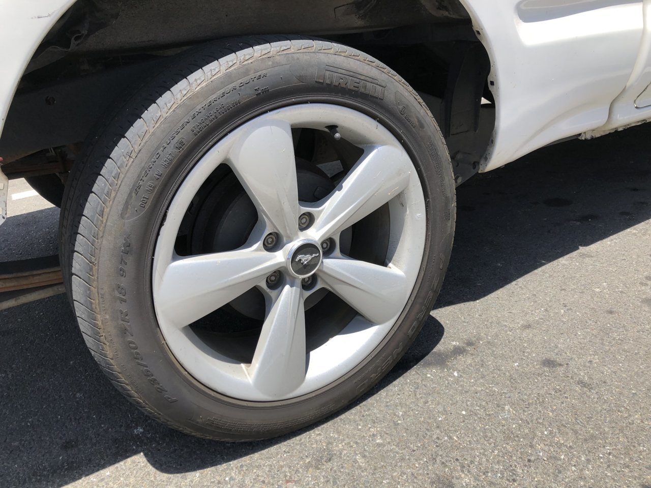

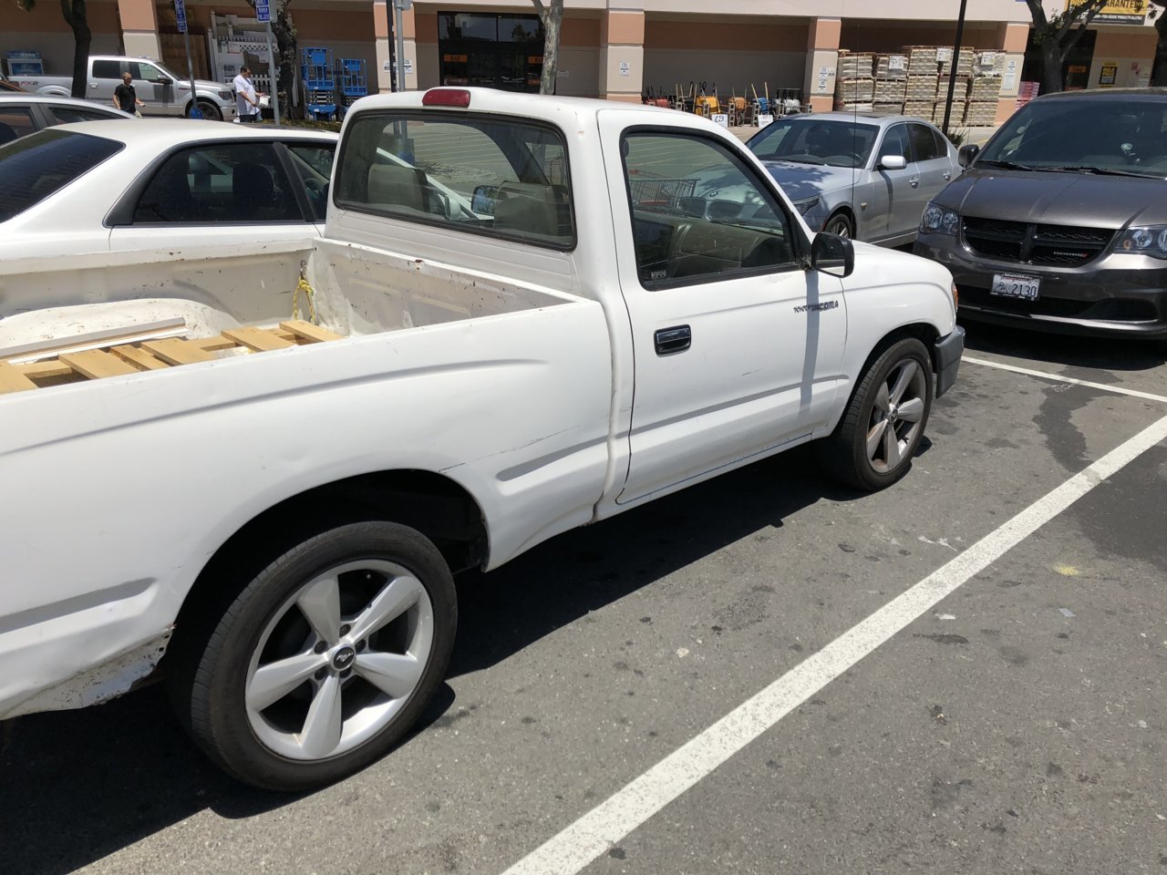

    5-Lugs use the 5x4.5 bolt pattern, which are common with many cars. Here’s some Mustang rims I found on a 1st Gen.

    Wait... Ford Rwd 5 lug fit our trucks....?!?!
    I thought they were 5 x 5.25?
    My mind is blown!

    They will fit but if your tires are bigger than 265/70r16 they will probably rub the frame when you turn, because 2nd gen Tacoma wheels have more backspacing than 1st gen wheels.

    So I went ahead and bought these 2015 Tacoma 16" x 7" rims today --- $80 for the complete set of 4 rims, center caps ( which I don't need for the front because it's manual locking 4WD hubs) and the lug nuts. That was a STEAL...... for the STEEL rims! LOL
    I will take pics when I get tires mounted and put on the truck. I've read in some posts andI think online also that I can do 265/75R16 on my 2000 Tacoma 4WD and some say 265/70R16. Which size should I put on the 16 x 7 rim??
