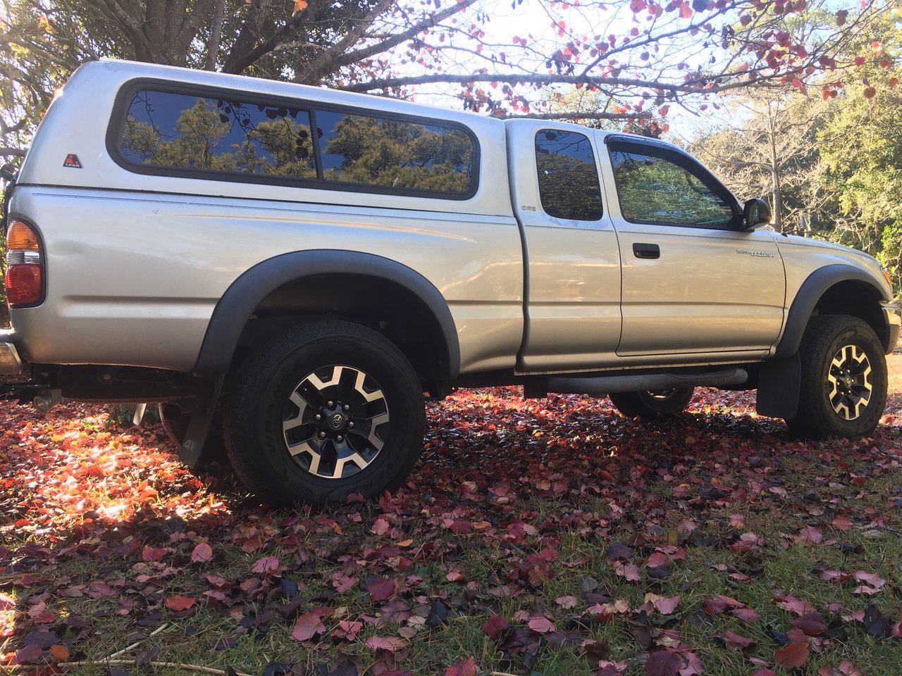

    Got the new wheels and tires today, thanks for the help.
    jsinnard likes this.

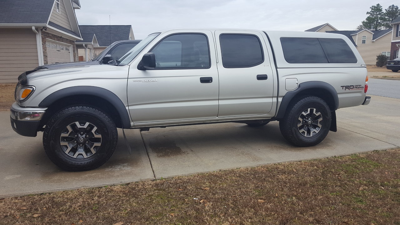

    Hey guys, just got on this forum and it seems dope i just got my first little truck its a 2003 Toyota Tacoma sr5 super clean! Any ways it has some ugly tiny wheels with chrome caps on them (disgusting) so i immediately bought some 2017 Toyo tacoma yrs wheels for cheap knowing i coukd resell them if they don't fit. I eould test fit them but they dont have air im just wondering if you guys know if it would fit everything is stock. Will provide pictures soon.
  12. Feb 16, 2018 at 2:01 AM
    #32
    jsinnard
    jsinnard Well-Known Member
    Feb 4, 2009
    #13279
    6,679
    J
    Virginia
    16 QS DCLB OR 4X4
    They fit fine.

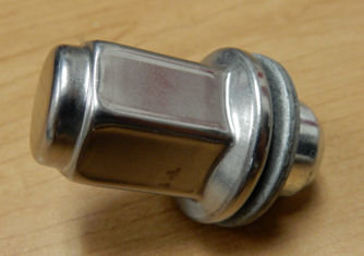

    Since I don't know what type of lug nut you have on your 1st gen you're going to need a flat seat alloy lug like the type shown here to work with the 3rd gen OR wheel. pure-4runner-lugnut-PTR20-89150.jpg
    shakerhood likes this.

    Thanks Jason,
    Apparently i had "acorn" style lugs on my old tires, these are definitely what I'm looking for. The only thing I couldn't get a straight answer out of the dealership on was whether I needed the longer or shorter stem for where you use the torque wrench.

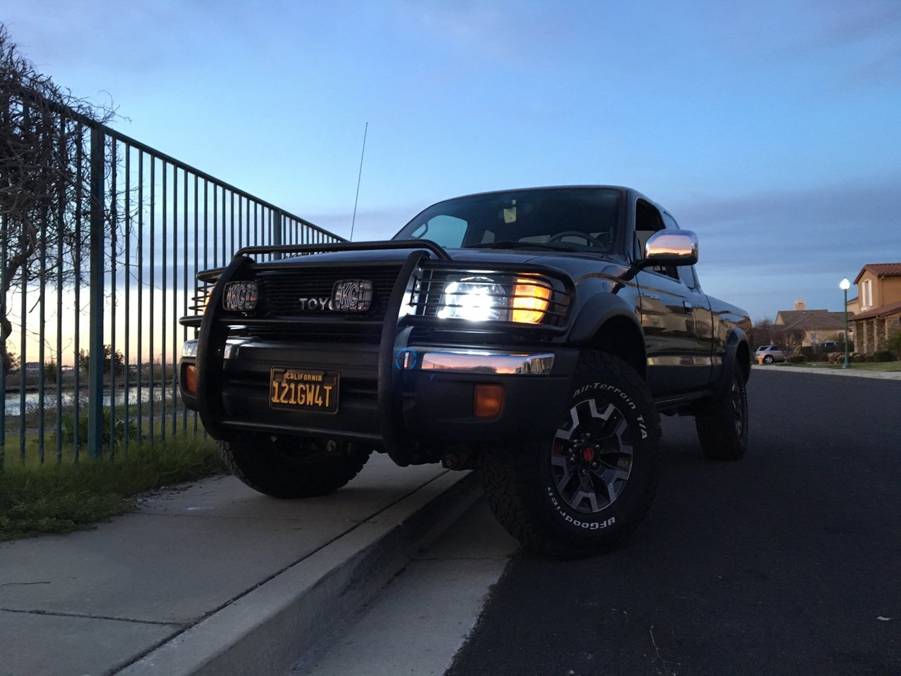

    They fit perfectly on my '98.
    I have rubbing at absolute full steering lock but that's because I'm using much larger tires than stock (BFG KO2 LT265/75R16) I only notice it when you're turning sharp or parking.
    BTW - The 3rd Gen Lug Nuts have the same thread pitch so they'll fit fine. I'm even using the 3rd Gen Wheel Locks. Difference between the wheels really is the back spacing. I'm also running AISIN Manual Hubs and Tundra 13WL Calipers and they both clear no issue.
