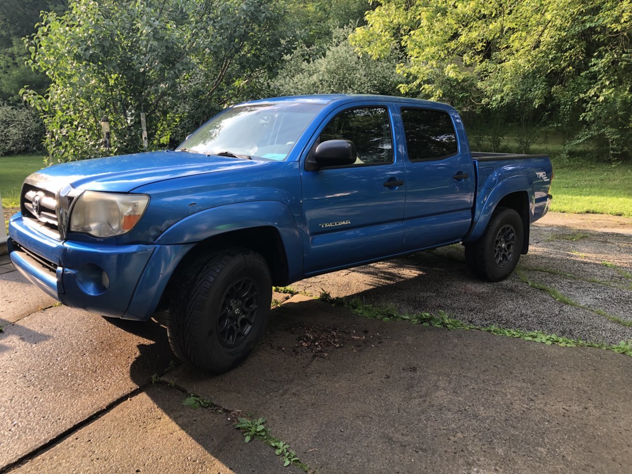

    for the sake of the thread: I put stock 2017 (graphite) rims on my 08’. Very pleased with the results (both were 4x4)
