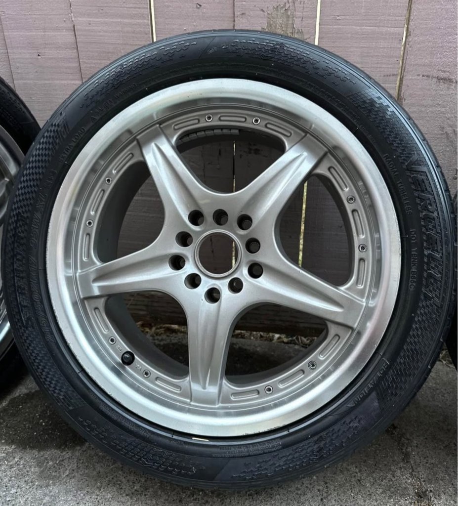

    Hello, so i really want these wheels for my 00 tacoma extended cab. These are the first set of wheels ill ever buy for my vehicle. I want to know if these will cause rubbing or any other problems. The size is 215/50/r17 rims size is 17x7 and i think the offset might be 42. I have done my own research and most tire specs ive seen with 17" wheels were 225/45/17 is the 215 and 225 a big difference. If they will be a problem i wouldnt mind changing the tires if i do get the wheels. A other thing keeping in mind is that im going for a street look i plan on lowering it a little bit later on not too much tho since its a daily. Hopefully this made sense and i get some advice. Thanks in advance for your help. These how the wheels look. I just like how they look and the condition is like newScreenshot_20250702_171952_Facebook.jpg

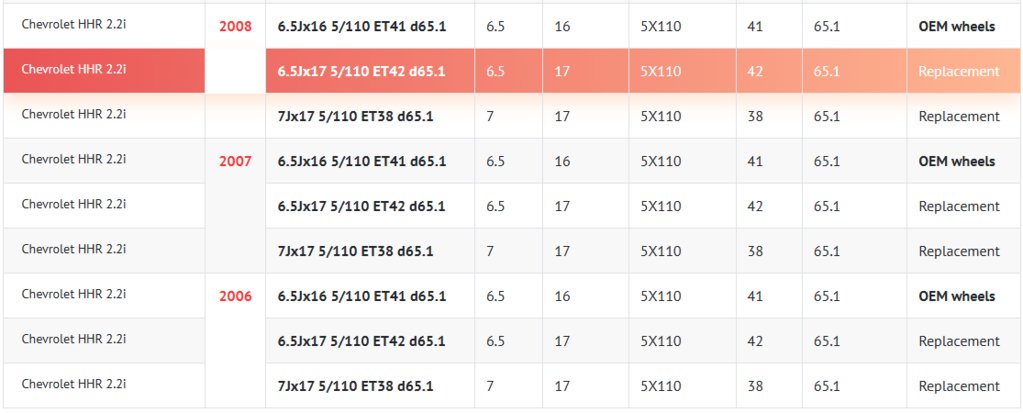

    HHR wheel info:
    So the bore is too small.

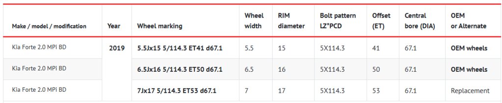

    How about these KIA 17" rims: https://www.ebay.com/itm/256944149337
    The offset is a bit high but might still work. width, Bolt and hub fit are good to go.

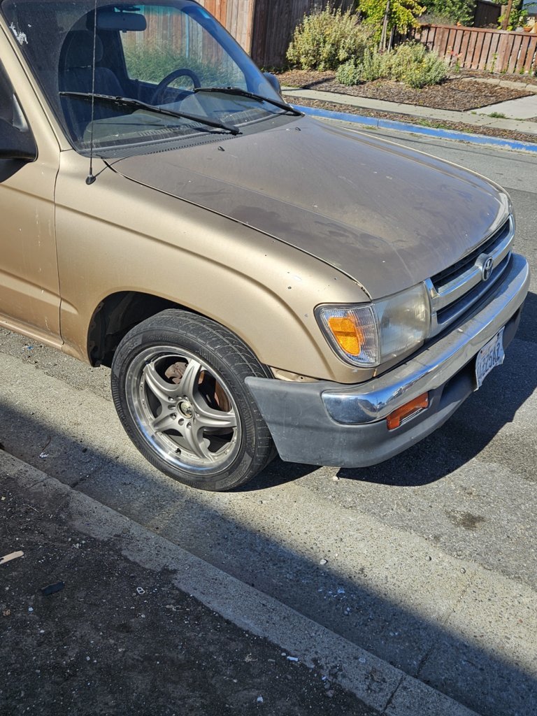

    So i bought the wheels and they seem to have bolted on pretty good. Since im not a wheel expert i can use some advice or what are things to look out for with aftermarket wheels that may be a sign of a problem. I know my bumper is fcked up right now but that will be fixed soon but the wheels dont rub suprisingly.

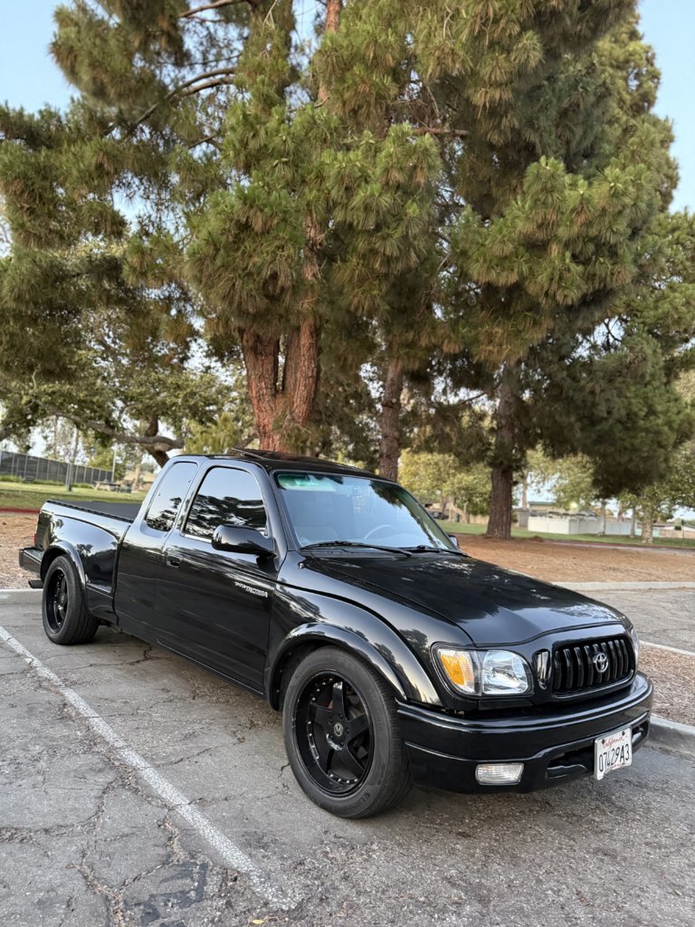

    oem pro grill 17” pro rep wheels Fox dsc shocks
    235/50/18
