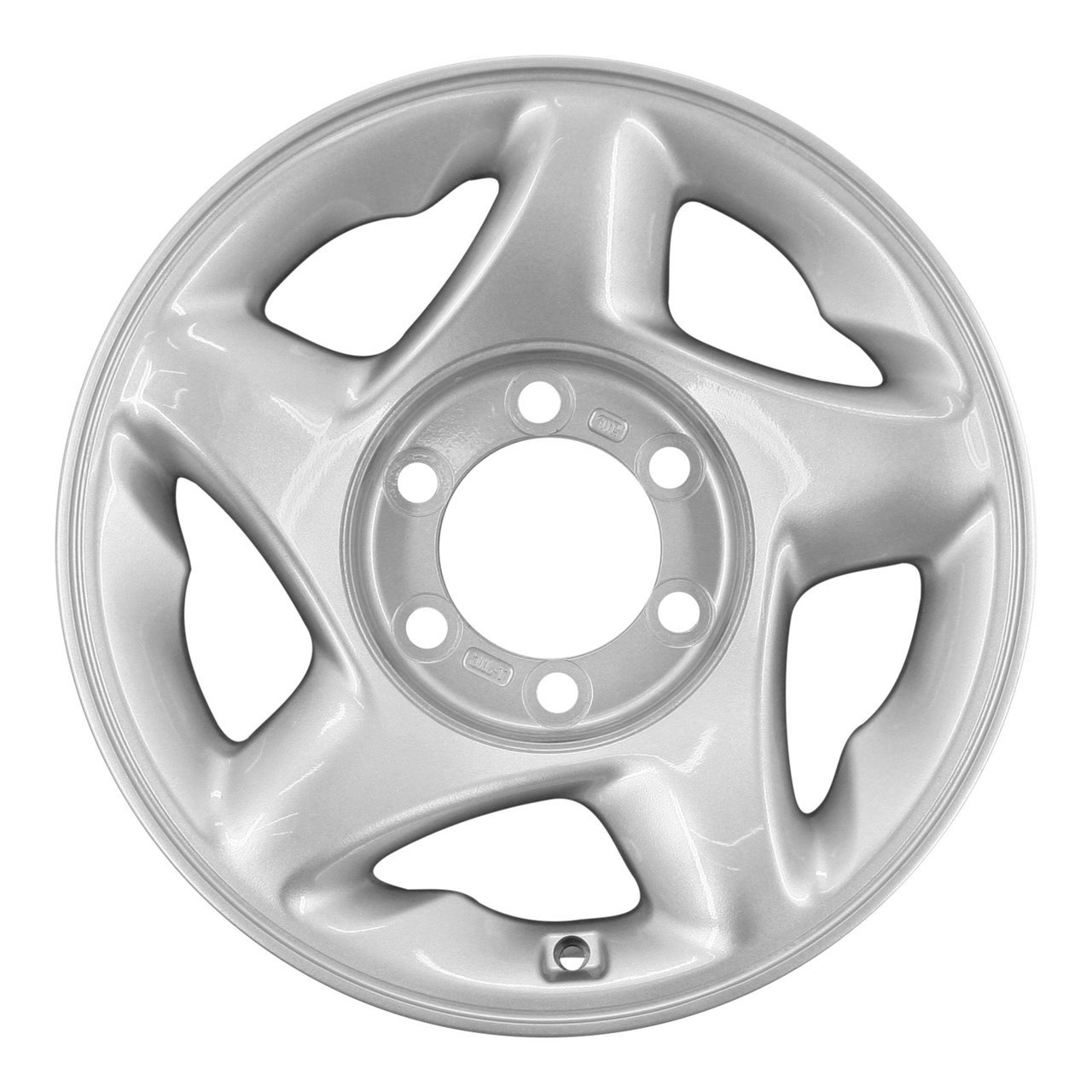

    Still unsure after reading every thread I could find on it: does anyone know if OEM aluminum 16x7 "swirled 5 star" wheels on an '02 Tacoma 4x4--part #s 426110C020 & 426110C03)--will clear Tundra 231mm calipers part # 13WL without spacers? [​IMG]

    These were standard on Tundras as well.
    This is the other type of 16" wheel that came with the "OffRoad" version (this is a 2006)

    Same wheels on my truck and they clear.

    Can confirm. Those are the wheels on my father's 2002 Tundra. 16x7.
