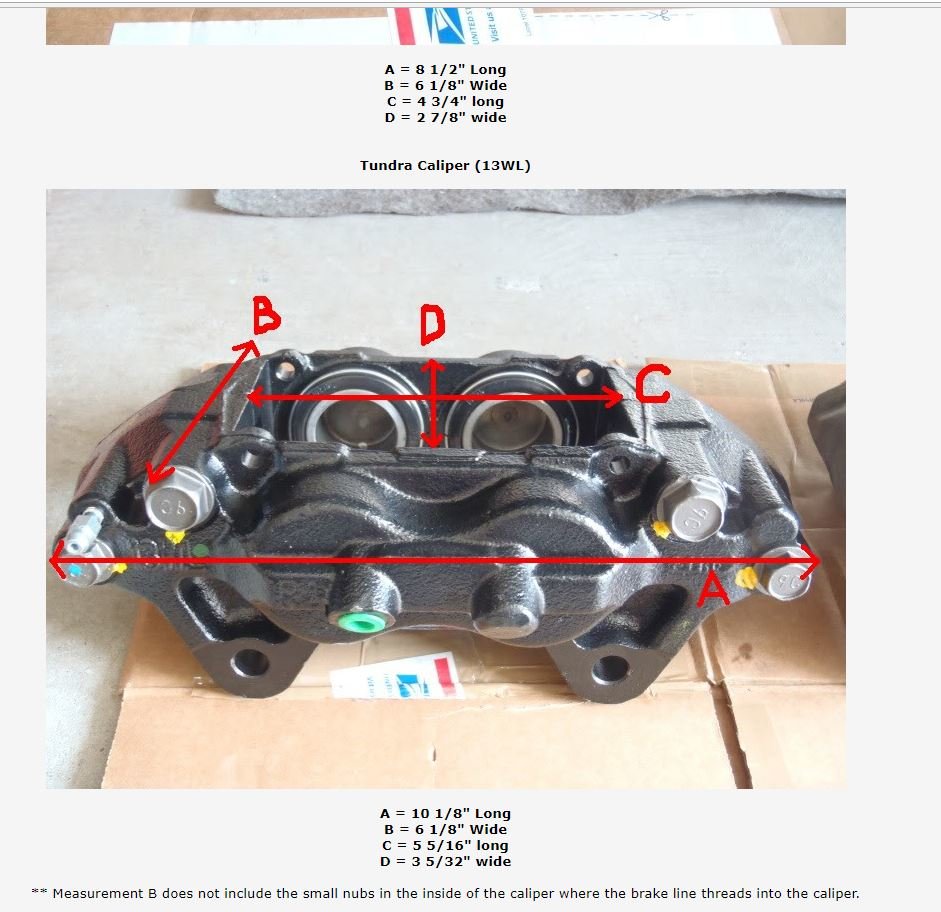

    Alright, I think I figured it out, not that it matters, but to patch the disturbance in the force.
    231mm = 9.09 inches.
    199mm = 7.83 inches
    Note that they are not mm^2 which would be a measurement of area. They are definitely not rotor diameters, that would be tiny, they are definitely not rotor radii, those would be huge.
    So, from this diagram and associated measurements, I deduce that these are the measurements of the center of the outermost bolt to the center of the outermost bolt for each caliper assembly(measurement "A" in the diagram minus the bolt flange diameter).
    I don't have either one handy to measure, but I'd bet a beer that is what it is.
    /end useless info that my ocd brain couldn't let go.
    Cheers.
