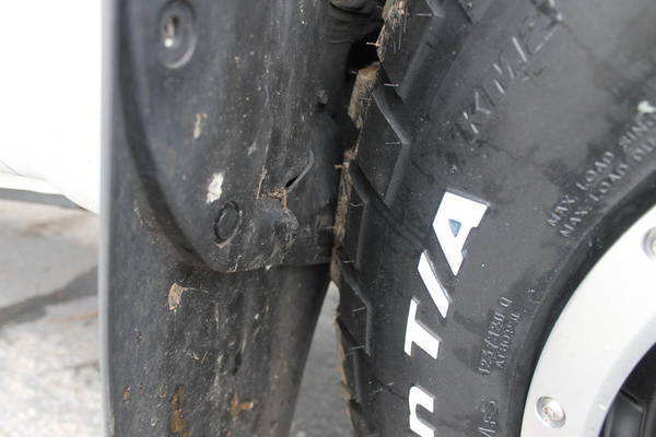

    The right front tire rubs the mud flap when making a right turn. It happens between the start of the turn and full lock. There's a sweet spot before full steering lock to the right where the tire rubs the mud flap.

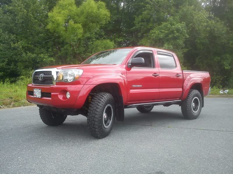

    Looks great! If you wheel it you will probably have some rubbing in the rear. Mine just catch the inside top of the wheel well when really flexed up in the back. I had no issues up front after I lost the mud flaps and reformed some plastic with a heat gun, even off road.
    Here's mine, I do have a 3" lift though so my experience may differ slightly from yours.
    465653_3683997853772_1089885207_3369168__7db59ddcfb5bced4ab9e5cc2f6c30e7fdb7097d0.jpg

    That looks great Fiveology! I didn't even think to reshape the plastic it's hitting with heat. Couldn't keep the mudflaps huh? That's the only significant rubbing I have. I'm going to try and trim where it hits to keep them.

    255/85/16 BFG KM2s on 1st Gen TRDs (4.5"BS) originaly 3" OME lift with 885s & Dakars with mud flaps (-4" before lift & tires).
    Now at 2 3/4" after adding sliders, a full set of skids & 1/4" top plate spacers.
    The only place I've ever rubbed was the bump on the mud flaps (3 times so far) if I bounce the front too hard at full lock.
