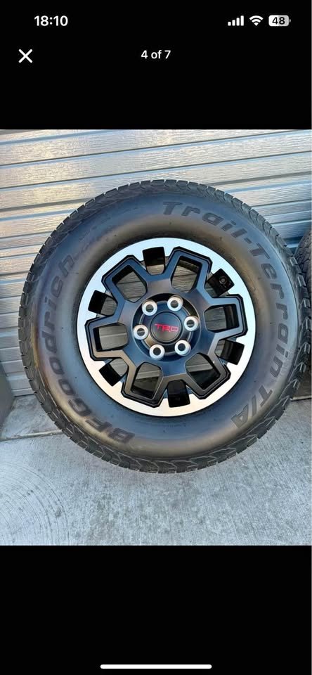

    Will these 265/70/17 BFG trail terrain tires fit on my Stock 2020 TRD Off-Road? 17-inch rims. I believe these are off the 2024 Tacoma. Id rather not make any modifications/install of lift kit. Thanks!

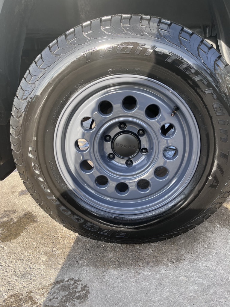

    I put that exact tire on my 2020 Sport. No rub. Although that was a year ago, and I believe the trail terrains had an update for 2024. I put them on Nomad Convoys not that the should change anything.

    The tire should fit. The rims might not. The new Tacoma chassis pushes the wheel mount surfaces out quite a bit making the rims a high positive offset. I believe it is around +54mm. Your Tacoma is +30mm. With the the difference the tires would be rubbing hard on springs, upper control arms wheel wells.

    What Dave said. Plus those "Trail Terrain", dont look too trail rated. Looks like a street tire.

    Bummer that the rims on the gen 4's are completely different than the gen 3's. Thank you everyone for the info.
