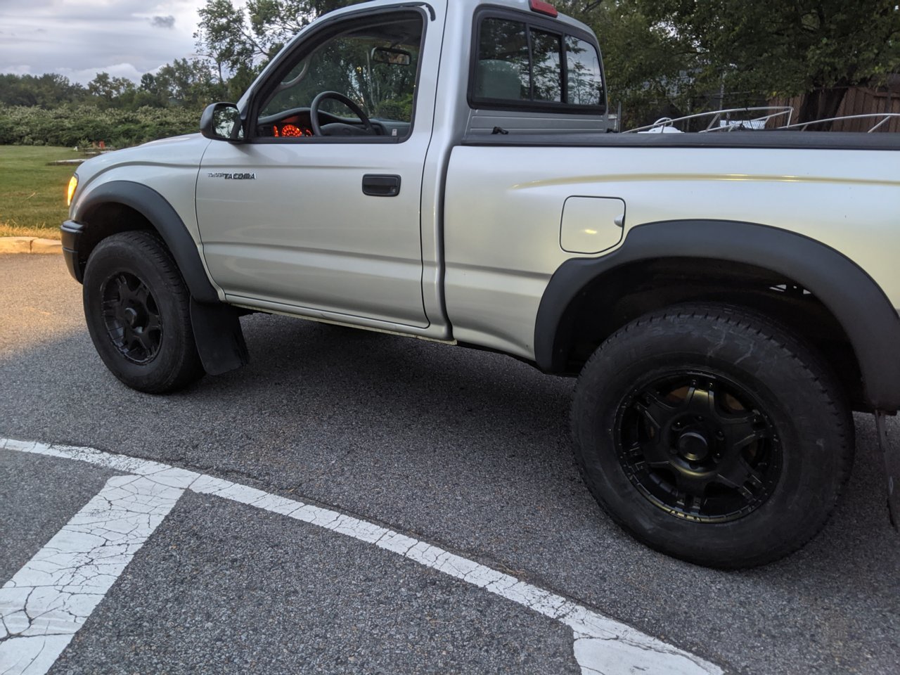

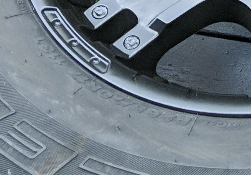

    Yes...they fit fine on mine with 5100's lowest, no lift setting. IMG_20210908_160443_01~3.jpgPXL_20210916_232056968.NIGHT.jpg
